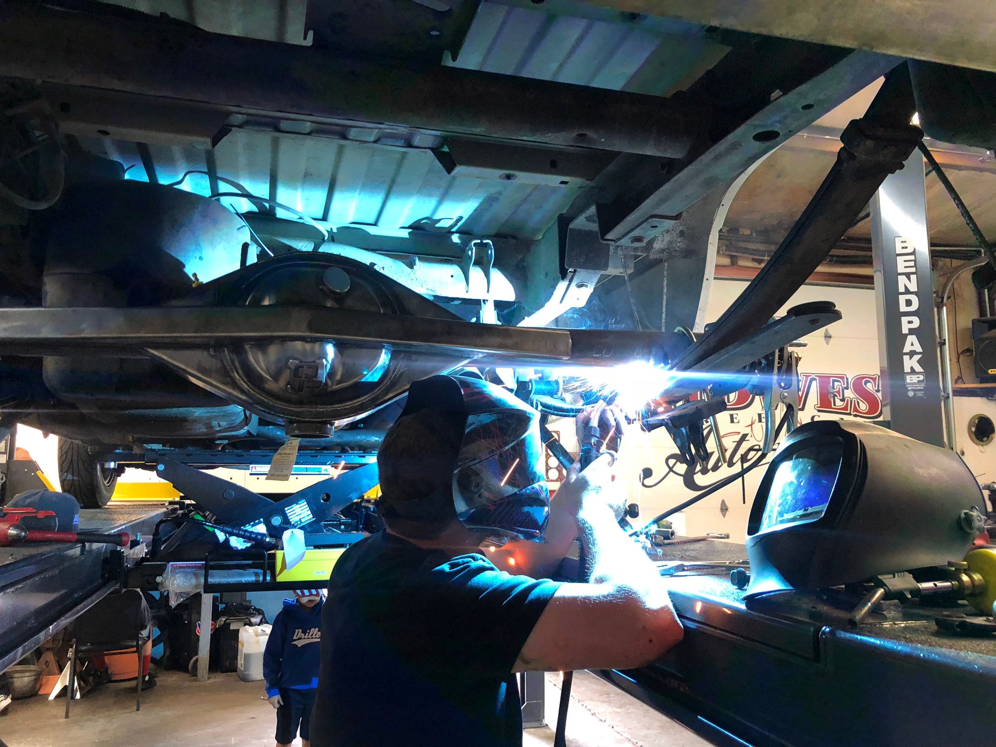

Made some time to get the Quick Performace 9” in a couple weeks ago. Dirt track racer 81 once again to the rescue. 10+ years of bailing me out of tight spots lol
Setup is a Quick Performace 9” narrowed .5” per side from a factor 10bolt
Strange aluminum center section with spool and 4.30 gears
40 spline axles
Wilwood drag brakes drilled for factory 6 lug pattern (still had to grind these a little for my bogarts to fit)
