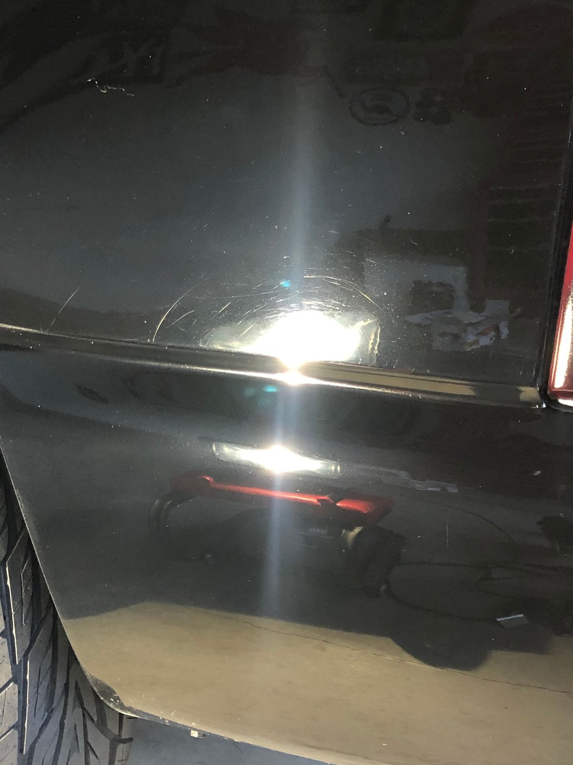

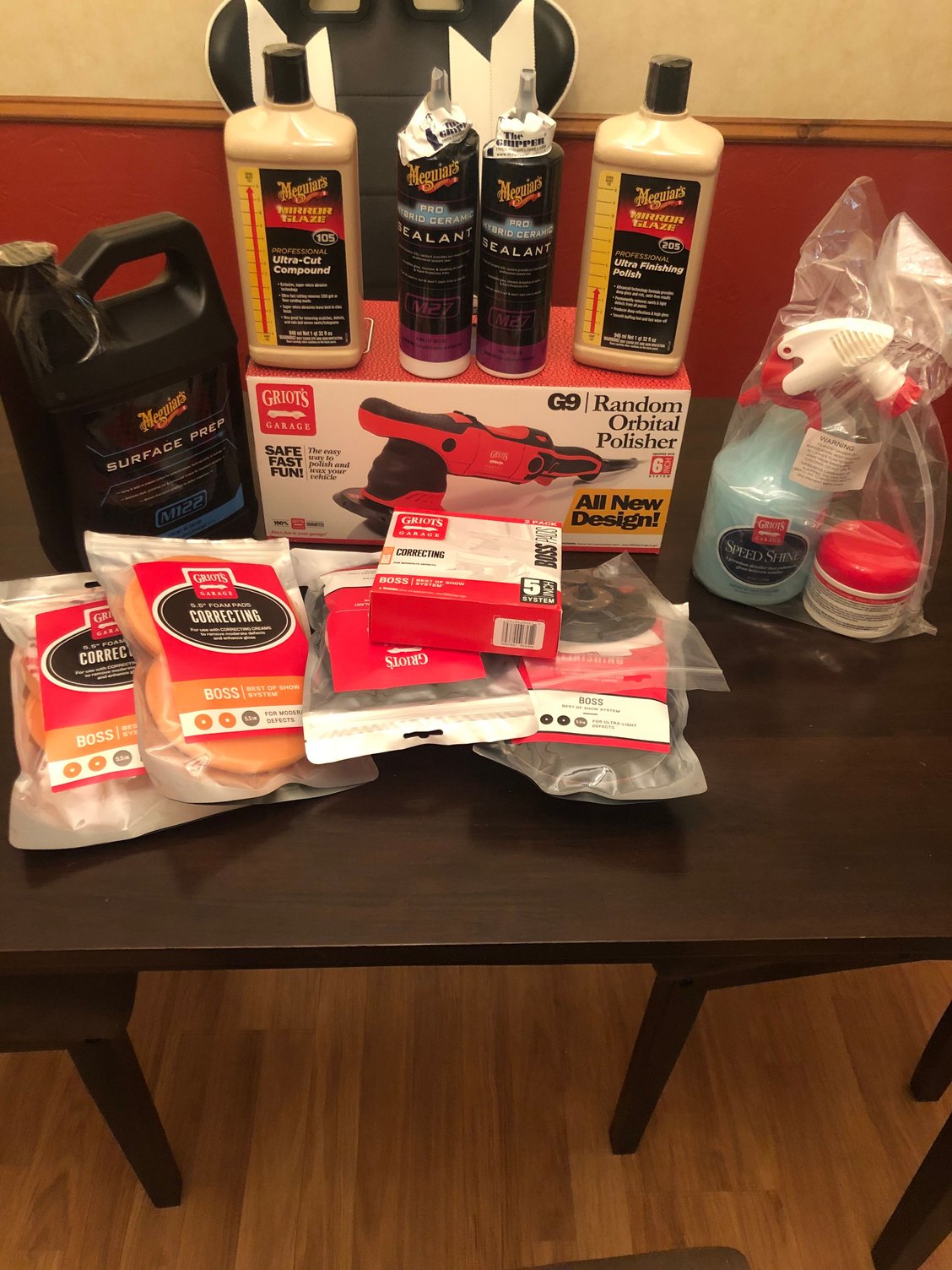

Started paint correction last weekend on my single cab and z71. Not looking forward to my four door z71 but it will be worth it. It’s crazy how much defects it takes out, about halfway through my single cab. Below is what I used.

**** that is looking good man!
Was looking at doing some paint correction until I can afford to fix the paint on the top of the truck and really redo everything

Thanks man, yea I’m in the same boat. Just prolonging the paint before I repaint awhile from now. I didn’t know anything about it so spent some time on YouTube. Meguiars is solid for the compounds but the buffer was double the price. So I got all my hardware and pads from griots.

Nice work! Can't go wrong with Meguiar's.
I've found the 105 to be difficult at best to work with in some situations, hot/humid and tends to dust up like crazy. It'll work harden fast and be dang near impossible to get off. If you run into any of these conditions you might try the Meg's 101 pro foam cut or the 100 pro speed compound. In my experience, they both cut like 105 but have better working times, less dust, and easier to work with in less than ideal weather conditions.

I would agree 100 percent. I would like to do big areas but by the time first pass is done second pass it’s dry. And yea real hard to wipe off. I let the 205 then sealant usually take it off. But will get something else once I use this up. May try your suggestions for a replacement!

Try the Griots Correcting Cream in place of M105 and Griots "Perfecting Cream" in place of M205. Their "BOSS" system of polishes are awesome. They are 100% dustless, have a long working time and easy to remove. I've tried many systems and in the last two years since I found the BOSS... all my other compound/polishes just sit on the detail cart. When you need a lite maintenance polish in six months or so try the Perfecting Cream...
I'm sure your Meguiars twins (M105/M205) will get lonely too

The W, you could always try the 205 on your most aggressive pad and see if that gives you the results you want without having to mess with the extra work of the 105.
RedXray, you using the whole BOSS system, pads/polisher as well? I have a Flex 3401 and bunch of Lake Country force hybrid pads...not trying to start all over there. I guess at some point I'll pick up some BOSS creams and give them a go.
