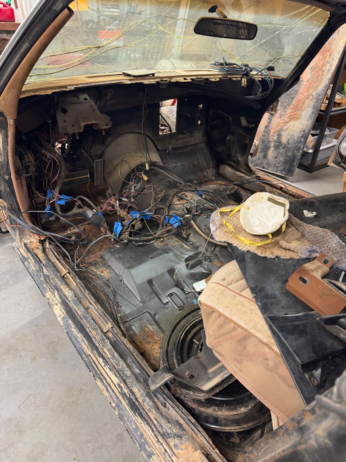

Ya pretty much. I lifted up the carpet and took some of the plastic under the place where the pedal would hit out. I still have to really jam it down hard but it hits 100 percent in vcm. I need to do a wide open pull and get that tune taken care of then it will be complete. Before I do that I think I need to recalibrate tps and verify my idle values.
i just got distracted here recently with my TA.
i know it’s not a truck but here are some pics. Got everything taken apart except for front clip. Once I have that then I will separate the body from frame.

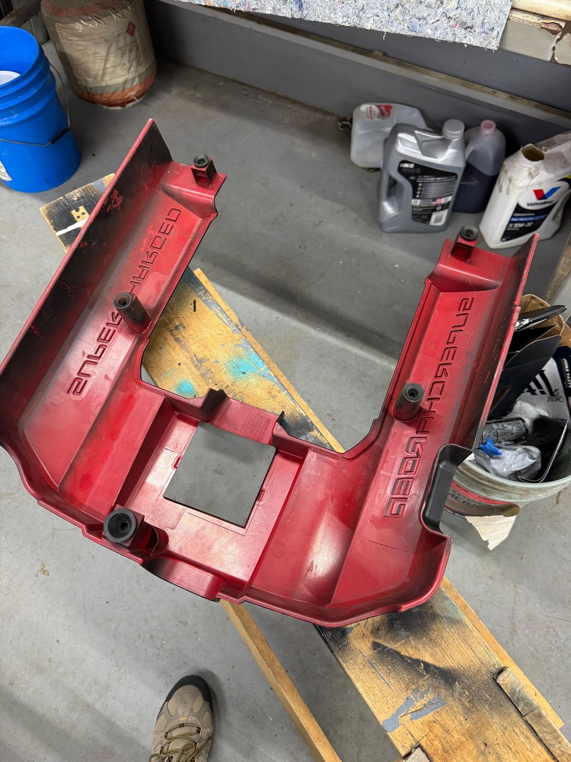

After a real long time looking finally came
across a Lsa engine cover. It’s painted black, you can tell it was just rattle can sprayed. How can I strip this off without possibly messing up the underside that is red with white lettering.

You could blast it all off and repaint the raised letters. I think walnut media or volcanic ash would do it without pitting the plastic too bad. A light scuff with a scotch brite pad should fix the finish up enough to look good.

Well if I repaint the letters, then I will go as far as painting it black with white letters. Since everything is black. I thought maybe simple approach right now I could put some paint stripper on it and wipe off that black. Leaving the stock red and white.
