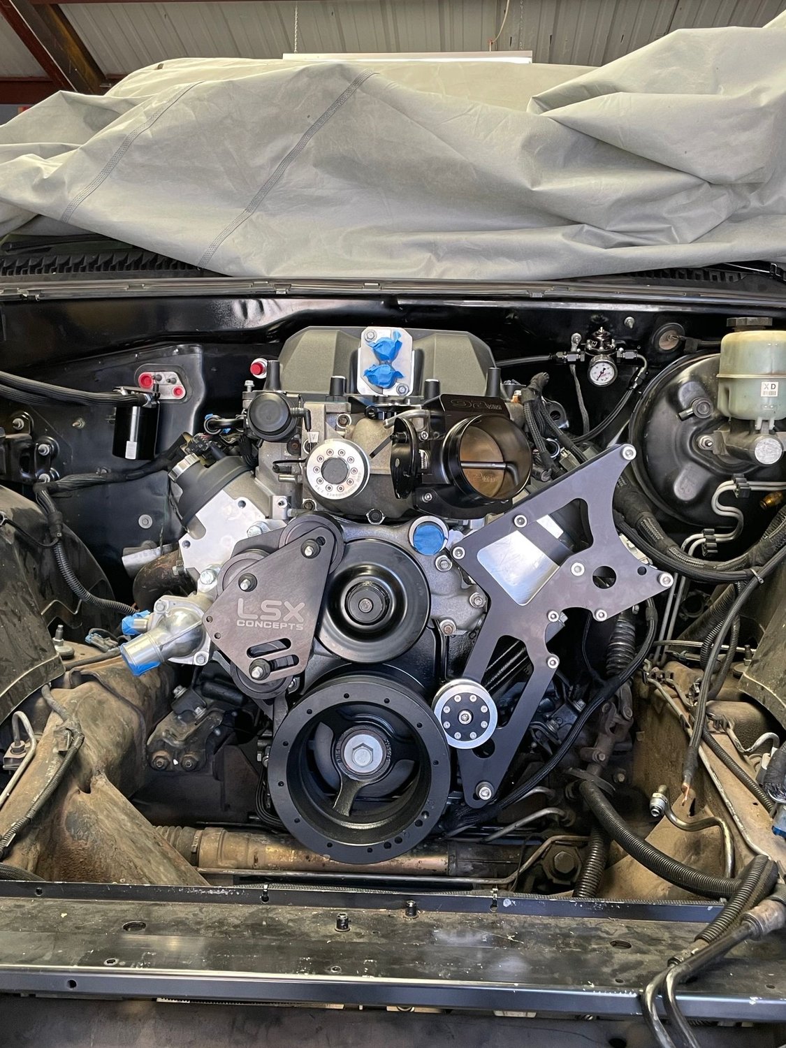

Got out and did some work on the truck. I am so close to getting it done, hoping for a spring drive. But had to pull the wires out of the loom for the map and reroute the wires. Snipped of the end and soldered it to the 3bar map sensor on the lid. Then unpacked all my front drive accessories, brackets, and pulleys. Got them mocked up and pleased with how they look. Will need to do some measuring on the blower pulleys to make sure they are good. It came with pulley to replace the alternator stock and also tensioner so need to get them off and put the new ones on. Got ptfe lines built from the rail to the regulator. Once the front drive stuff is done, I will start with HX and mounting pump then put front end on. Need to put in new fuel pump and run my ptfe lines. I guess I still have a lot to do now that I think about it.
Old Feb 20, 2024 | 12:54 PM
  #306
silentbravo's Avatar
5 Year Member
Joined: Mar 2018
Posts: 430
Likes: 128
The list does get long when you really think about it.

Old Feb 20, 2024 | 04:39 PM
  #308
The_W's Avatar
Joined: Dec 2014
Posts: 590
Likes: 118
From: Amarillo, TX
You are correct, I am trying to avoid being picky. I ran into stuff I would like to do along the way but its not needed in order to get the truck running.
