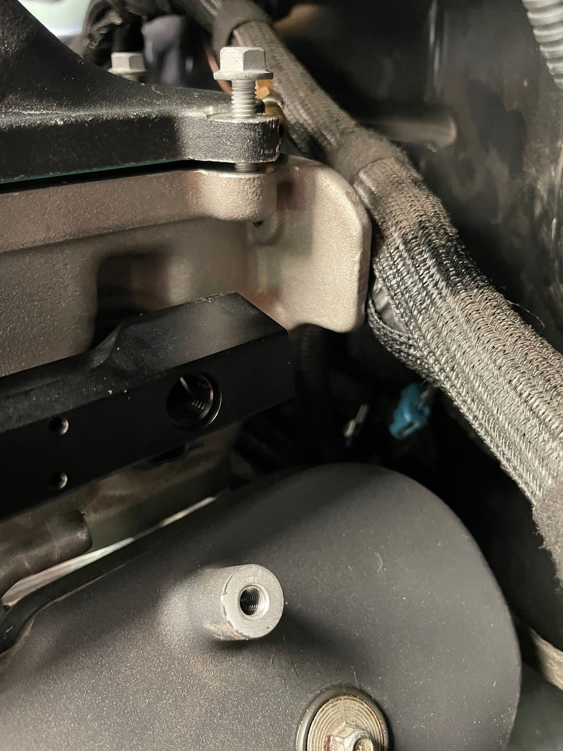

Got a lot done today. Blower is installed, I only hand tightened the lid because I want to check for leaks to the brick once I get my cooling plumbed up. Finished some wiring cleanup, split my IAT off from the maf to the lid.
Was going to put my fuel rails on but ran into an issue. The rails are too close to the back of the blower that I can’t get my fittings on. Going to have to order some 90’s. So since that was a bust I put on water pump and coolant tank.

Awesome. Maybe next year I can hang a blower on top of my rig too lol
Good to see the LSA has lots of room up top below the wiper cowling.

Thank you, hopefully you can. Heard their fun but will see eventually how it is with my build.
Lot of room up top, stock hood will work. I have a cowl so was not too worried.
