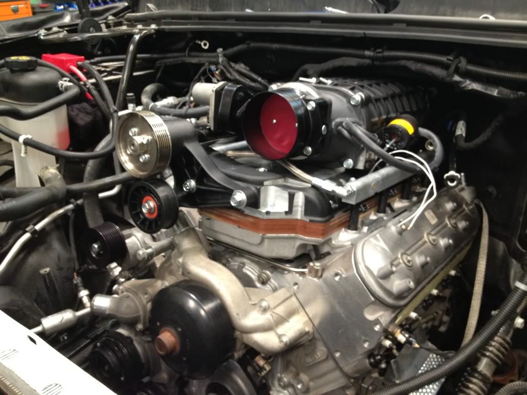

here it is right of the showroom floor
2012 RCSB 4wd
http://a5.sphotos.ak.fbcdn.net/hphot...71837768_n.jpg
lowered 2/4, going more soon
http://i969.photobucket.com/albums/a...d680/photo.jpg

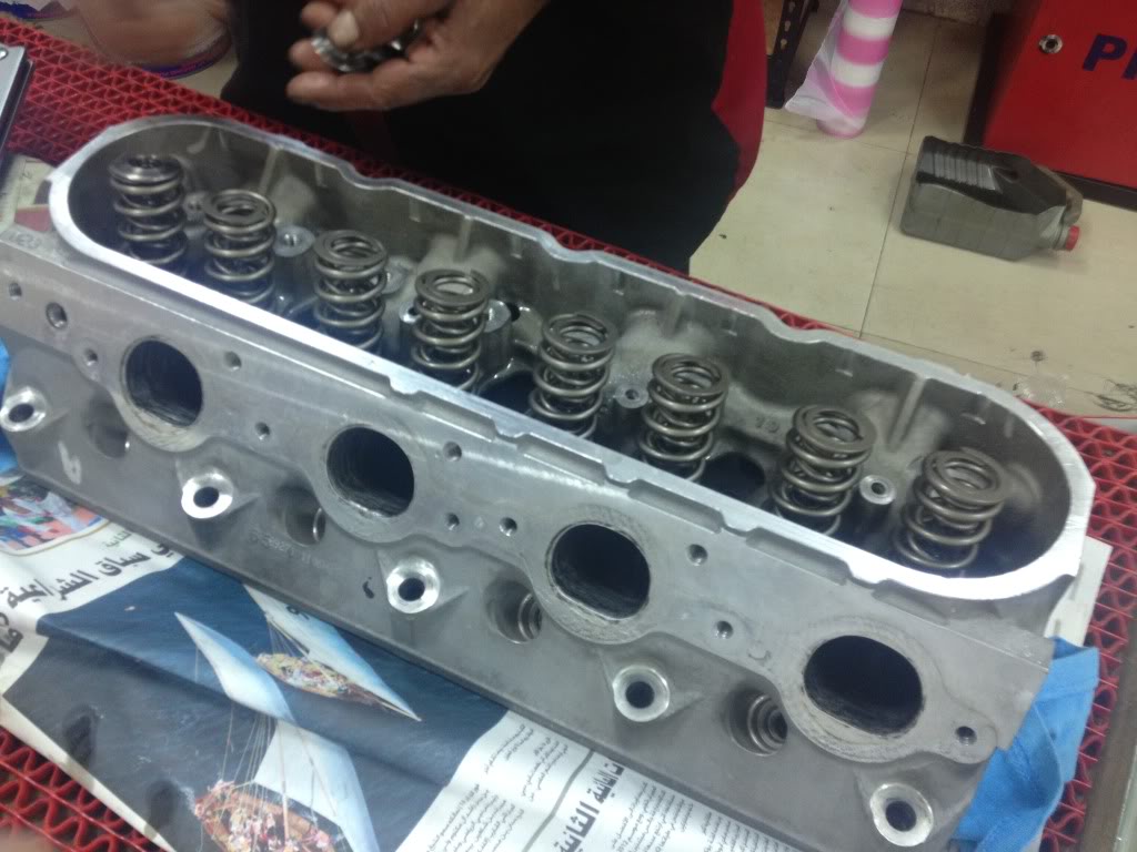

6.2 engine of of my 09 denali that i had,
Tvs2300 + supersub's spacer
Diamond Pistons
Callies Rods
Livernois L92 heads
Boost cam
102 TPIS TB
ATI 8 rib
3600 circle D triple disk
9.3:1 compression ill run it at 12-13 psi at first, then well see what happens.. some pics

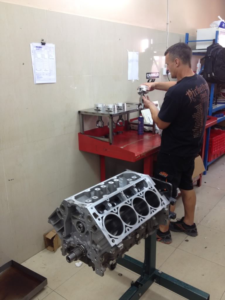

Attachment 133465

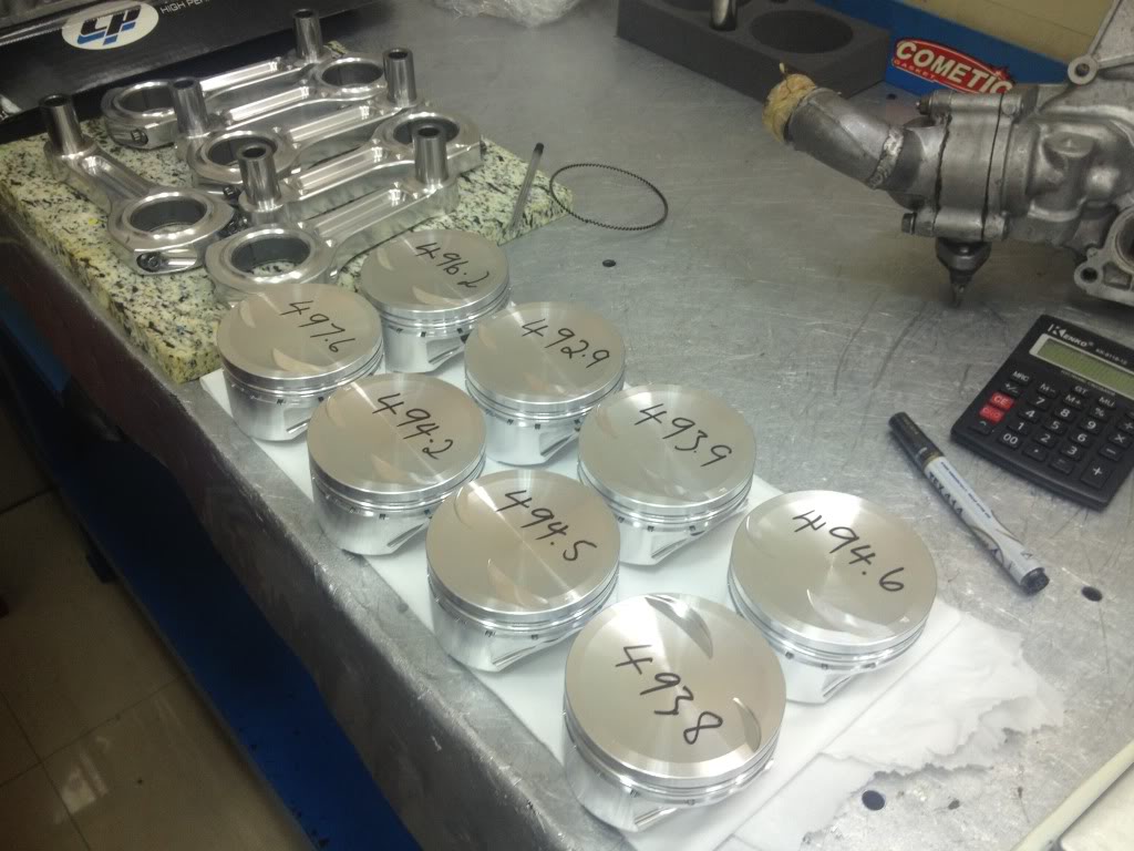

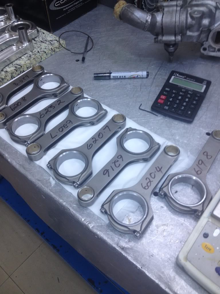

pistons and rods all weighed the same in the end
Attachment 133466
Attachment 133467
Attachment 133468
Attachment 133469

thats doing it right ;) nothing like weight matching and punching in the figures!! awesome build should perform well in the end!!
