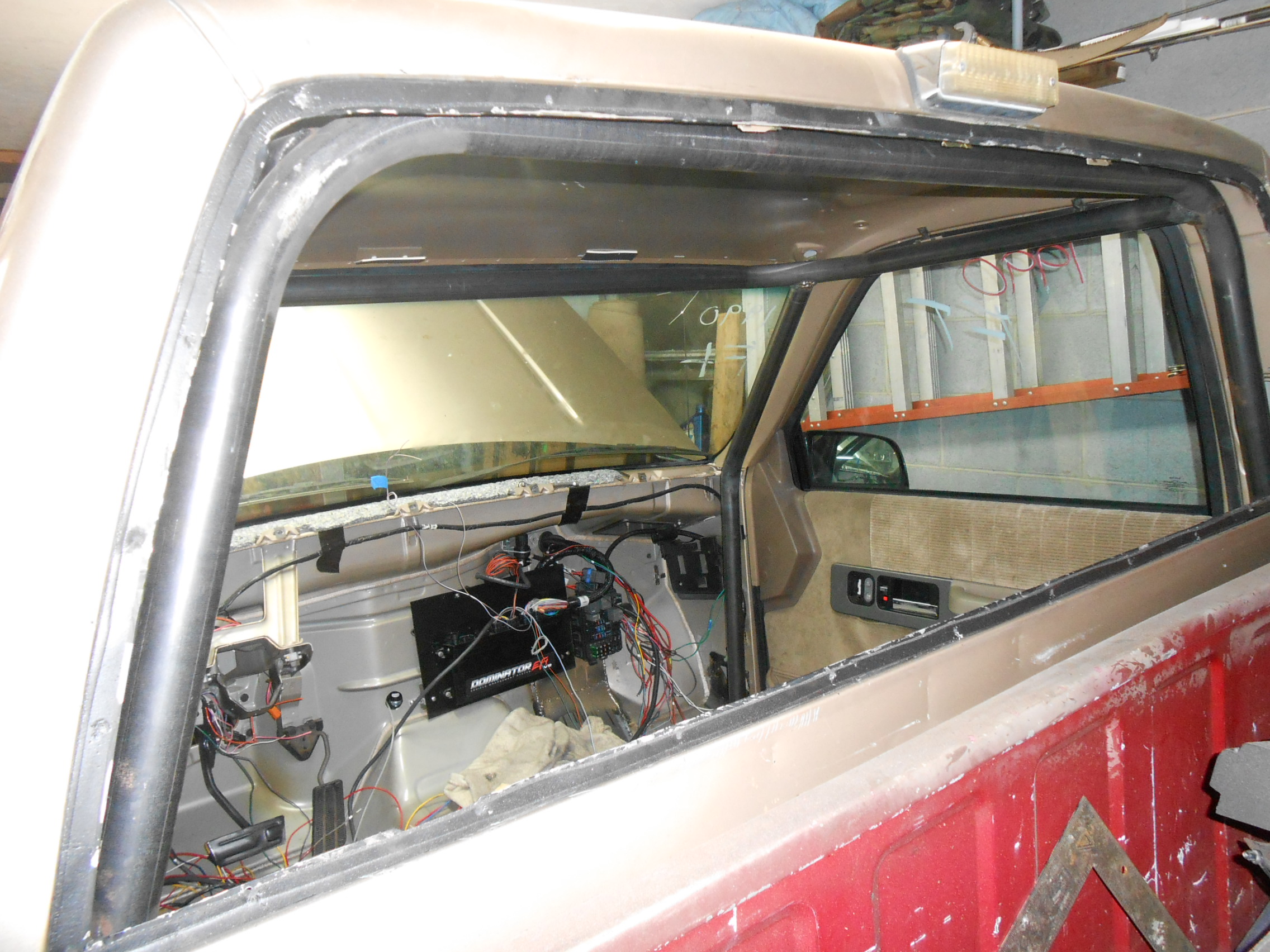

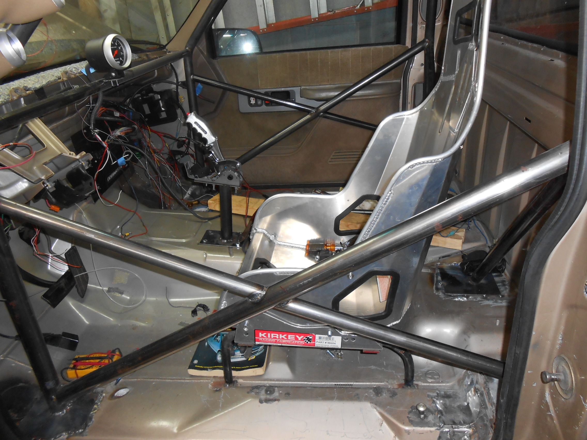

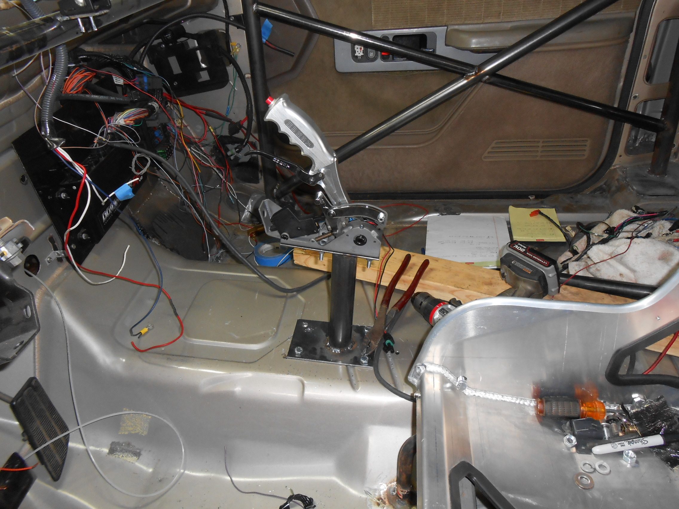

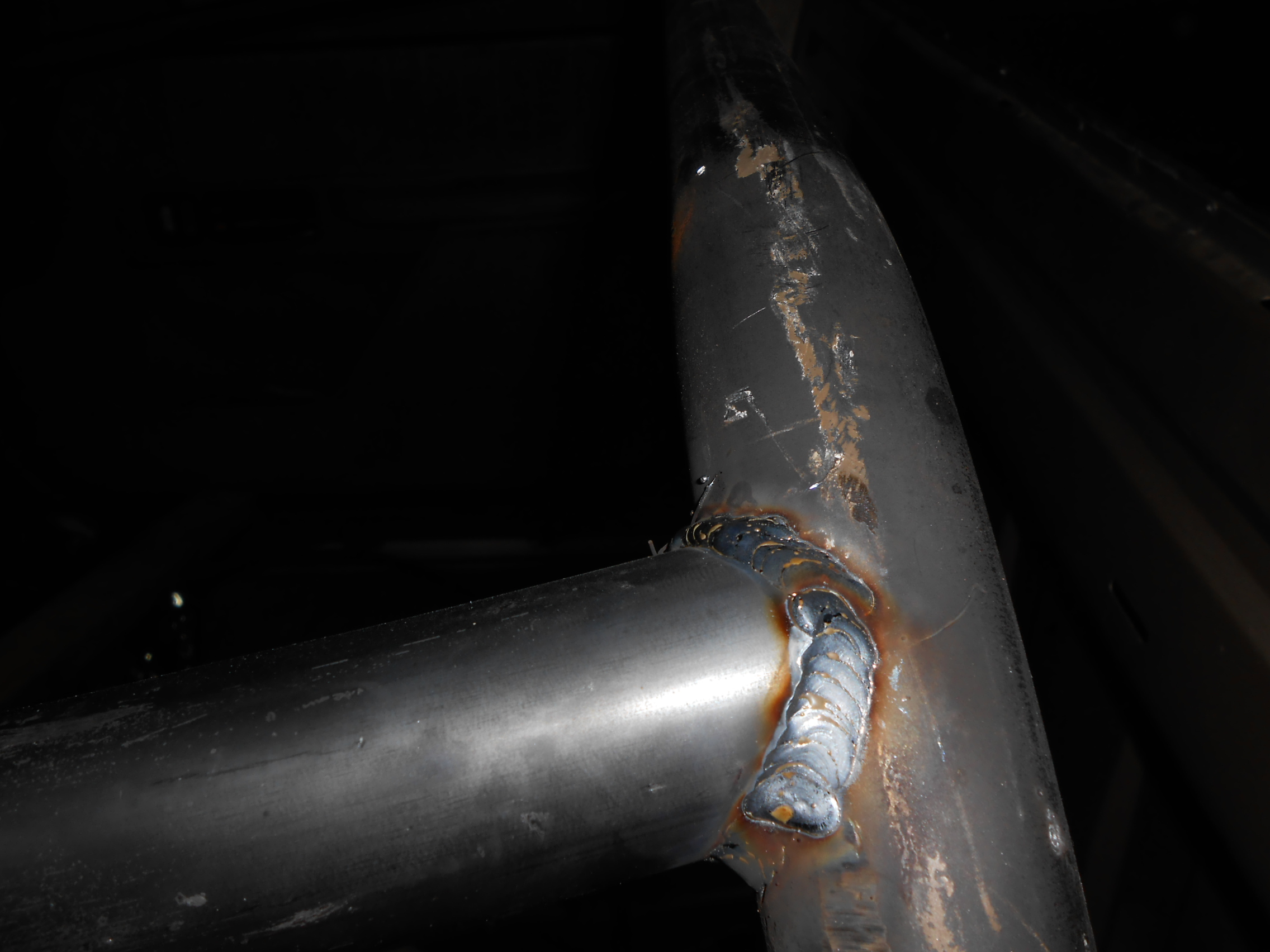

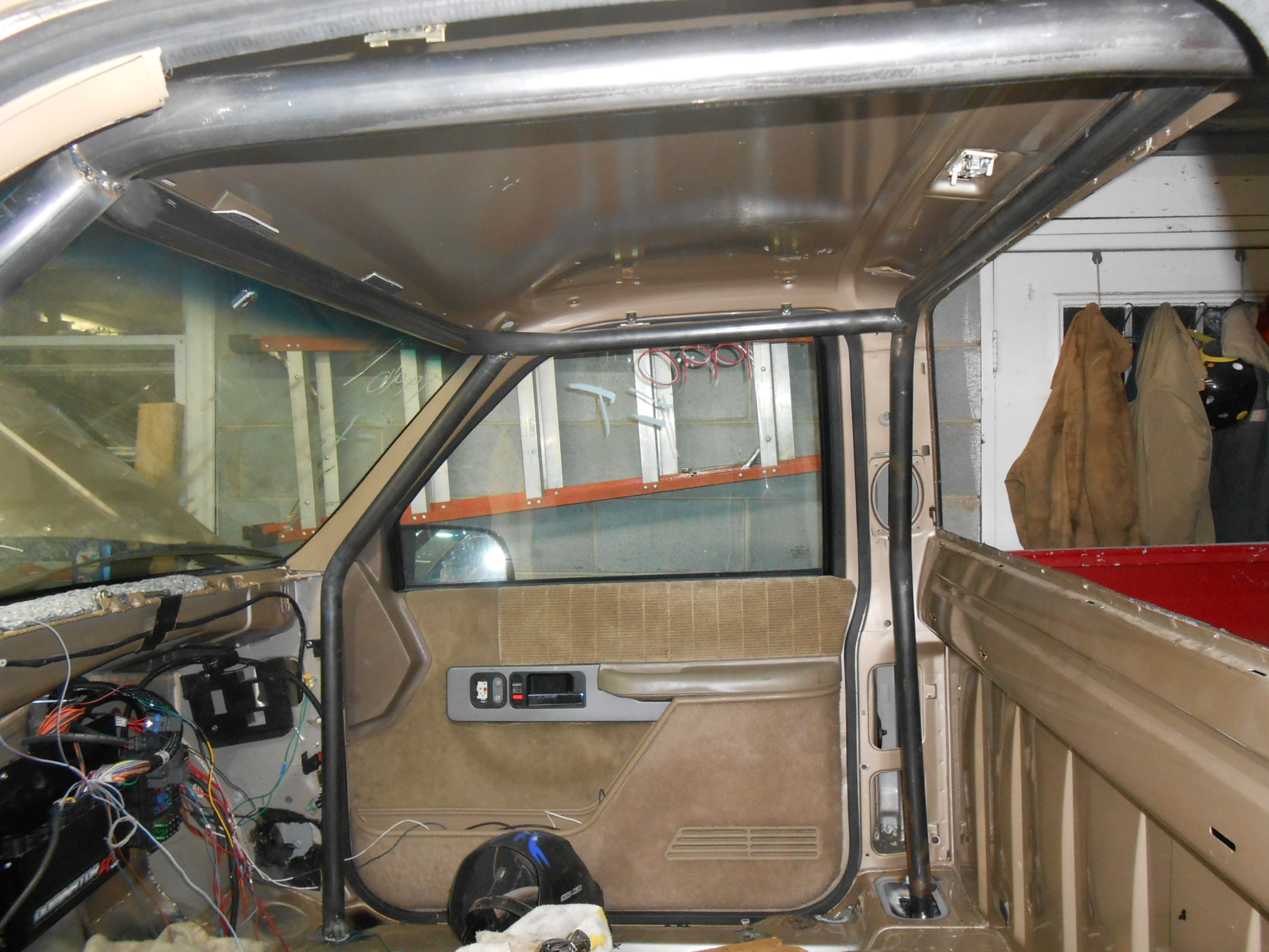

cage work
Attached Thumbnails 1990 c1500 s480 ladder bar cage and more-dscn0343.jpg   1990 c1500 s480 ladder bar cage and more-dscn0345.jpg   1990 c1500 s480 ladder bar cage and more-dscn0346.jpg   1990 c1500 s480 ladder bar cage and more-dscn0347.jpg   1990 c1500 s480 ladder bar cage and more-dscn0349.jpg

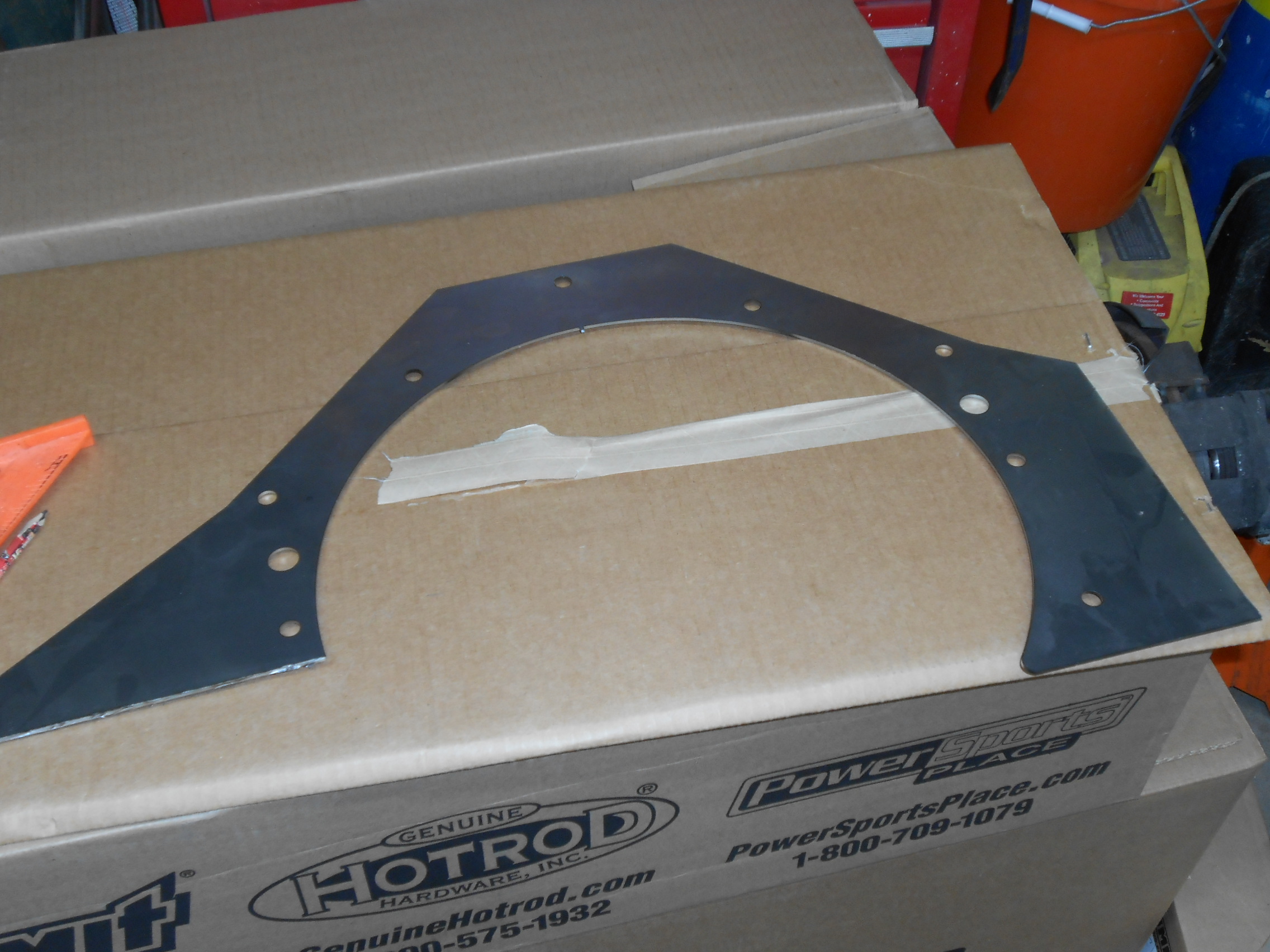

rossler turbo 400 with all the goodies including ultra bell. adding mid and front plate. also my brake kit came in from aerospace. it is some very light and awesome parts.

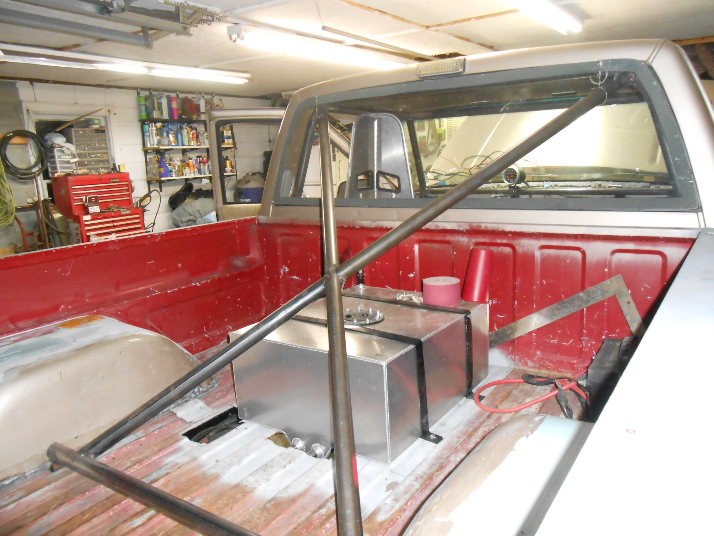

Looks cool but that is a very shitty place for a fuel cell. Major pain in the ***.
Old 11-01-2014, 09:18 AM
tempoffroad's Avatar
Join Date: Sep 2006
Location: Greensboro NC
Posts: 124
Received 0 Likes on 0 Posts
I agree about the fuel cell. It was mounted before I built the cage and just have not moved it. Ig does come out from the sides. I had it like that last year when I was still sort of using the bed to haul things.
