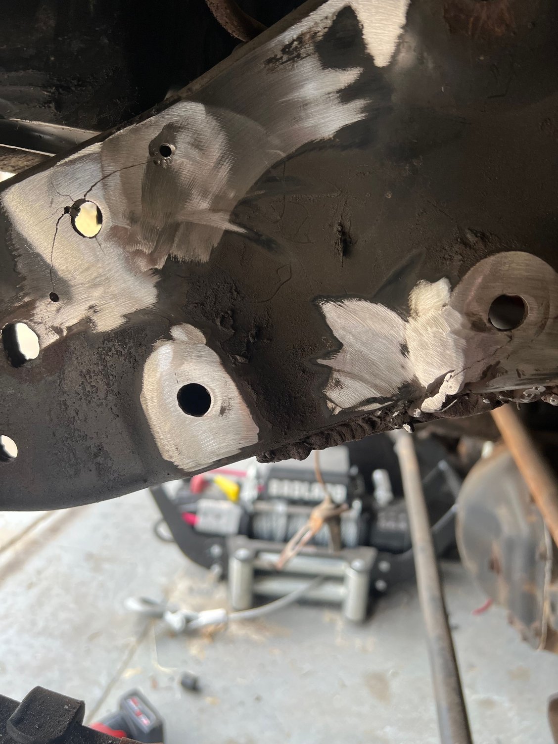

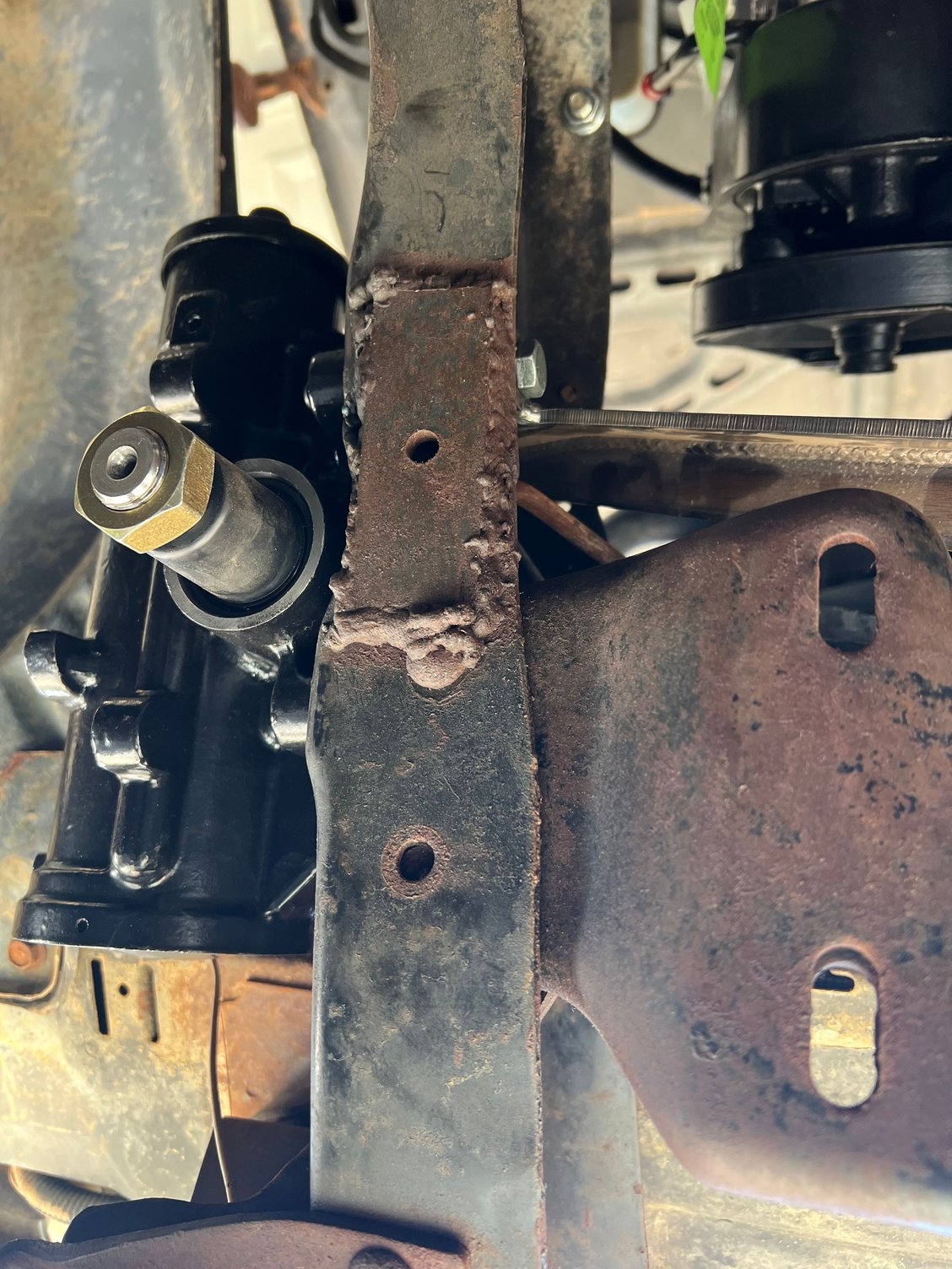

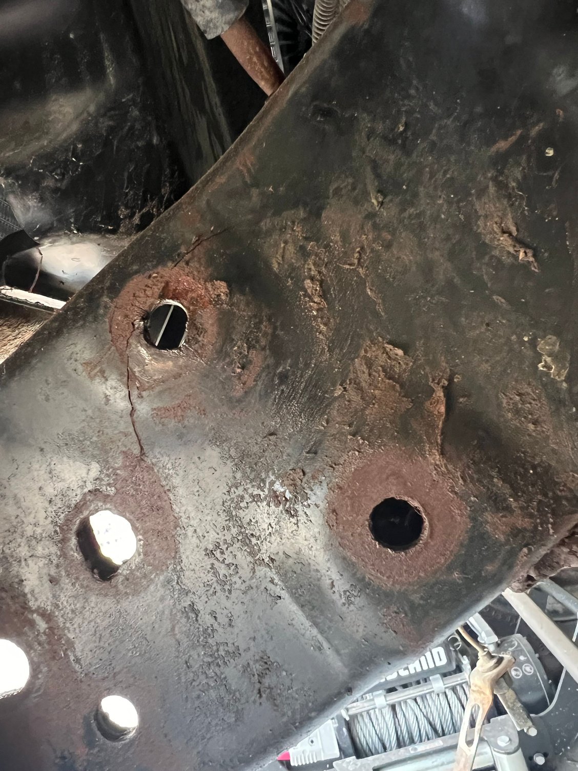

Went to swap to the 2wd steering box for the crossover steering and found a few cracks in the frame. Pretty common. I drilled them, ground them, and welded them.

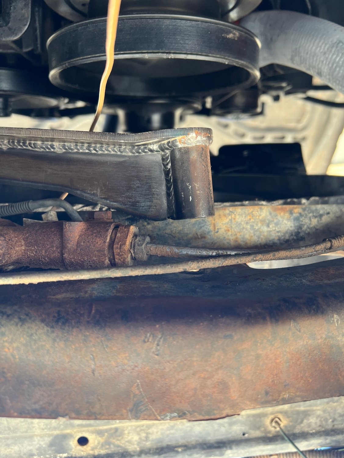

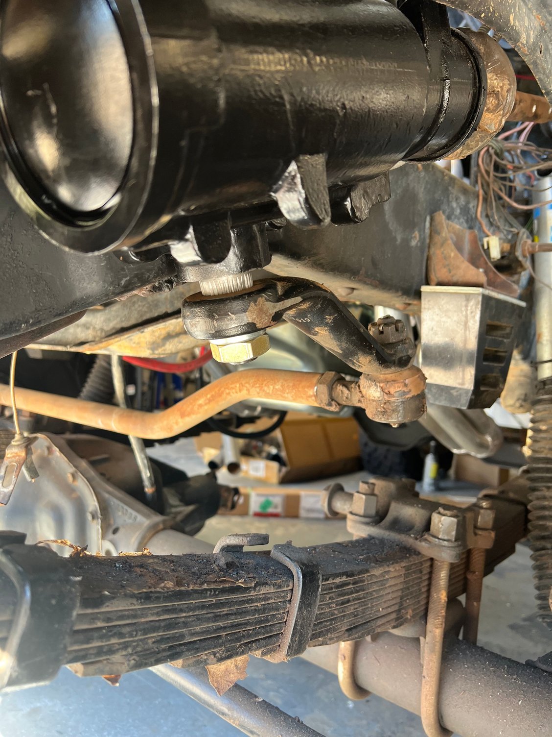

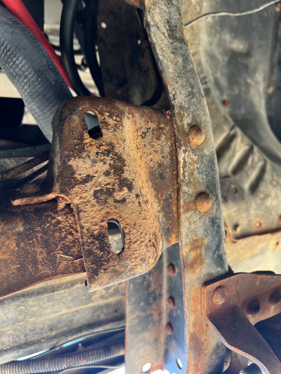

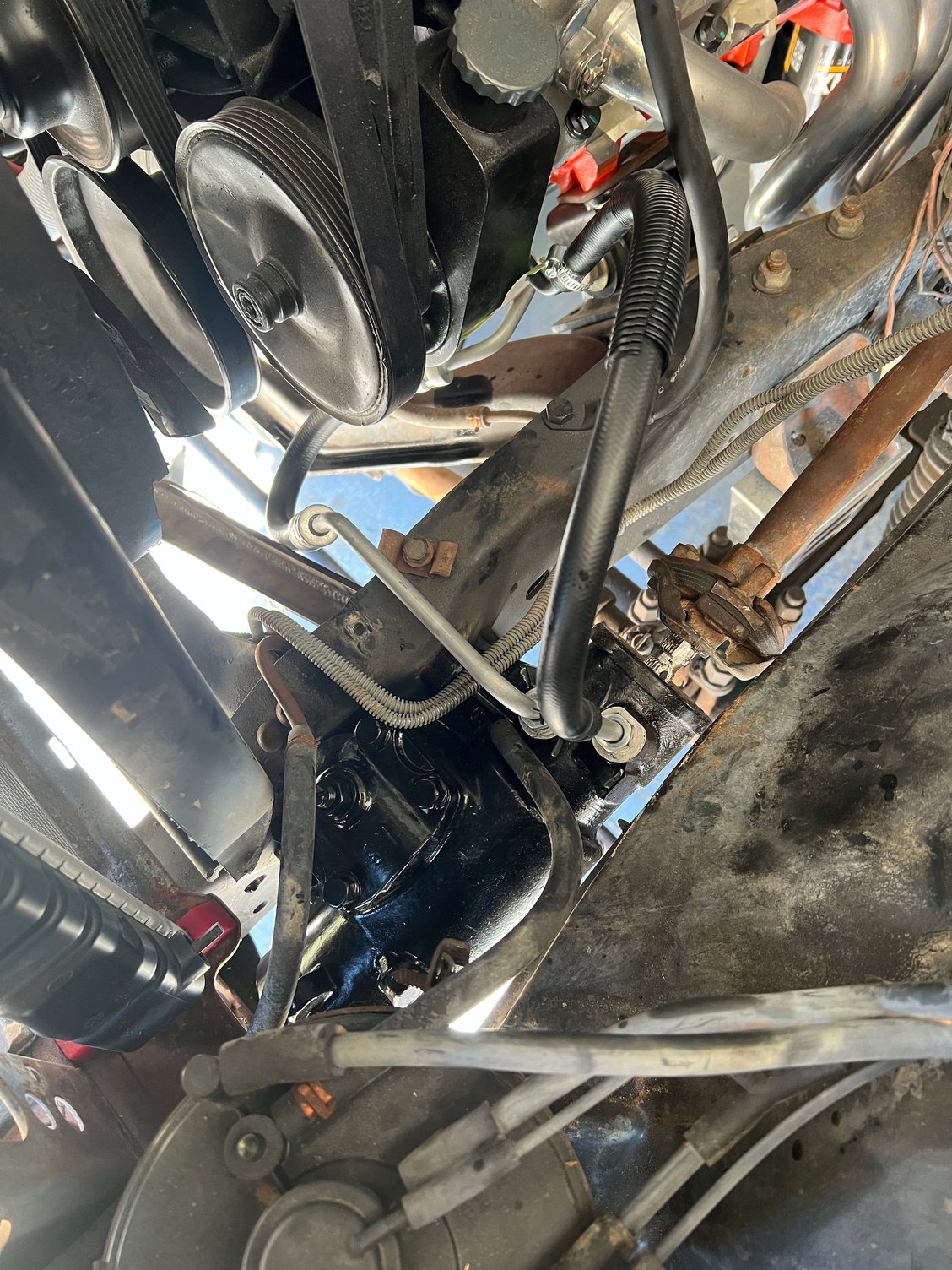

Spent two hours fighting the steering box and when I went to mount the brace, learned why. Looks like a rivet snapped on the frame and caused the front frame horn to be bent in. The front of the frame was torched off at some point. I’m now wondering if it hit something and one of the PO tried to hide it. You can see a plate booger welded on to the frame under the steering box. Other than that, got the box, lines, and axle connected. Wanted to run PCV, map, and coolant bypass but my temper was raging so I decided to call it quits. Maybe I’ll try again later.
