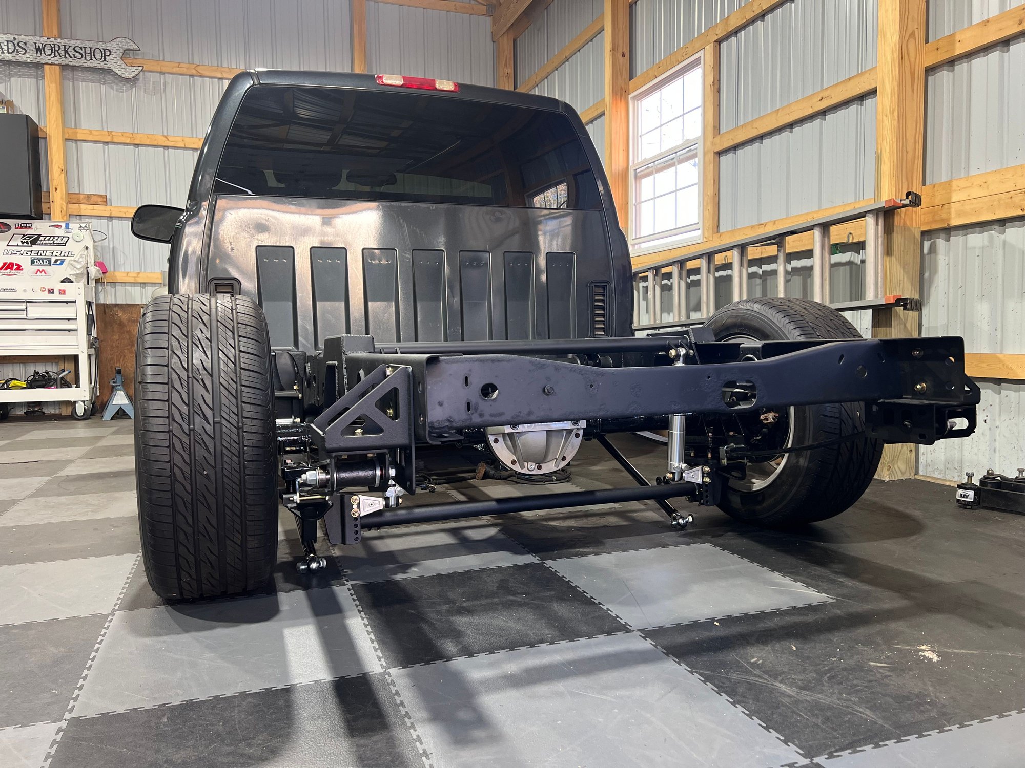

Back on the ground. Time to do hydroboost, line lock, and plumb a brake system

How does the rear feel when you do a bounce test?
Old Nov 3, 2024 | 02:54 PM
  #35
Terdstang's Avatar
Joined: Mar 2011
Posts: 37
Likes: 42
Good and smooth. Need to make something that connects the bottom bar to the rear so I can jack it up by the bar.

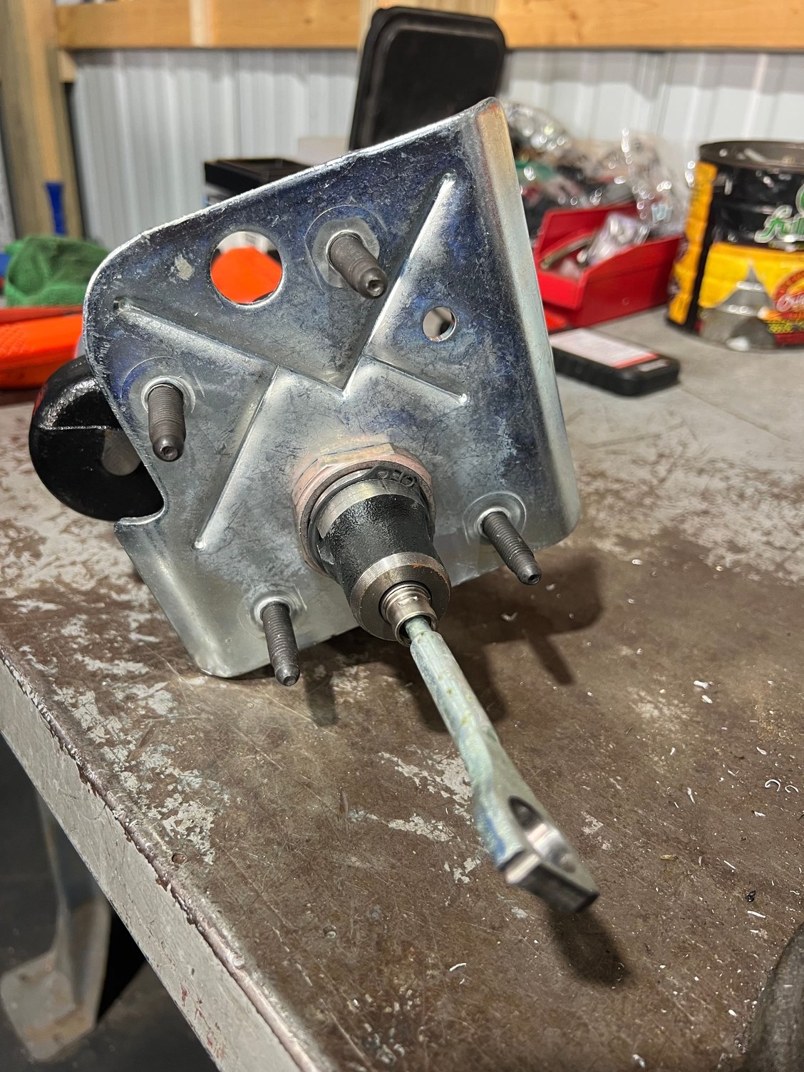

Ordered a hydroboost unit from a 04 2500 6.0

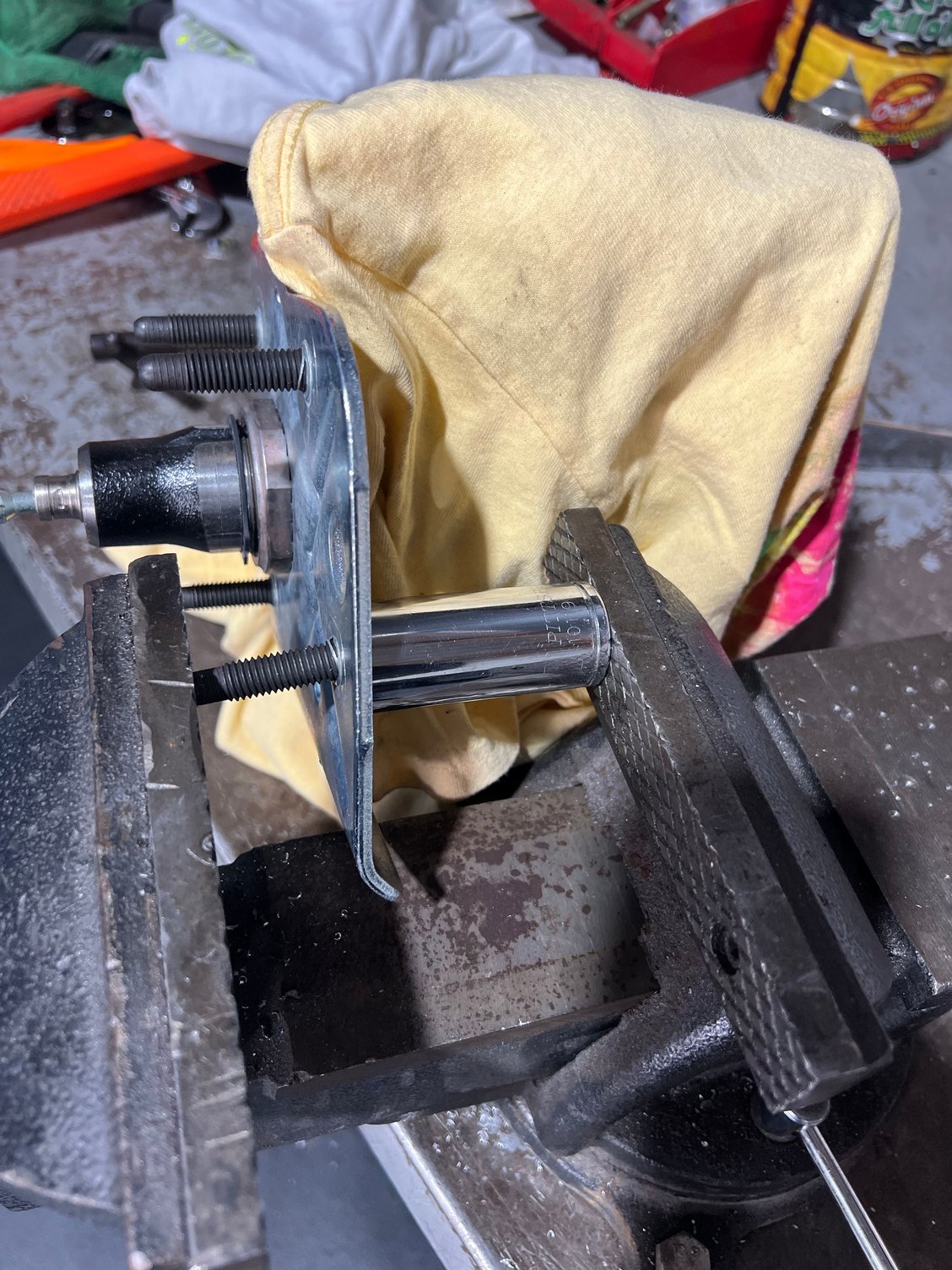

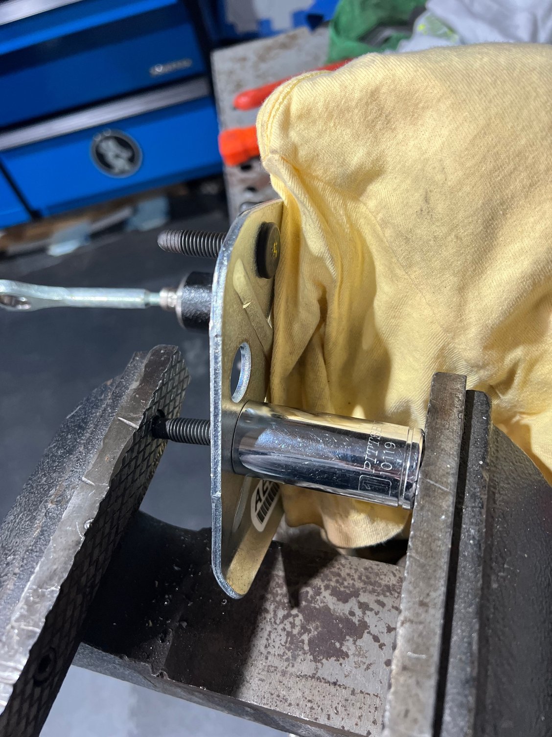

Pressing out one of the studs because it doesn’t match the holes in firewall.

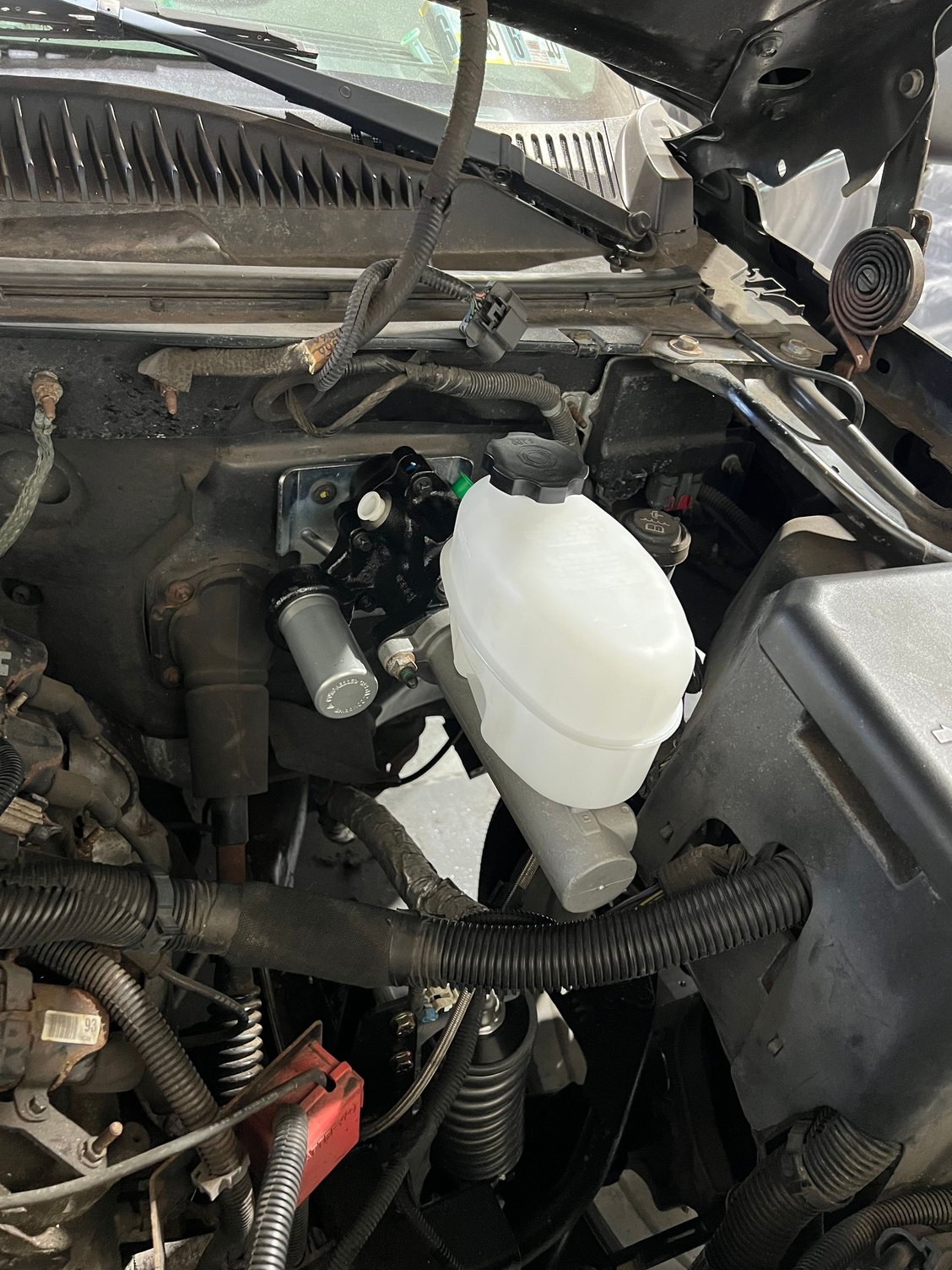

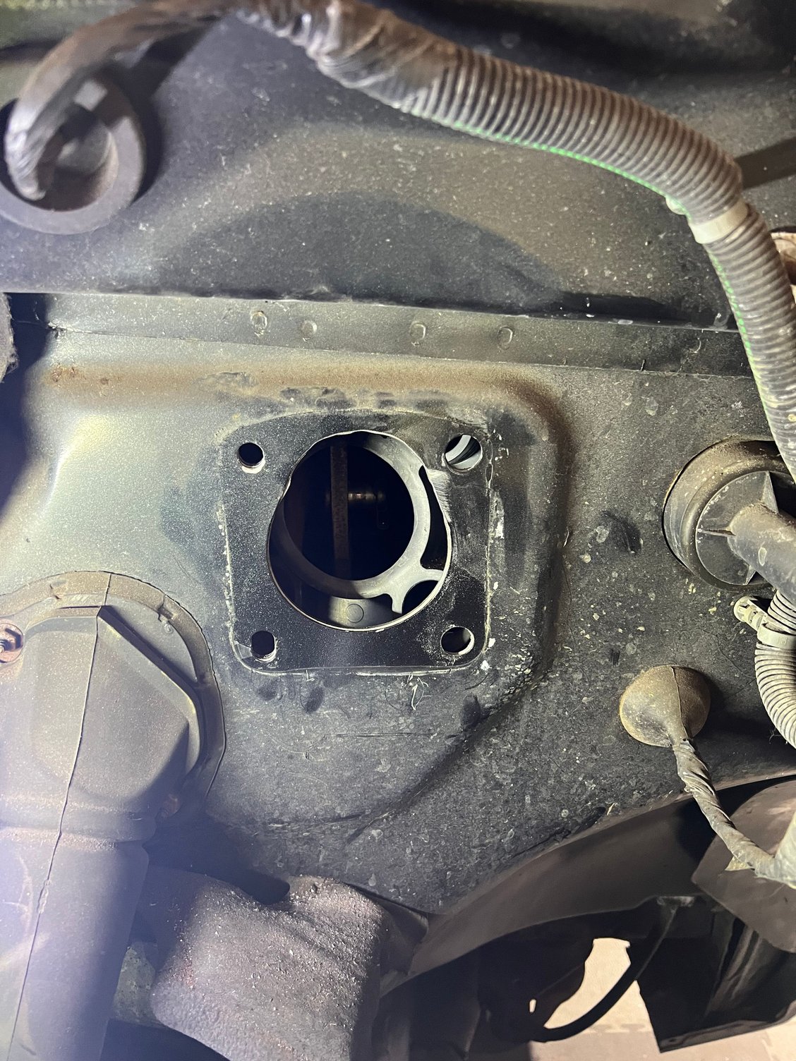

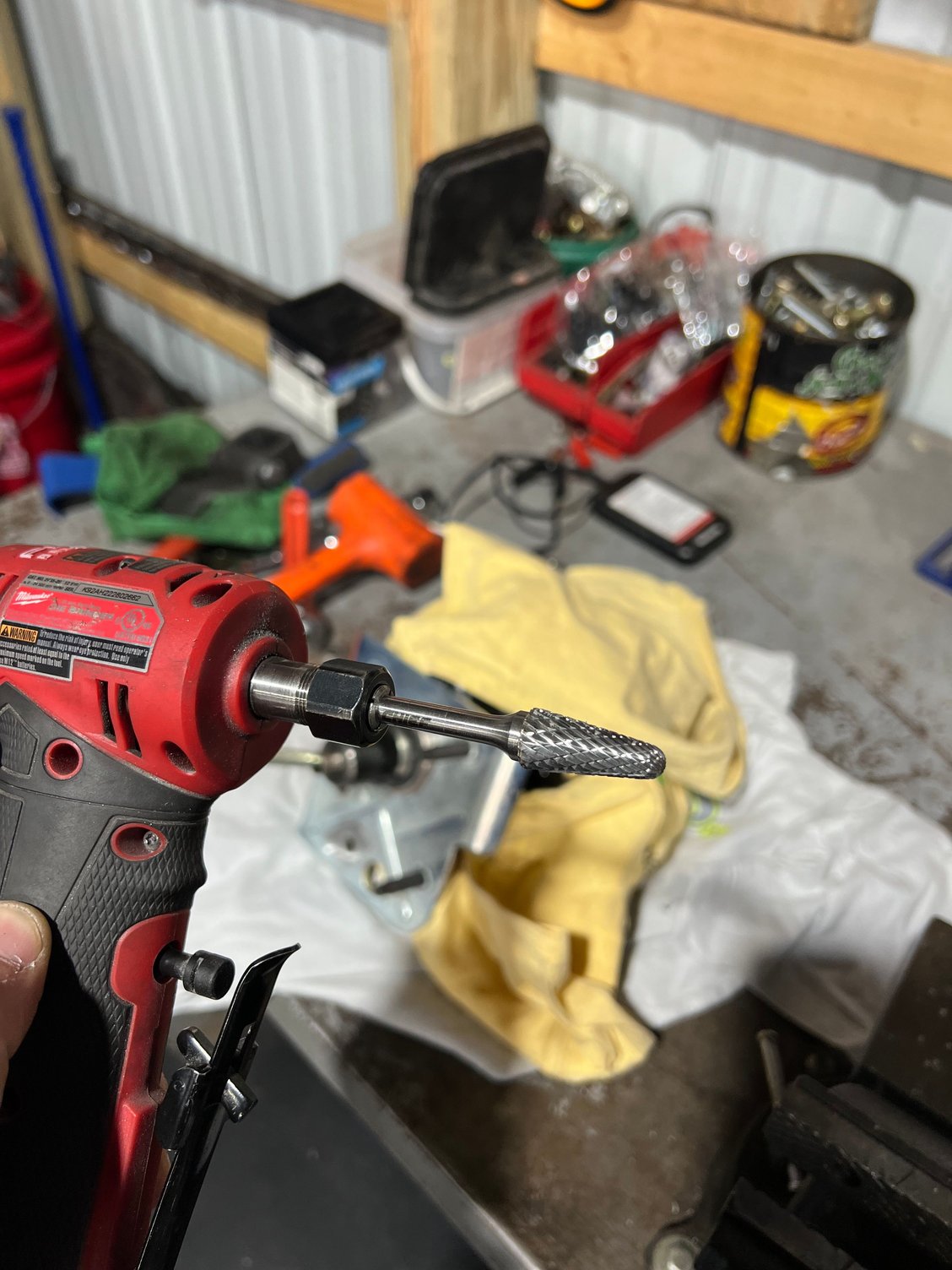

Had to open up the top of the hole in the firewall a little for the hydroboost unit to clear.

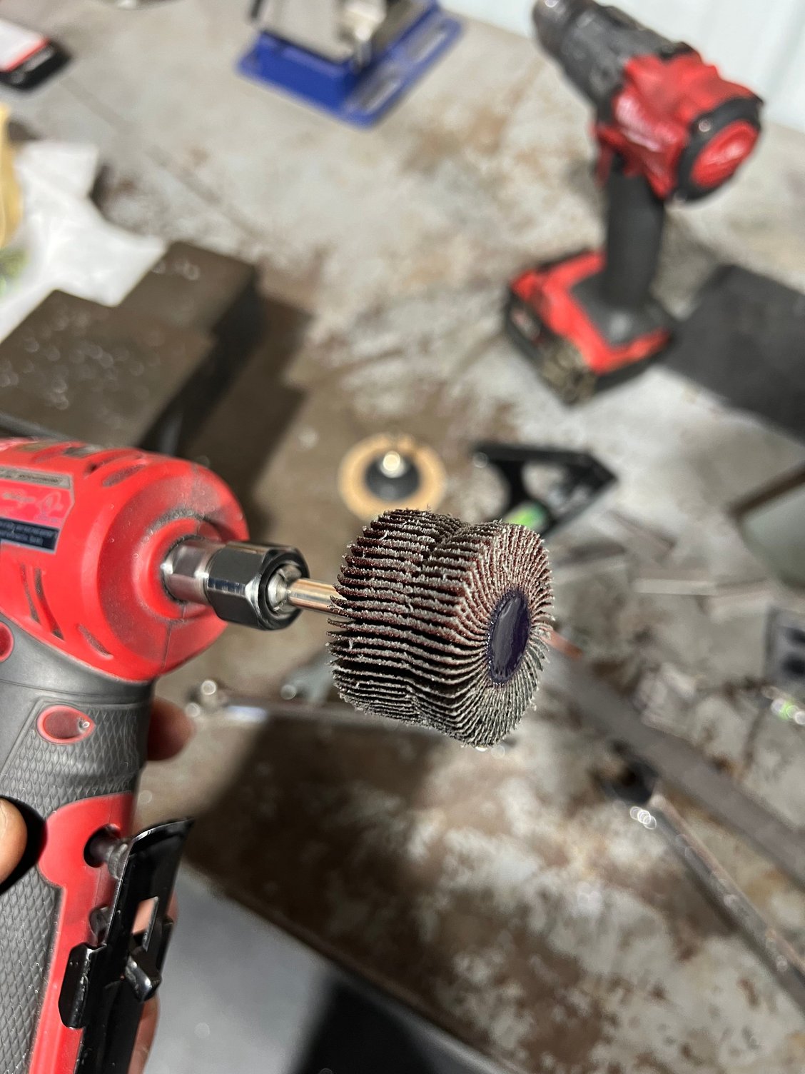

Used this ti clean it up after the rough bit.
You can see the top of the hole where i opened it up a bit.

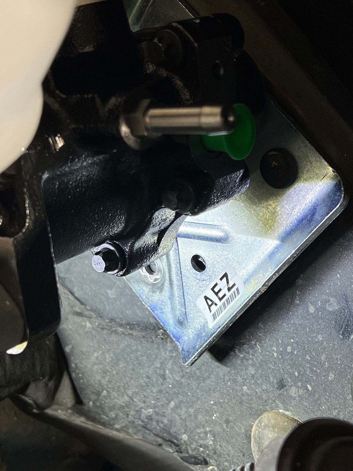

Down by the sticker you can see the hole that doesn’t line up. I will either drill the hole in the firewall or make a different hole in the mounting plate. Leaning towards making different hole in the mounting plate.

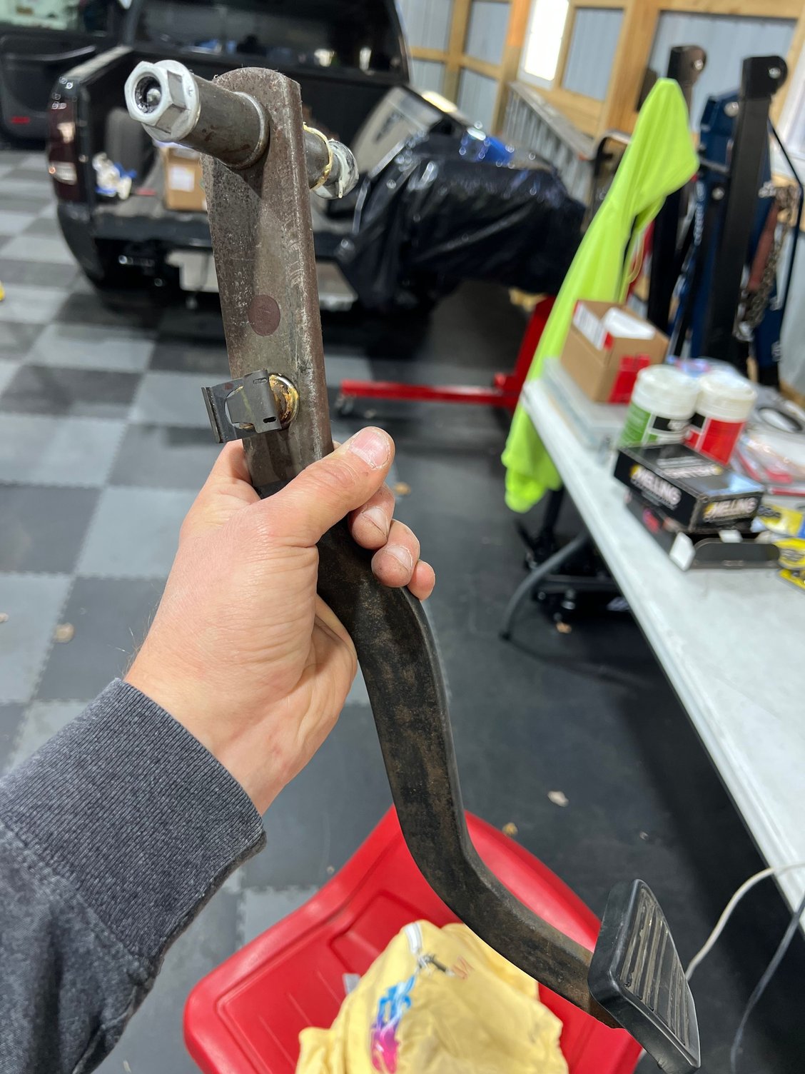

3 bolts holding it in so I can work on the brake pedal.

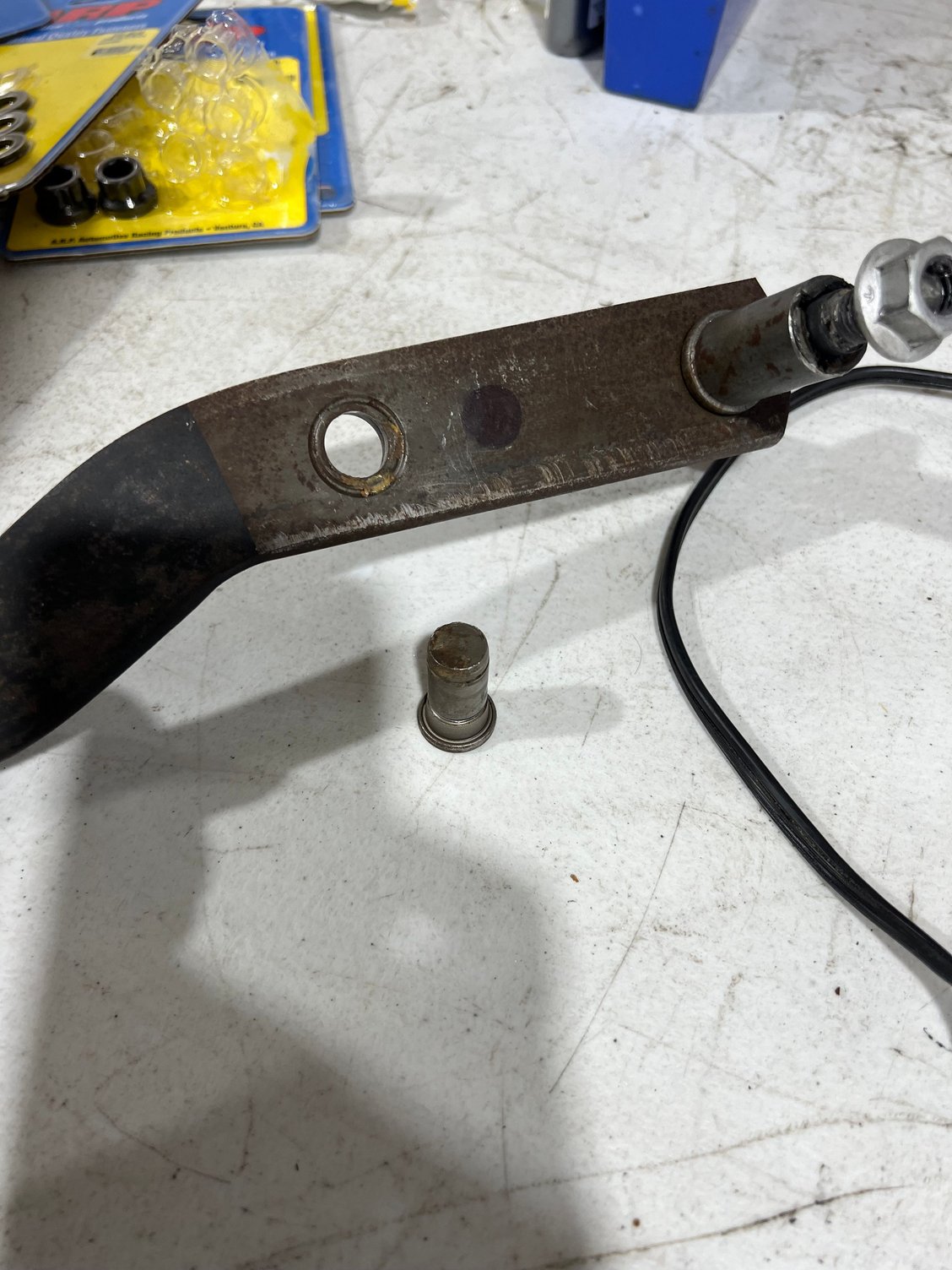

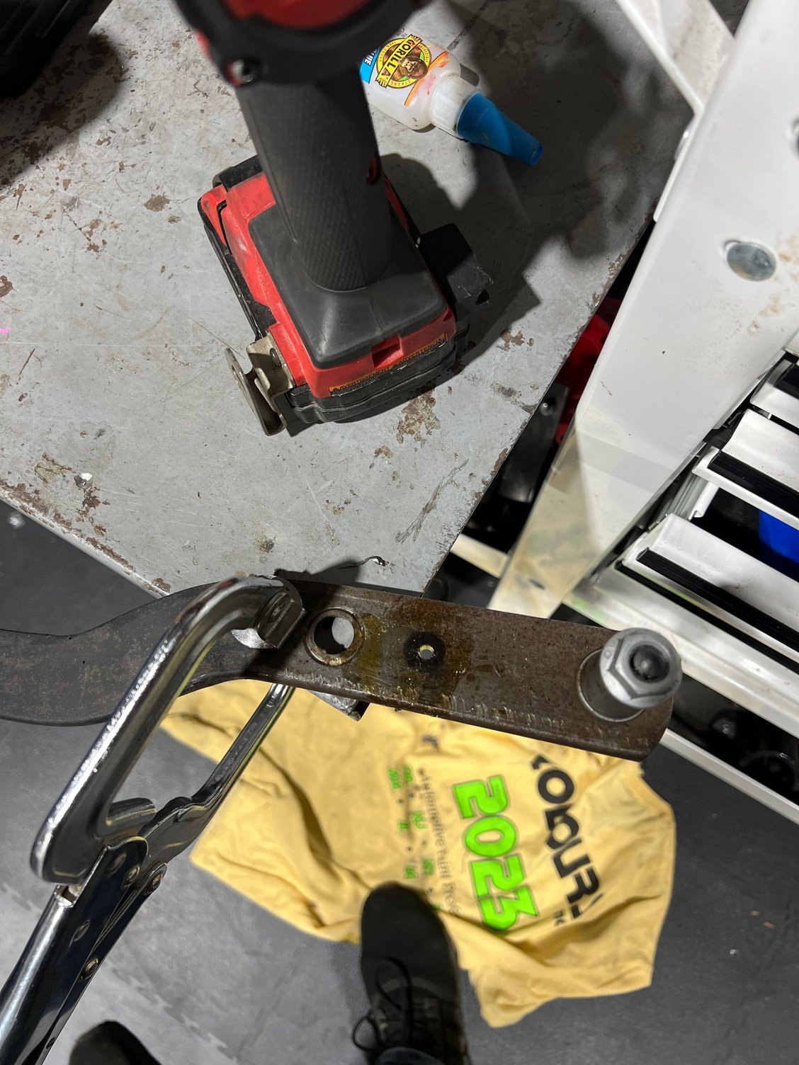

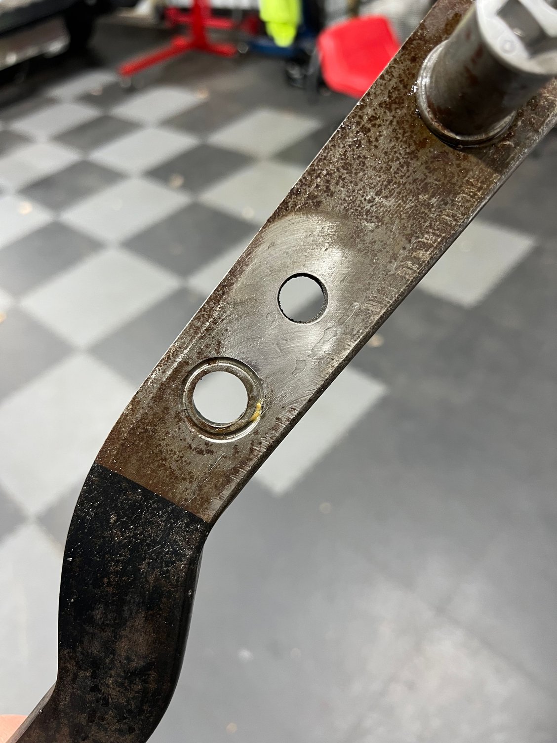

The mounting point for the rod coming out of the hydroboost needs to be higher on the brake pedal. You can see where I marked it with black marker.
Couple hammer shots and knocked it out of the factory spot.

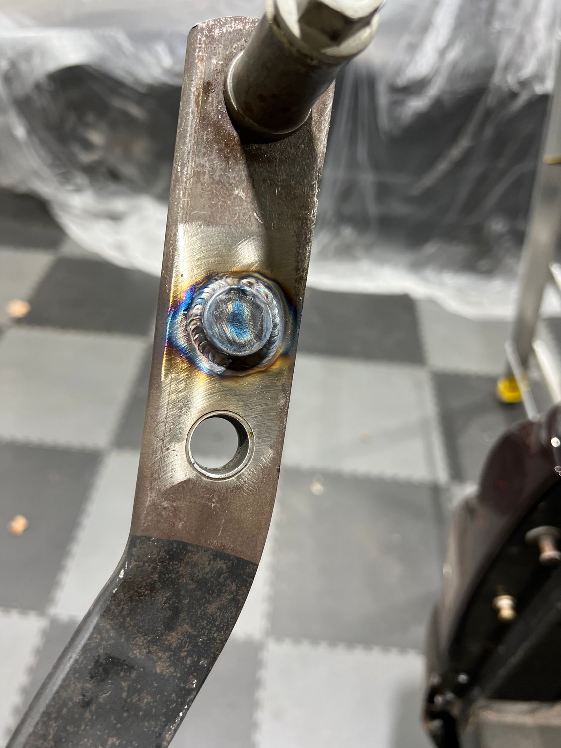

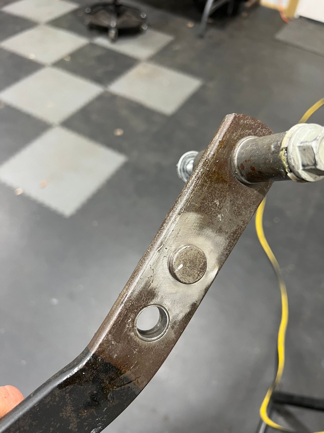

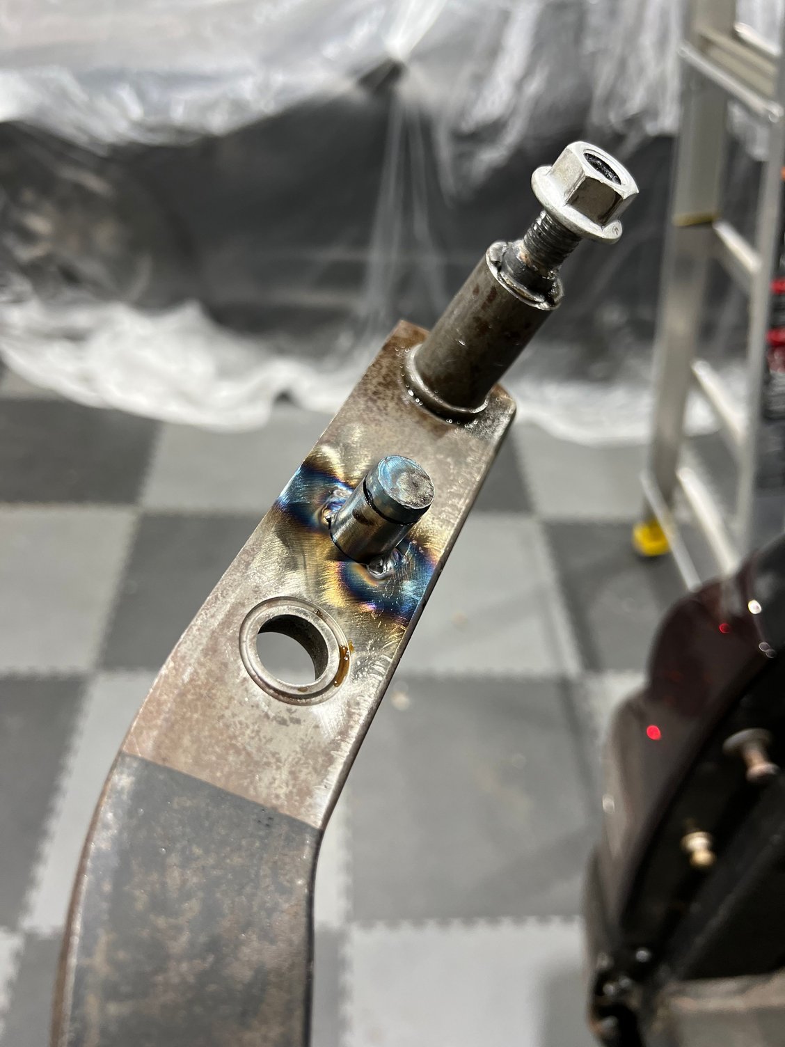

Drilling new spot.
Drilling new spot.
Had my buddy weld it in after drilling a 5/8ths hole and dropping it in.
will get the pedal back in it tomorrow. Hopefully I don’t have any issues with the brake light switch being higher and hitting anything under the dash. Getting that pedal out wasn’t as hard as I thought it might be. I can’t believe the whole clutch pedal assembly in these trucks are plastic.

Nice details. Your buddy got some welding skills too.
