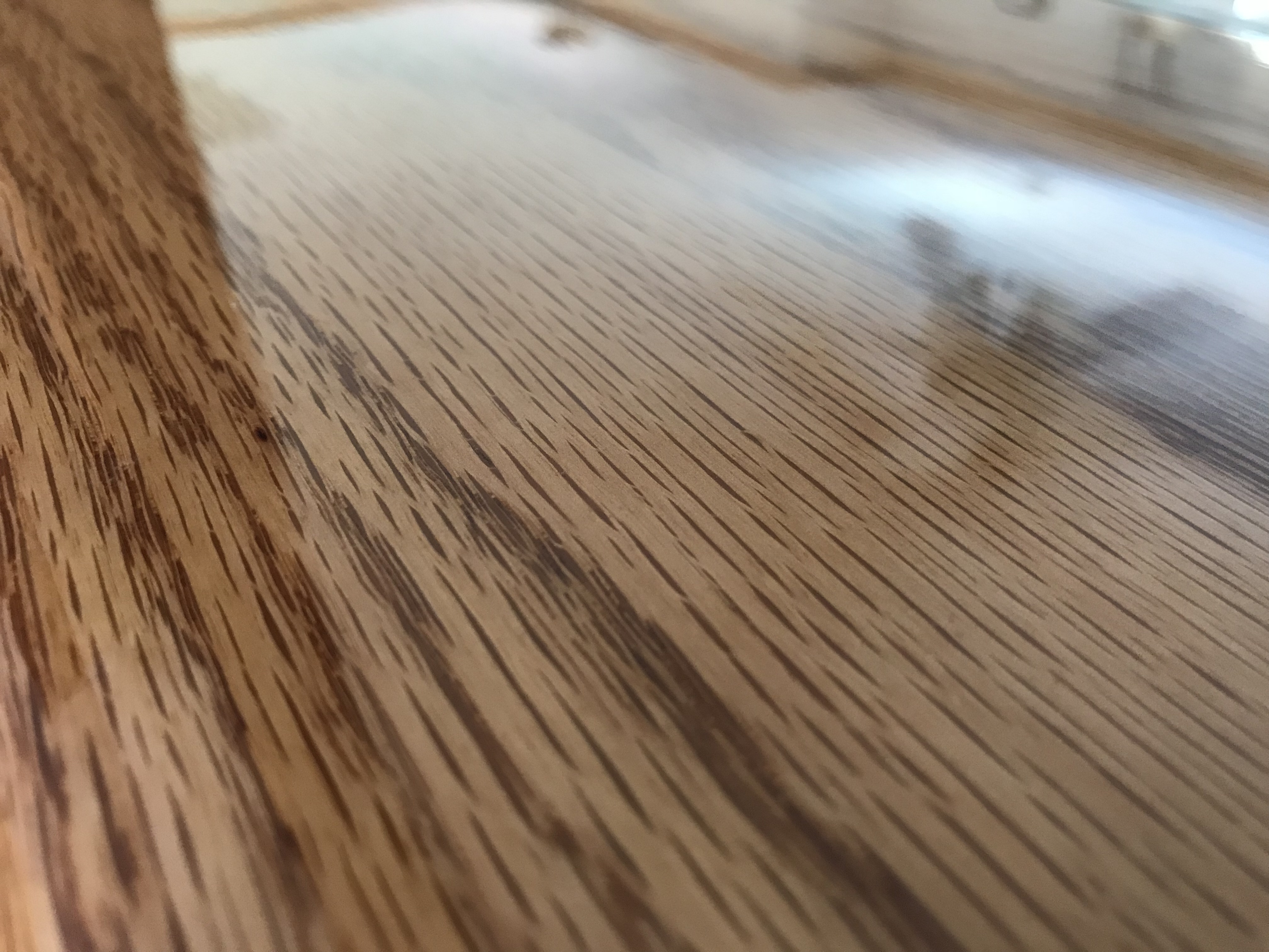

I’ve had good luck with a heat gun, mine goes to 1600 and I prefer it over a torch. I can see the beer caps being a pain in the ***. I wonder if you could do it in two pours. First just to seal the caps to the table and seal the air under the cap. Second to finish them? Hmmm
I plan to put a bar in my basement and would like to do a creative top.
Here is a oak mantle I did.
Attached Thumbnails Epoxy Table Tops-923b7c06-f6be-436c-8a2f-871116dd4dab.jpeg

That’s nice work man, and I like your idea! I always like experimenting on my own stuff and open minded customers who are willing to let me learn.
