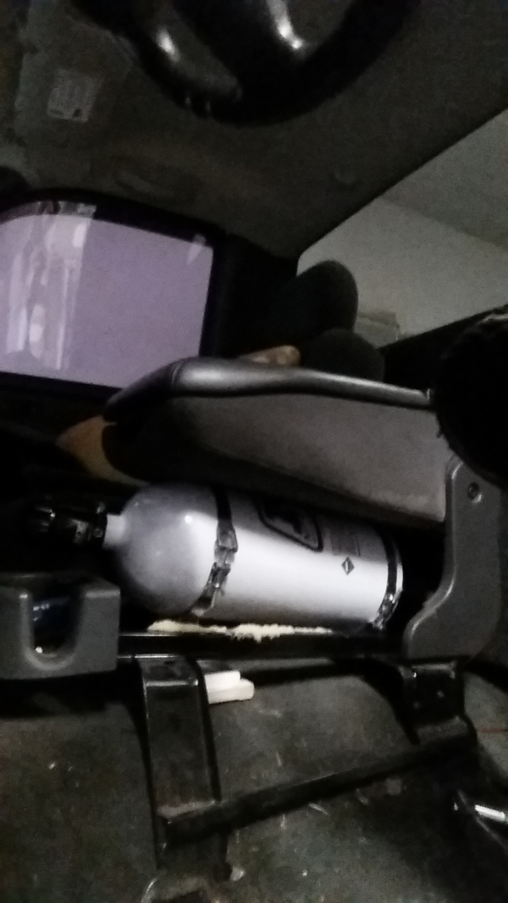

Tapping into stock fuel line for feed/ bottle location??
1 Attachment(s)
So i have my nx kit wired up just need to run my lines and i am wondering how you guys are tapping into the stock fuel lines? Also wondering if anyone has mounted their bottle hereAttachment 88672

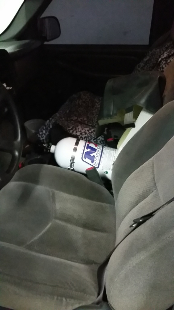

Budakane Dec 1, 2015 10:22 AM
That's an interesting bottle location, any more pics?
XBlackXCheavyX Dec 13, 2015 02:15 PM
2 Attachment(s)
I just have these to.
Attachment 88219
Attachment 88220
I had seem ppl mount them in the bed and behind the seat but I wanted mine to be discreet and I have a subs behind the seat so that wouldn't work. So i came up with this, the 10lb bottle fits like a glove in this spot.
