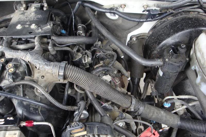

I ran the last two(TPS and RPM) wires needed and wire loomed everything. Put the progressive controller in the glove box with plenty of length to be able to hold it in my hand from the drivers seat if needed. The last step is to crimp/solder the connector to the wire and attaches it to the t-tap I put on the Purple wire from the TPS. And same for the RPM from the coil connector.
You can see the wire loom I ran only because it is new compared to the existing loom that is dirty.

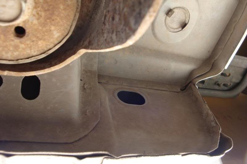

I finally got a chance to crawl under the truck and take a pic of the hole with rubber plug. There are two that can be used to run the nitrous main feed line through. One is in the front(the one I used) and the other is in the rear of the cab. They are both directly under the door sill that runs the length of the door and up to the rear of the cab.
Here is the one I used. I will be using the existing rubber plug as a seal I just need to drill a whole large enough to push the line through.
Here is the one near the rear of the cab.
