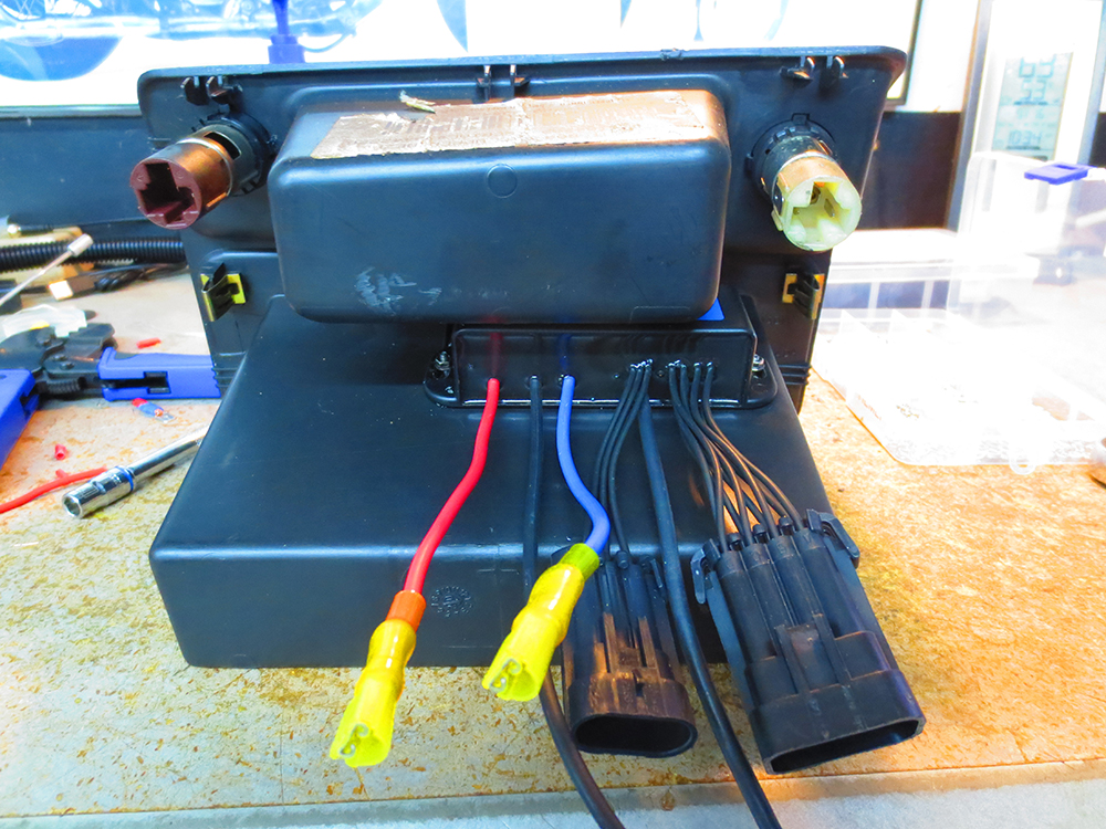

Most progressive controllers will control two stages if you decide later to add a 2nd set of solenoids. I know my NOS Mini has the option for two stages.
I hid my controller behind the console insert.
You can see the blue 1st stage wire and red 2nd stage wire.. one for each stage.
The blue line on the touch screen tach shows where (user set) the RPM the nitrous starts spraying at 3000 RPM and stops at 6400 RPM. If there was a second stage you's see a second red line showing the RPM range corresponding to the 2nd stage.
