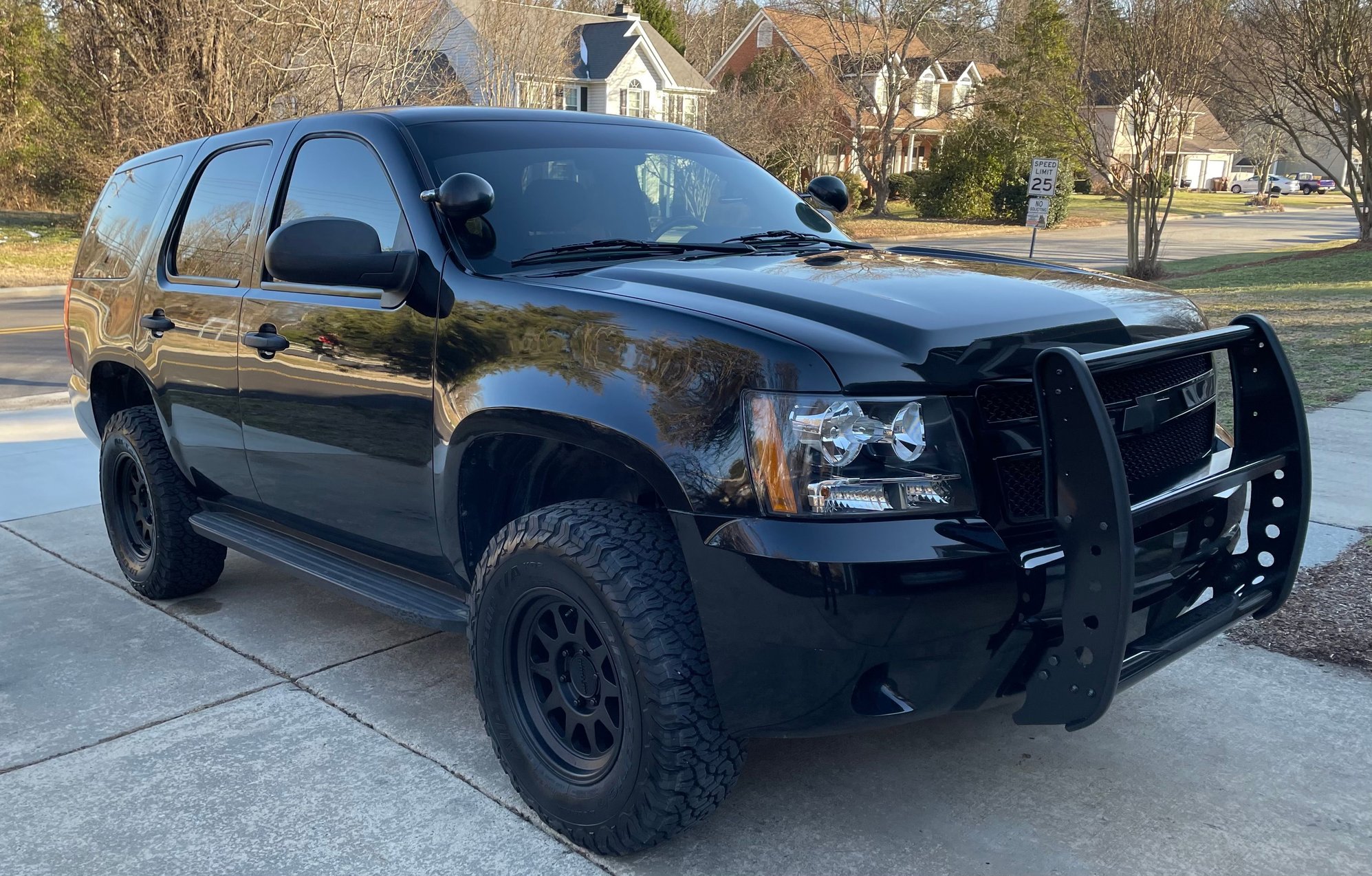

Hey guys,
New member to the forum based in the Piedmont Triad area in NC.
I purchased a 2012 Tahoe SSV (5.3L LMG) a couple years ago and now has ~100k miles. Put a leveling kit, bigger wheels on it but now I have the power itch to swap the 5.3L for a 6.2L (possibly turbo) sleeper.
Looking for knowledge to make this happen and most sites and youtube videos I've seen reference this forum. I'm not in a rush since the 5.3 is still running strong and I've never done an engine swap before so I forsee a lot of reading and asking questions to get the right mix of parts. Looking forward to learning! My truck pic is below
