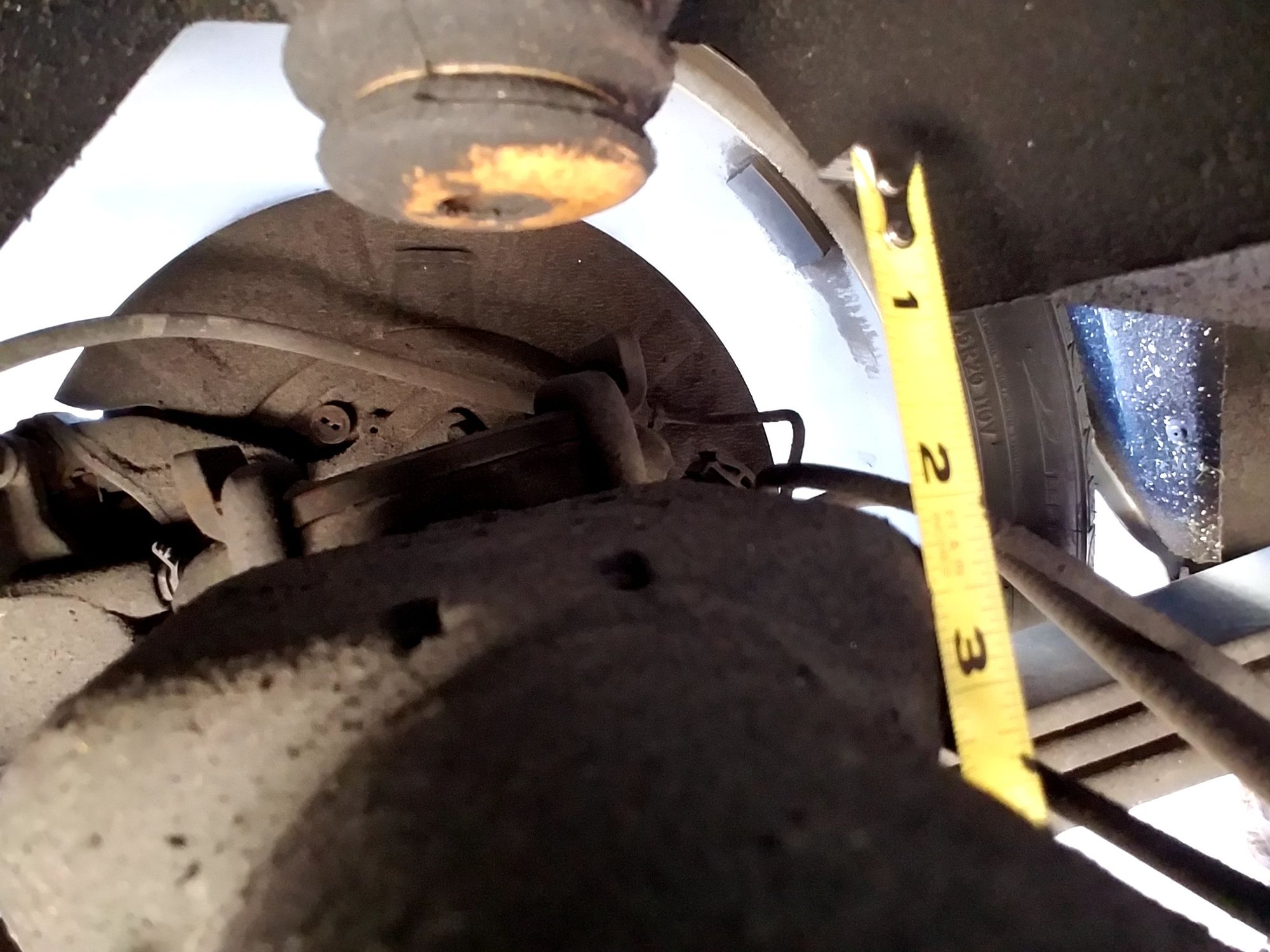

6" might be ok, This is 7" drop, you can see how often axle hits bump stop.

Hey Feed, what year is that truck in the pic?

That is my '15.
