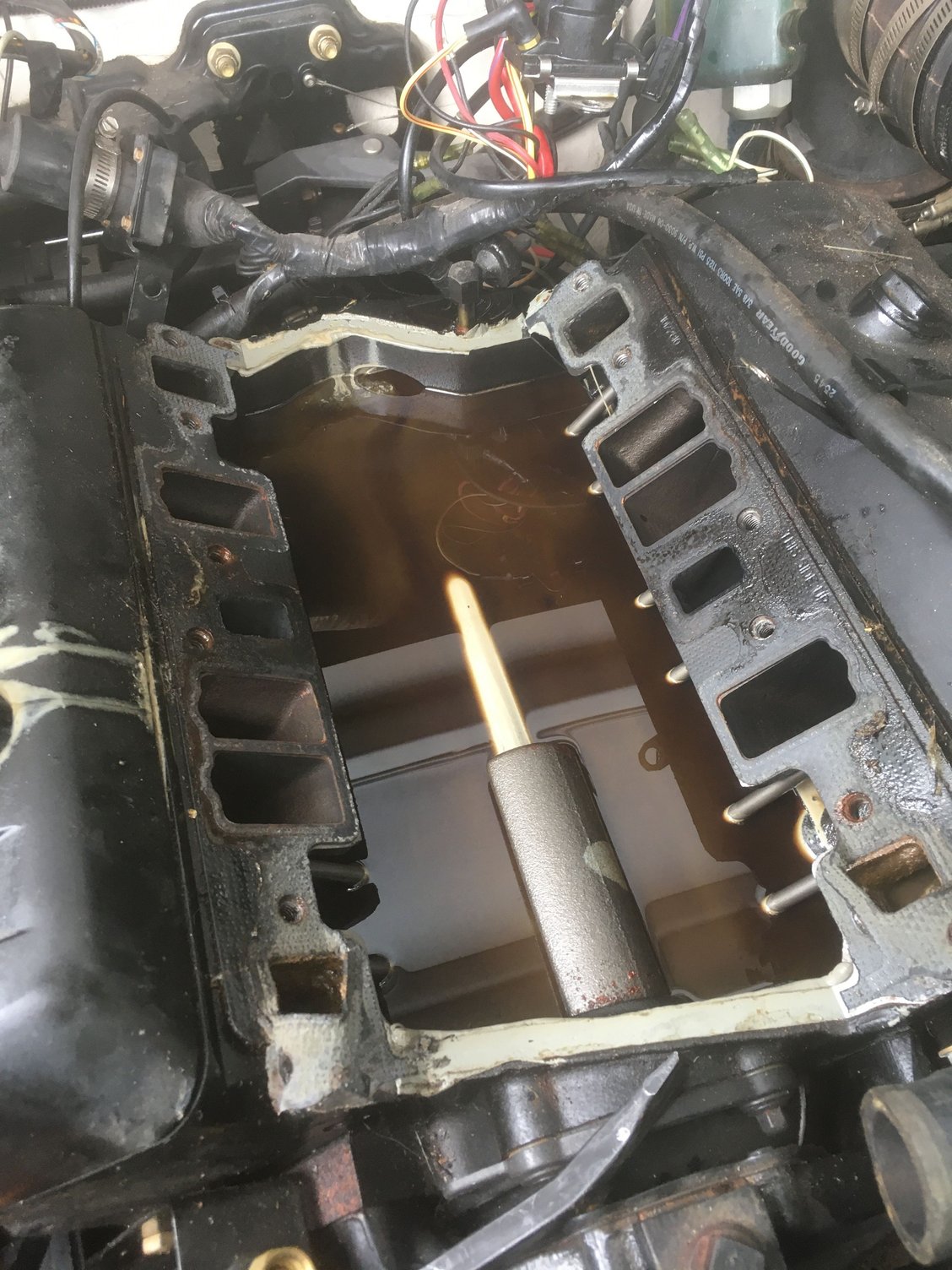

Just to add, its also impossible to get that area 100% clean without putting the block through a hot tank... even them I'm not sure it'd be 100%.
Old Jul 29, 2022 | 07:00 AM
  #42
arthursc2's Avatar
Joined: Jan 2014
Posts: 4,341
Likes: 1,517
I tried. I torched the bajeezus out of it and flushed the block with clean water and let it sit for several days to air dry
not sure any of it helped lol
did I post pics of the valley full of water up to the intake?

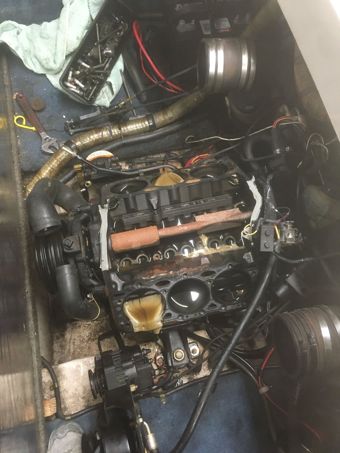

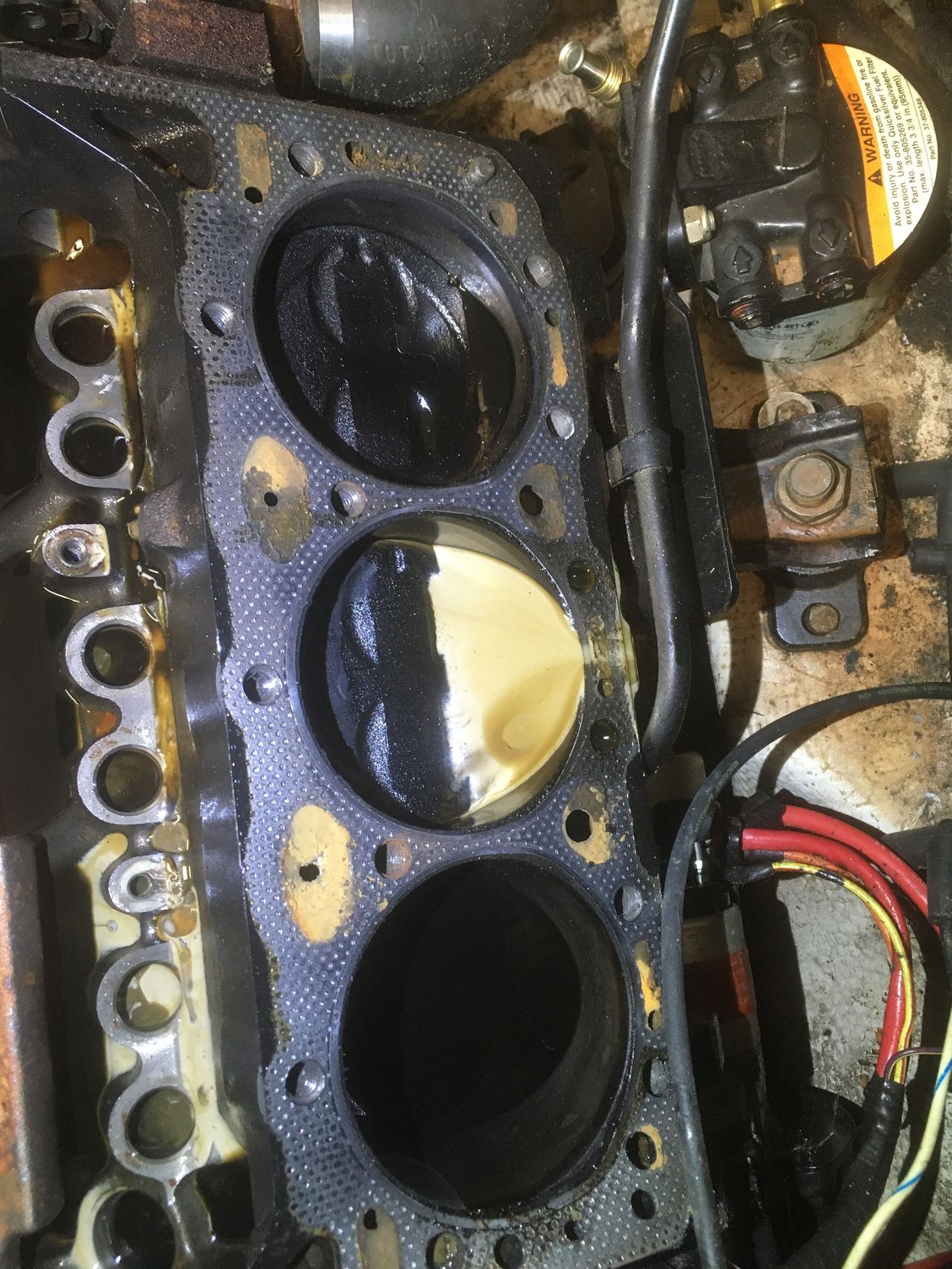

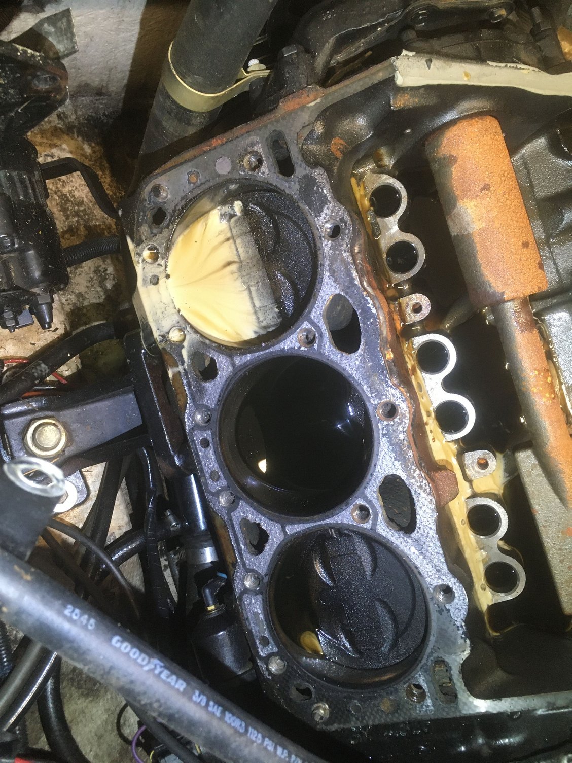

Pulled the heads, dat was nasty
Ordered carb rebuild, gaskets and fuel/water separators. 1 to replace the 25yr old one on there and 1 to keep in the box JIC. Fuel pump grommets are absolutely toast but luckily I have some that will fit. Still waiting on valve springs and short block to arrive
Looking for suggestions on other marine parts/tools to throw in the Pelican case to keep onboard, if anyone has suggestions
