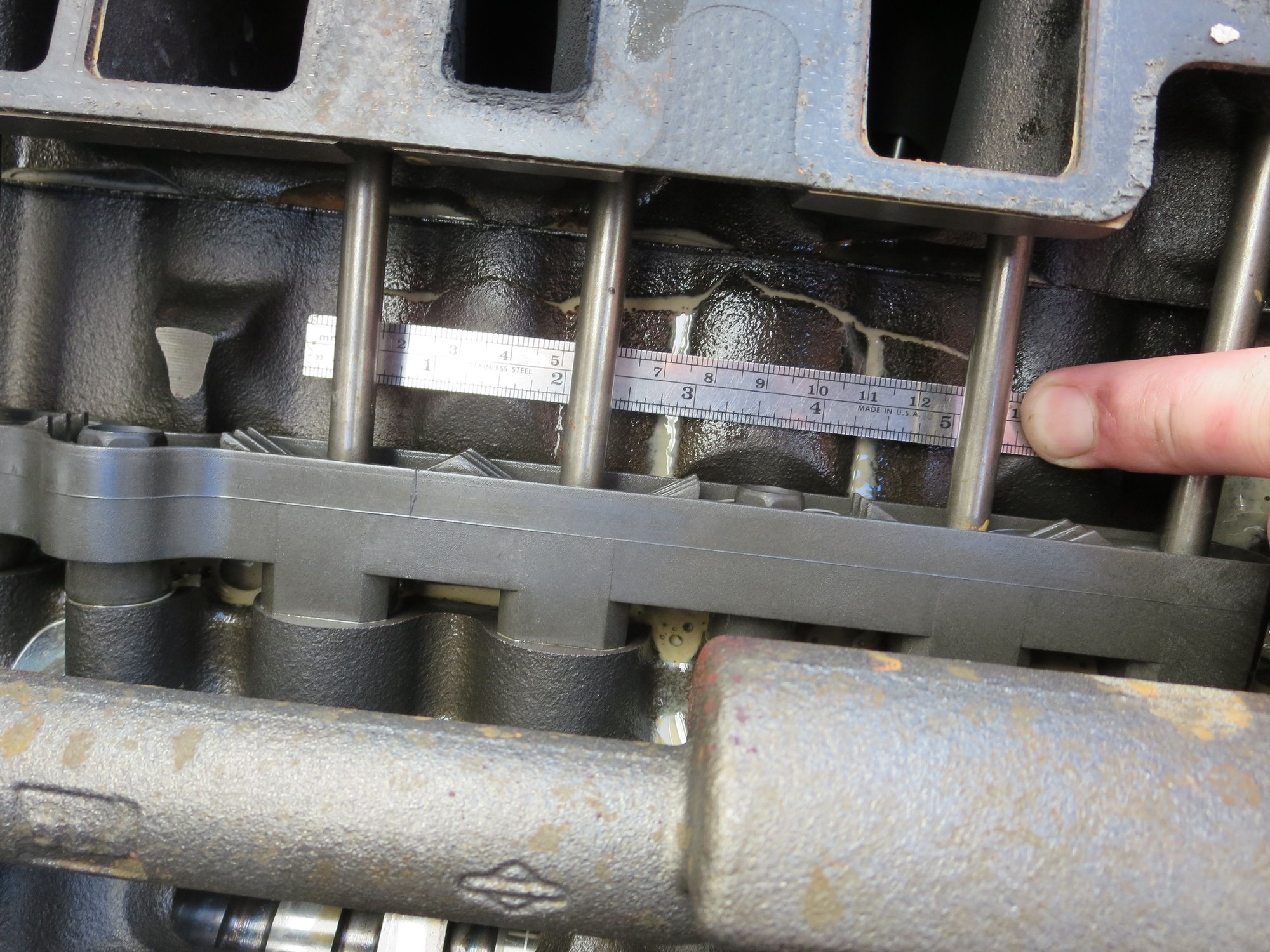

Once I get the boat to my place I will pop off the intake and look. Will the crack be visible from the top, if it's cracked?

Cracks should be easy to see in lifter valley. I would never consider ls swap. Sevens Marine made an outboard with the caddy motor to compete with mercury and guess what there are out of business. If she is really wanting to restore it and it be reliable go mercruiser.

Which one of you said the block was cracked?!?
5.5", I could only be so lucky aha

You guys think I should tell her this is the cheapest option or should I try to braze the block
