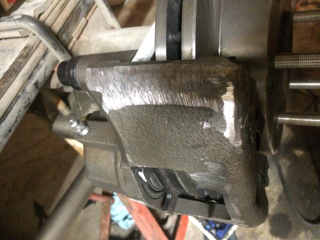

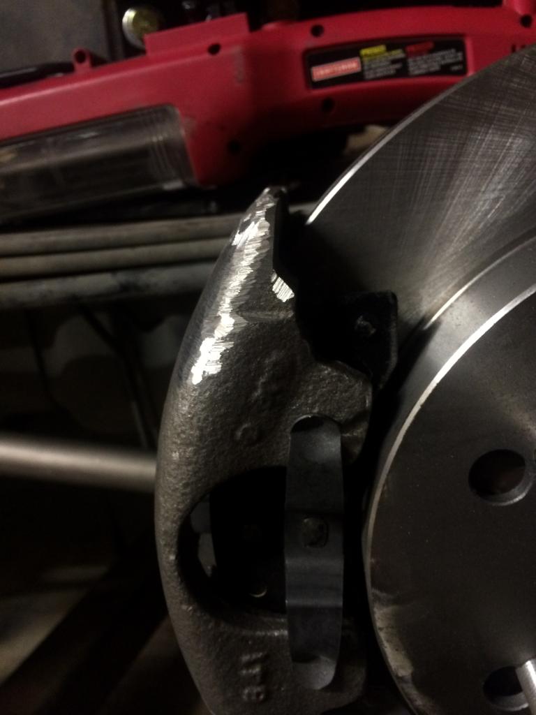

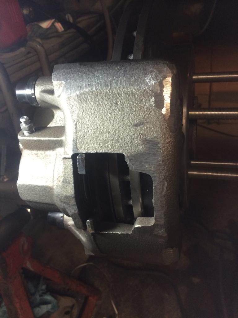

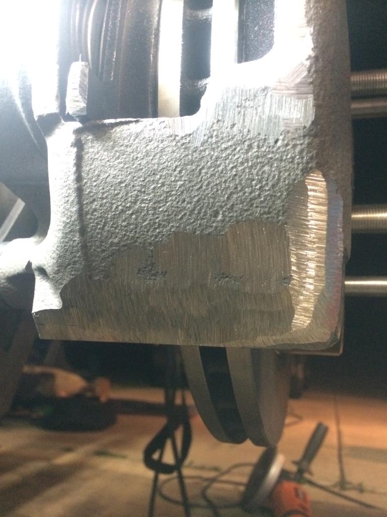

I got mine installed and got the wheels to fit. My wheels measure 13.12" ID and I had to do minimal grinding and they clear by almost .25". I just need to get the tires on and get a few pics installed.
Here are a few pics of how much I had to grind down.

Wow those are going to look killer. Looks like even with that small of an inner diameter, you really are sufficing any structural integrity in the calipers. You still have a lot of meat on that caliper. Glad it worked out for you!!
