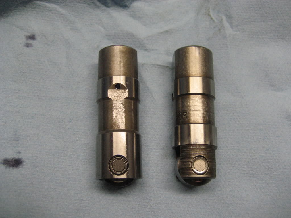

When you get close to buttoning the motor up, you should always order your pushrods last. Get a pushrod measuring tool and measure your preload. There is roughly a .050 difference in lifter cup depth in the old style lifters vs. the new ones. It's beyond me why sponsors keep pimping out the 7.4's unless that's what you really need. My heads with only .007 milled, stock gasket and LQ4 shortblock running LS7 lifters needed a way shorter than stock pushrod.
LS7 lifter on the left in both pictures........

Wow, thanks for the pics Joe, I can see the difference Yea, I planned on getting the pr's last, already have a Comp pushrod length checker...it was like 12 bucks when I bought it. I'll be getting my heads milled around .030 so I'll definitely need a shorter than stock pushrod
