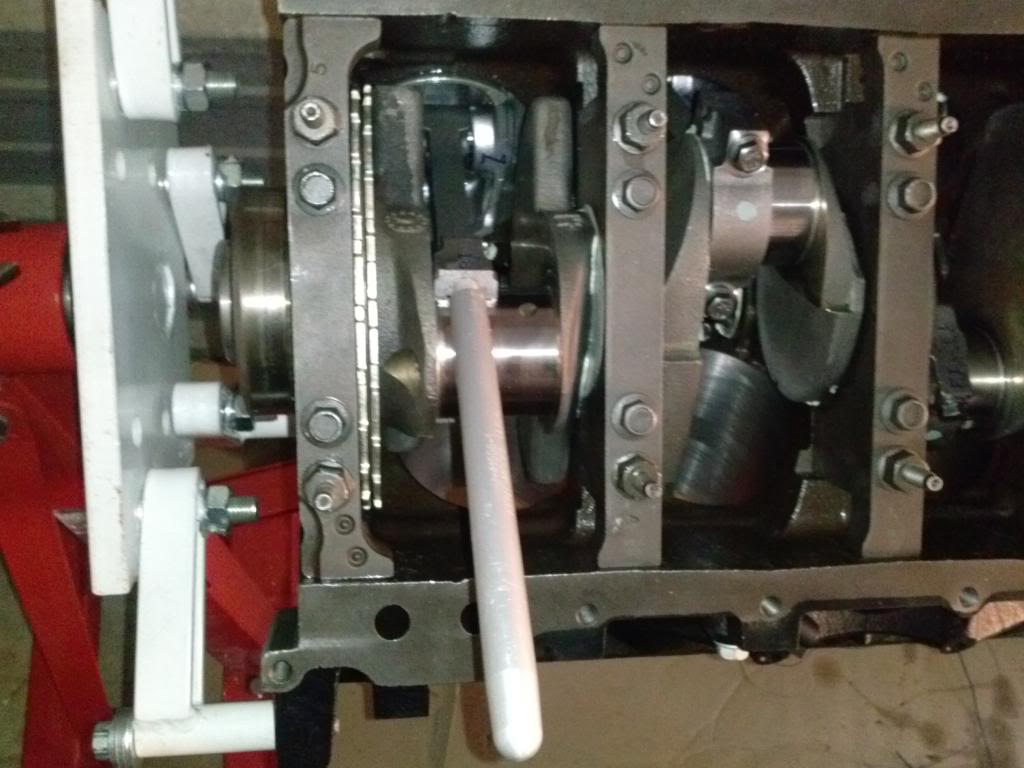

I have a LY6 machined to 4.065" with LS3 heads and 24x crank, have about 20k of daily abuse on it now. Broke the engine in with a LS9 cam and it pulled dam good even though its a "boost only" cam some say. Current cam is 216/224 .533/.533 117lsa
Attachment 107910
Attachment 107911
