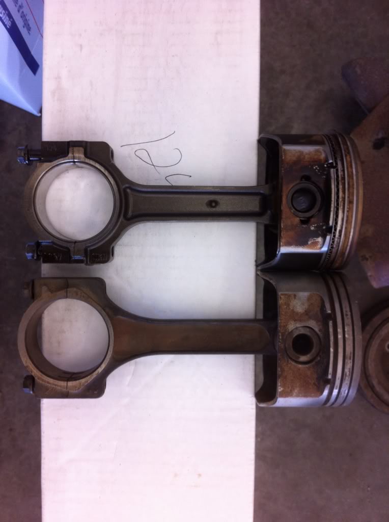

AKlowriderZ71 May 2, 2012 11:39 PM
1 Attachment(s)
I've verified GM part numbers in the past, when I was researching this. The L33 piston part number is the same as the 4.8 liter piston.
Here's a pic of an L33 piston & rod above an older 4.8 piston & rod.
Attachment 137966
I'll have another LM7 apart soon, and I still have a set of 4.8 pistons here. I suppose I can take some measurements if that would make you a believer. :)
