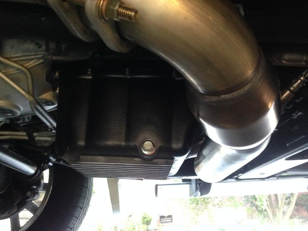

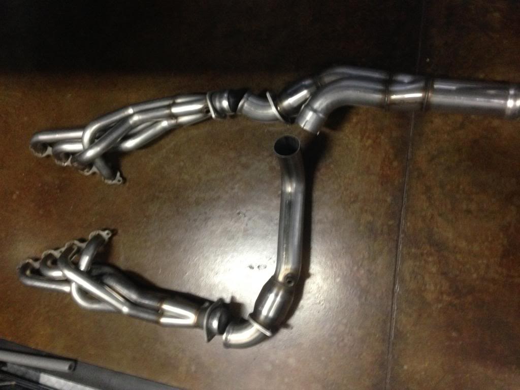

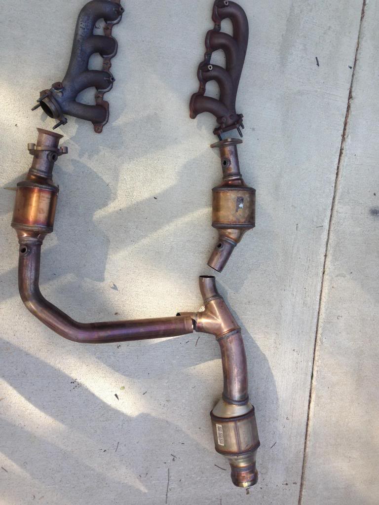

Got mine installed: Not as easy of an installation as I was told it would be. I started at 8:30 a.m. on a Saturday morning. I have a lift and power tools. Muffler shop completed the job at 3:00 p.m. that day
But they are nice.
factoryi:
American Racing Headers:
PML deep trans pan installed at the same time:

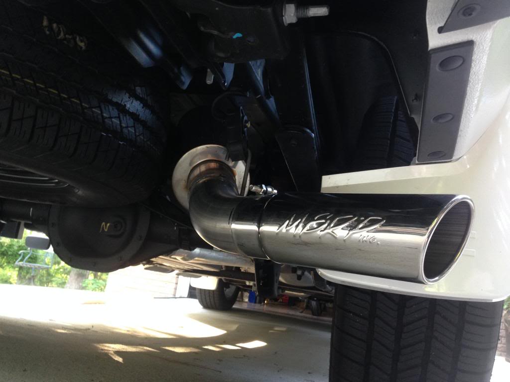

3.5" Magnaflow resonator and 3.5" tail pipe installed at the same time:
Now everything is a full 3.5" straight thru design with no restrictive baffles or flapper valves.
But they are nice.
factoryi:

from the headers back, everything was a custom combination of parts. Two 3.5" mufflers in-line from Maganflow and the new resonator is a 3.5" Manaflow muffler also. I'll look up the part numbers. Then a 3.5" 45 degree stainless elbow and the 3.5" to 4" tail pipe.
My goals was a free flowing full system but retain the quietness. It was a success.
