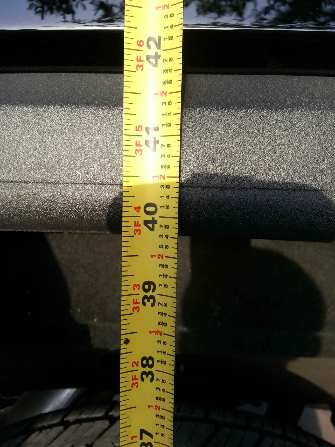

Frodo T. Baggins 08-06-2013 07:56 PM
2 Attachment(s)
Originally Posted by silver-mod-o (Post 5132849)
I'd to for it. Rough country makes some nice stuff. That kit looks super easy to install as well. I'd give it a shot.
Also, Belltech already has suspension out for these trucks. I'd look them up too, they've come a long way in recent years. I'm running their adjustable struts on my 07 and they're great!
Yea looks like I'll be getting that one and hope I like the drop...and I actually did try Belltech since I saw the other thread about the 4/6 drop on the red Silverado but to my surprise, they told me they don't have a complete kit yet. This is what they told me,
"Thank you for contacting Belltech Sport Trucks, at this time we do not offer a complete kit, however we do have parts separate that will work. Unfortunately with what we offer at this time you'd only be able to achieve a 2/3. The fronts a 2" drop will be our drop spindles, part number 2509. For the rear you can use part 6401 which is a 2-3" shackle. We also have shocks available if you're interested in replacing your shocks also.
Spindle 2509 - $348.13 MSRP
Shackle 6401 - $83.63 MSRP "
BTW, here are two pics I just took. Hope they help someone.
FRONT:
Attachment 112056
BACK:
Attachment 112057
AUTOT3K 08-06-2013 11:28 PM
oh wow thats a big rake on the 2014's!
you'd need a 3" rear drop to level it out and it'd still be a 1/2" high, however once you do some driving it'll probly settle a bit

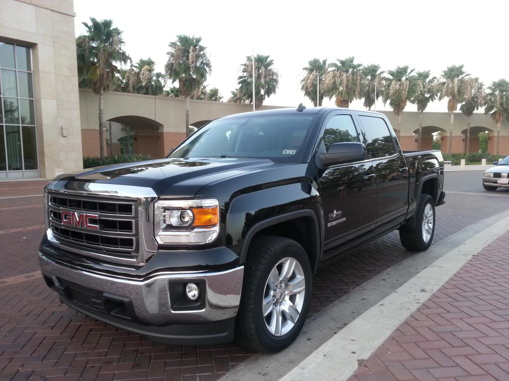

Frodo T. Baggins 08-25-2013 11:25 PM
6 Attachment(s)
Well, thank you all for your opinions. Ended up going with McGaughys 34170 kit. Went with a 3/5 drop afterall and absolutely love it! Installer ran into a minor hiccup but everything worked out fine after tinkering with it. Not sure exactly what it was since I didn't understand all the technical jargon he gave me. Here's some pics for now including some before and oh, one of my other toy. Thanks for watching.
Attachment 111297
Attachment 111298
Attachment 111299
Attachment 111300
Attachment 111301
Attachment 111302
