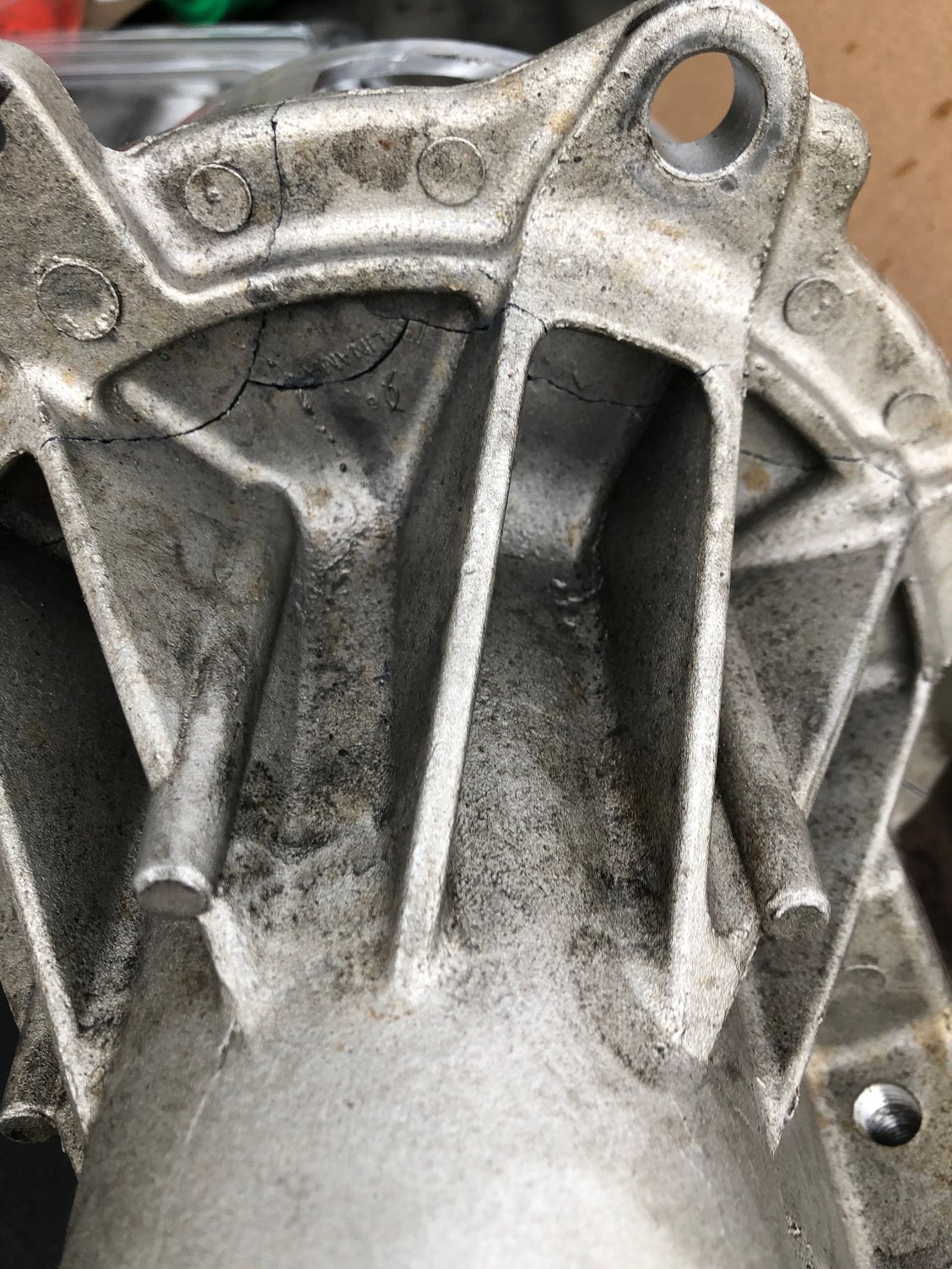

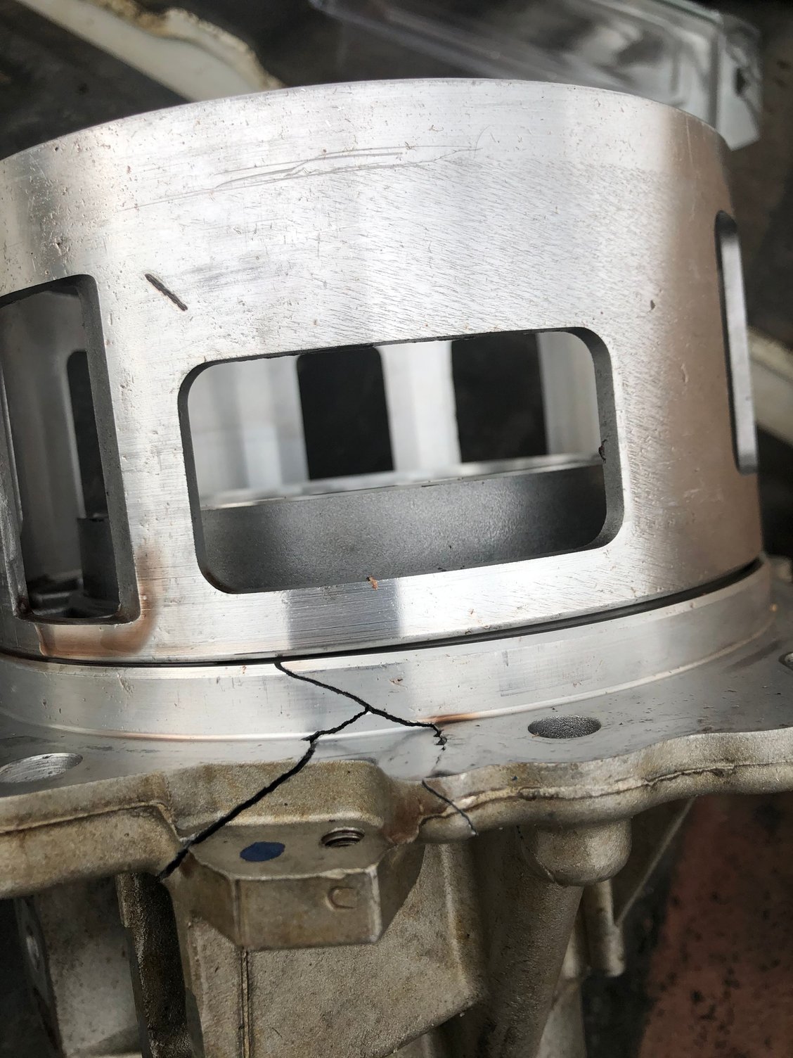

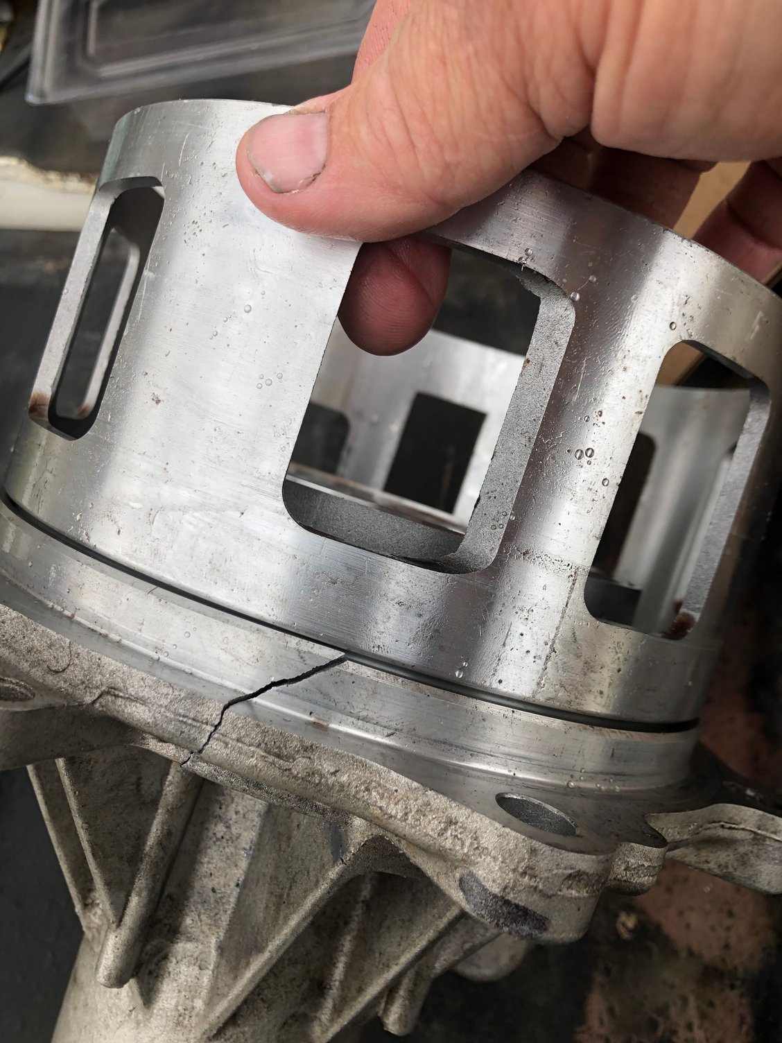

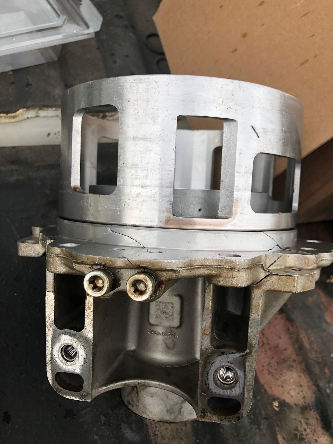

That drive shaft is my first full pass. I was just over the 1/8 mile when it went “BOOM”
I will attach pictures of the tail area of my 8l90 transmission.

I replaced it with a 2 piece driveshaft. Worth every penny I spent on it. It would of been way cheaper to spend $800 on a 2 piece driveshaft and not $3500 on fixing/upgrading my transmission
