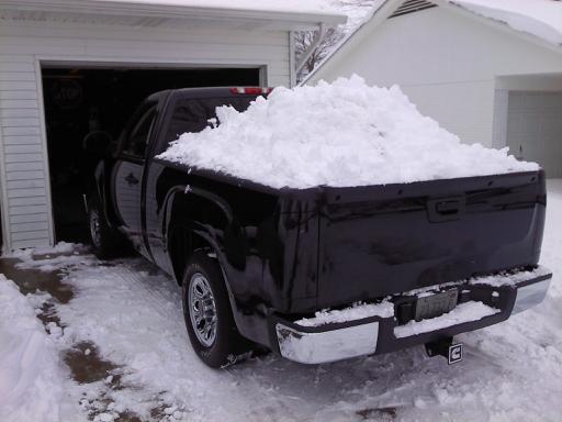

1 Attachment(s)
Maybe not 1000 lbs but quite a bit when you are using an aluminum scoop!
Attachment 51096
niugnep Feb 19, 2010 10:03 AM
Attachment 51096
You know, it is amazing how heavy that stuff gets. i thought I was the only one that did that for weight!!LOL Makes sense, its free, and when it gets warm it just melts and gets more compact if its a chinook and later freezes again.
Might not be 1000lbs but I'm sure its 4-500...my truck sits a good 2-3" lower with the bed partially filled (I don't go over the height of the rear window just for visibility). Thats a little less then when I brought home a 455/T400 combo in the back (that is 800 lbs or so complete with crate as well) That and some winter tires on 17" rims and I have driven just fine on roads where lots of 4x4's are in the ditch. Of course most of that is just driver as well I think....
Its a big deal, might be upgrading soon, trying to decide if I want 6.2L 6 speed with 2wd or 4wd. Only a few days a year where a guy really needs 4wd up here (unless you are off-roading all the time) but it could save your life. Tough call.
