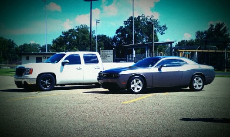

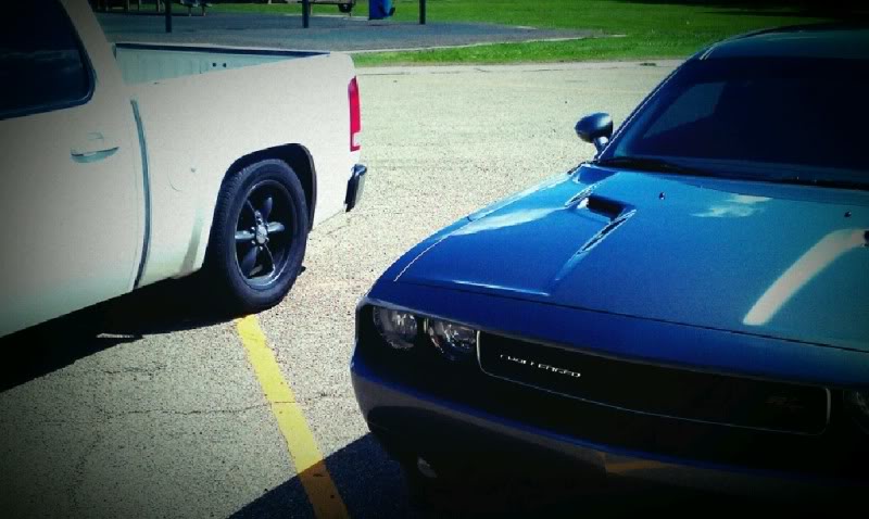

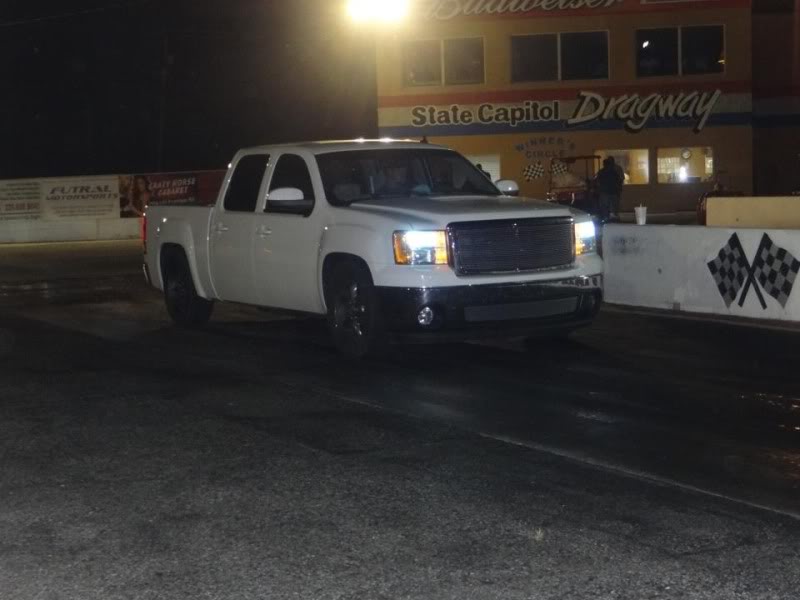

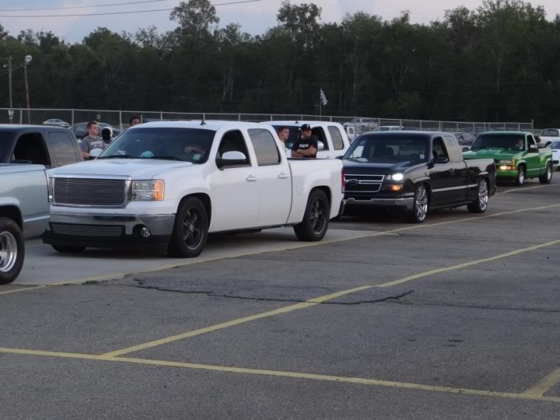

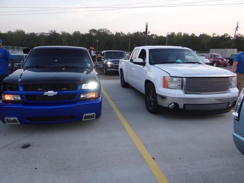

perfect .... what kit do you have? I have been looking for a week or so on here and other sites for pics. What 4/6 kit do you have ... seems to be a huge debate lol. I think i will go with belltech as FROM WHAT I READ you dont lose any turning radius with there kit? I seem to read the DJM rear flip with c-notch is the way to go for the rear? .... Can you post a couple pics of your ride in this thread?
Old Oct 29, 2012 | 02:36 PM
iamkeniff's Avatar
Posts: 5,365
From: Gonzales, la
I have mcg coil relocator kit, 2" djm spindles, 2* upper control arm bushings, djm flip kit, mcg shackle kit, stock shackles, no notch
