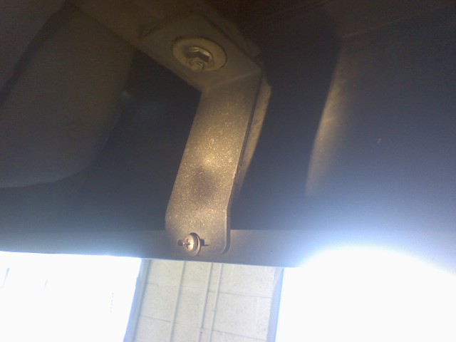

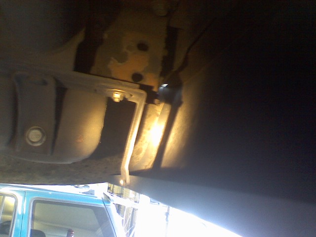

Ill get a pic of those braces on the underside. But I would definitely screw it in before welding it. Mine it kinda tweaked, I donno if from shipping or just how it came. Definitely try and get it straight as possible before welding it

Heres those pics I was talking about. Been awhile since I looked at them, forgot there was a 90* then a slight bend
hope it helps

mine is welded on the sides, rivets at the top. No brackets. The rolled edge added quite a bit of strenght. Enought to where I wasnt worried about it and told my body man to forget the brackets I had originally planned.
Yeah pretty stiff. Think I will try it without them, especially since my exhaust may need to run right there.
