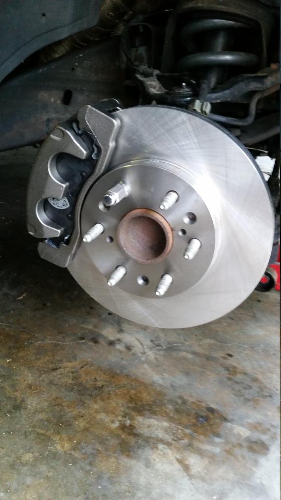

GMCtrk 05-25-2014 07:46 PM
NNBS police brake upgrade for NBS
05+ and NNBS brakes are a direct bolt on to NBS.
I got loaded calipers from RockAuto for $99 each.
New rotors from advance auto for $60 ($40 online coupon I found in 10 seconds of google search with in store pickup). If you cross reference part numbers, I believe basically any rotors you get at autozone, O'Reilly, etc are basically the same. They all list for about $50 each.
So $260 total for the setup. I bleed the brakes but havent driven it yet to do the bed in procedure.
Btw, the pads are semi metallic, police version. Stocks are ceramic. Not bad getting a loaded caliper for 99 when the pads alone are 85 at Carquest.

1 Attachment(s)
Attachment 102409
oakley6575 05-25-2014 08:01 PM
What was the reason for the swap? I noticed a little squeal in my brakes last week. I might have to look at my pads/rotors soon.
GMCtrk 05-25-2014 08:36 PM
Stock pads and rotors with over 184k. Brakes were shot.
gamble686 05-25-2014 09:21 PM
Did this swap along with SUV rears, works out great.
RibeiroBJJ 05-25-2014 09:27 PM
Well done! What a deal too! What is the diameter of the rotors?
GMCtrk 05-25-2014 09:31 PM
The rotors are 13". Stock is 12"
AUTOT3K 05-25-2014 09:32 PM
which pads did you go with? Raybestos has that new semi metallic line out, they guarantee it wont have the squealing issues like with most metallics
GMCtrk 05-25-2014 09:35 PM
The loaded calipers come with the semi metallic pads. Im not anticipating noise, but if they do im okay with it for ythe price, this isnt a DD.
When I pulled the old caliper I found that both pads were seized due to rusty slide surface. I used crc brske caliper grease.
