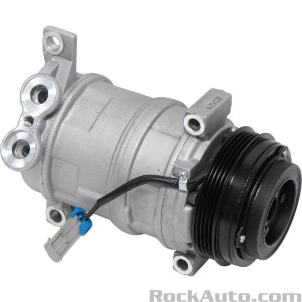

All I know about the subject is the compressors and lines are different from 99-02 Vs. 03-up. though I am not sure where the actual Year break occurs on the systems.
I also know the pressure sensors are different between the years.
The first design uses a combined suction and discharge manifold with a single stud mount in the center.
The second design uses 2 separate lines.
1st Design Compressor
1st Design Manifold
2nd Design Compressor uses 2 separate lines,

Looking at Rock Auto's catalog the change between the 1st and 2nd design is ambiguous. My 2000 GMC lists both the 1st design HU6 style and also the 2nd design Denso. It maybe what plant the vehicle was manufactured at or it could be as simple as offering the Denso as an upgrade to the HU6.

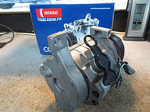

I'm coming from a v6 swap so I had the choice between the two as I needed both the lines and the v8 compressor. My v6 system had a purple high pressure cutoff switch on the compressor along with a green high pressure cutoff switch on the discharge line, with it's wiring connector routed in the headlight wiring harness... why two high pressure switches... I don't know.
This was my thinking... since the system had the HP cutoff on the discharge line, the later Denso's without the switch (or even a place to install) would still work properly... It still may work. The new Denso came with a new purple cutoff so I am running the two like the v6 system had.
The Denso from a 2005 Escalade without the port for the switch.
A/C compressor help (v6 to V8 swap)-ckakviv.jpg
