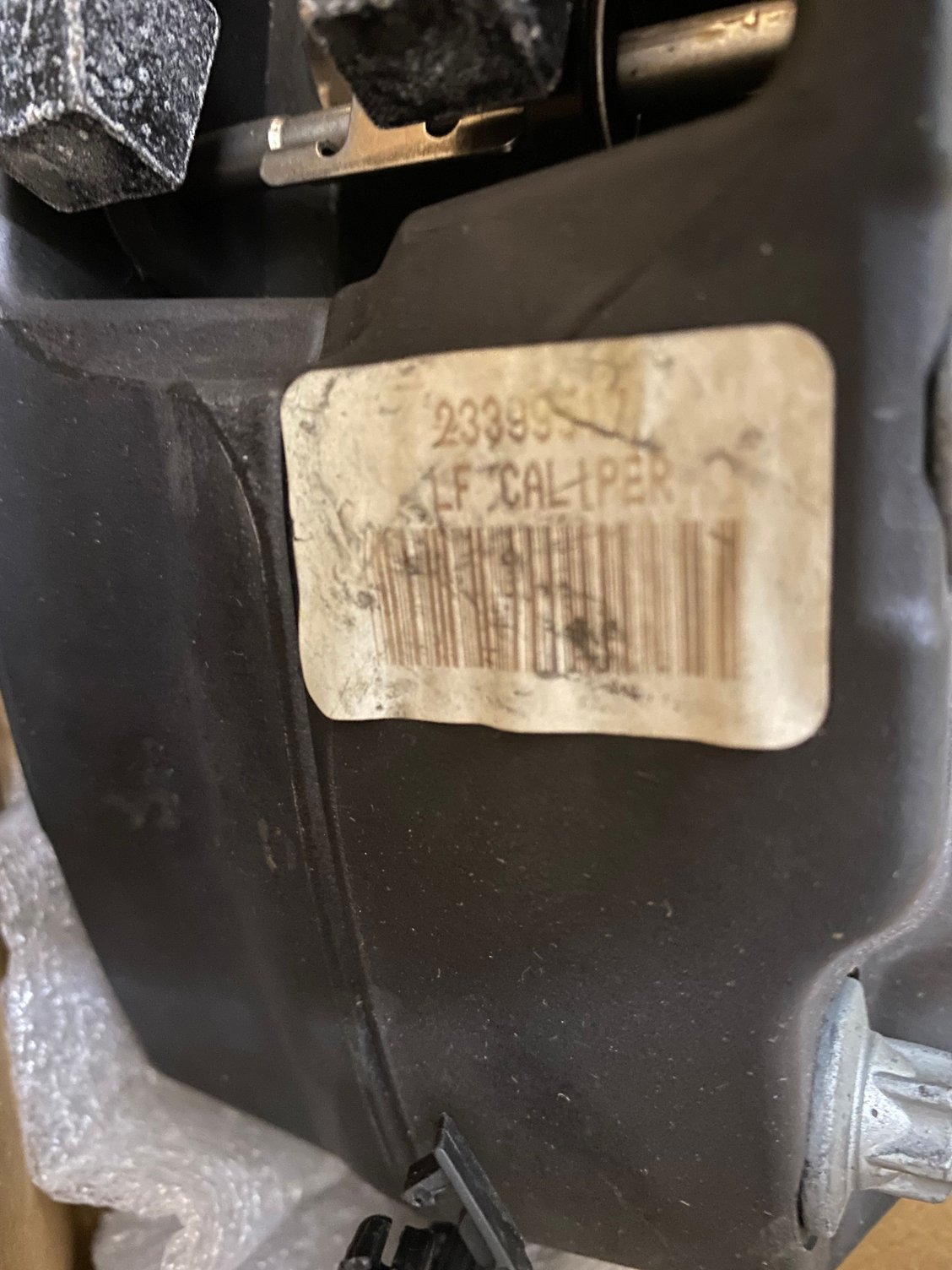

I have a 2002 gmc Sierra 1500 rcsb and have already upgraded to from to the 2007+ front brakes… however I have just aquired myself a set of Brembo 4piston camaro calipers P/N 23399515, I know there is companies that make mounts to put the 6P on these trucks, is there anything to mount the 4P?
