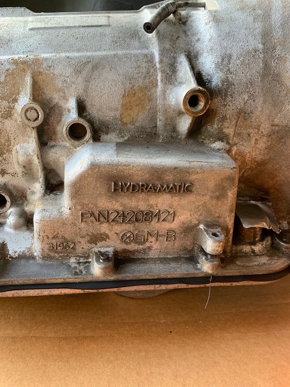

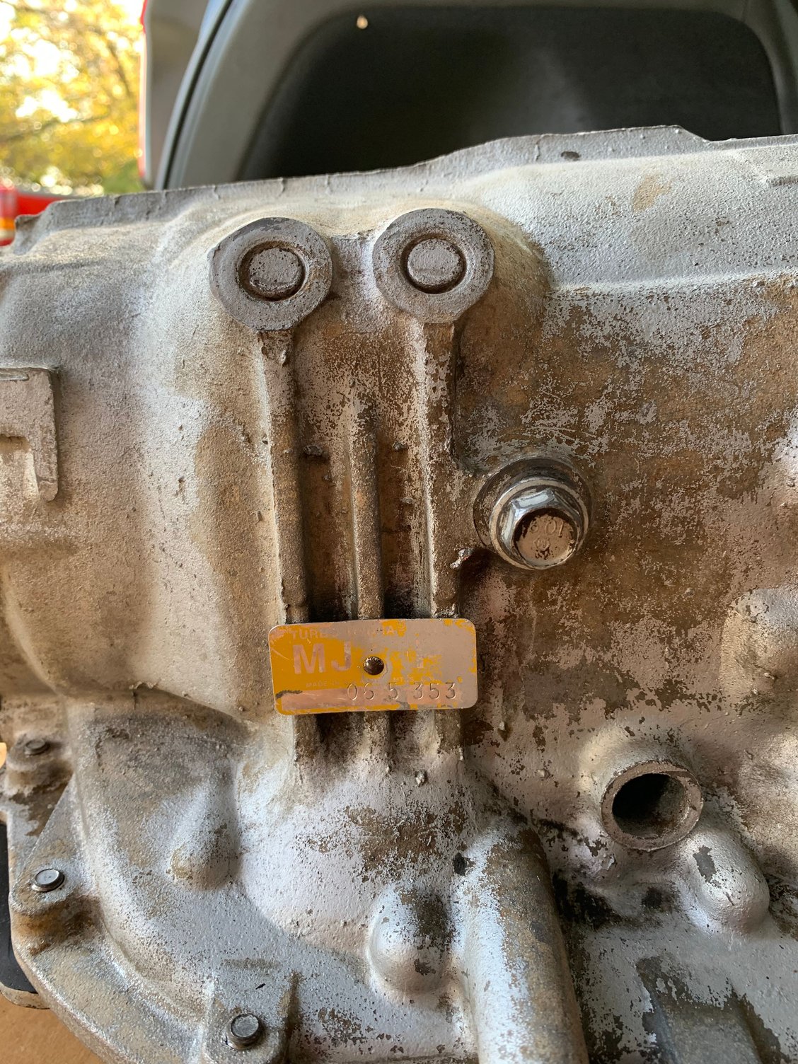

I took a road trip to San Antonio and got a transmission. I swear, I looked for weeks around the Austin area with no luck. adriver, I owe you a drink.The sticker is gone but the metal tag is still there. I’ll guess it’s a 2006. Not sure what the rest means. I plan on having someone freshen it up.
