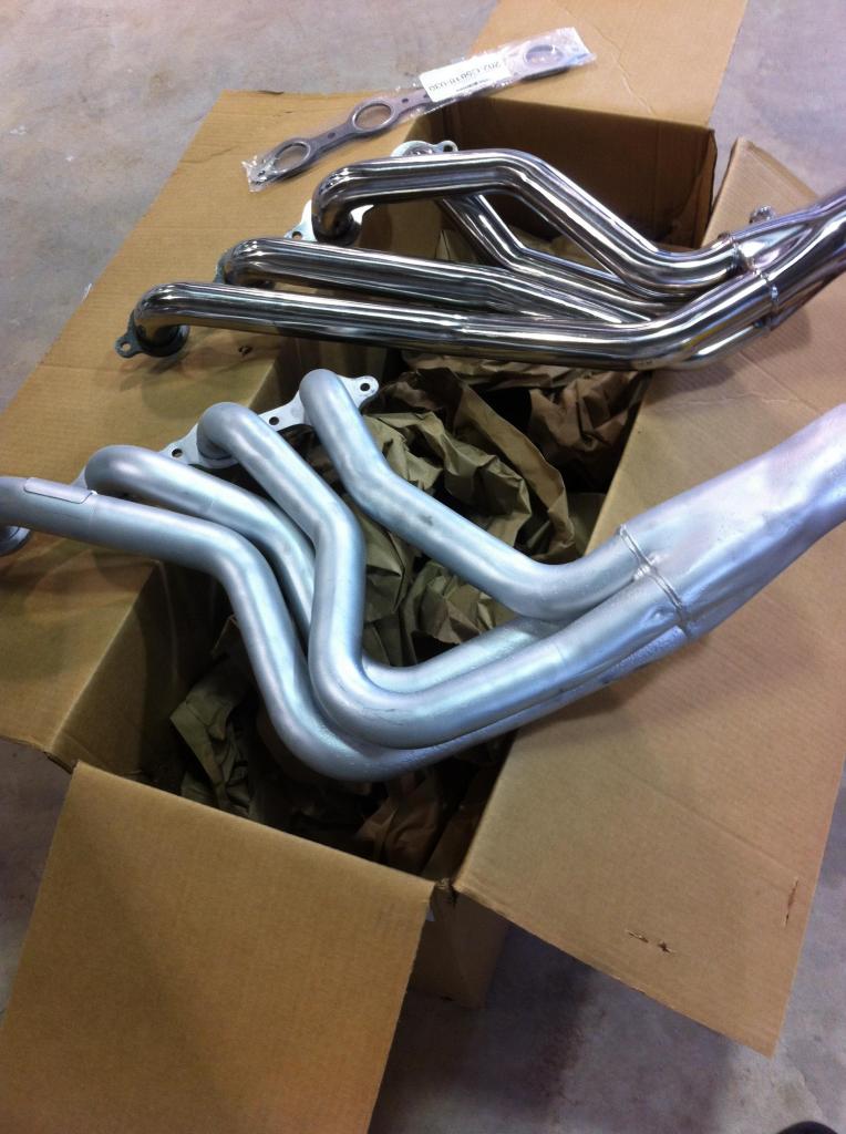

I got a set of pacesetters for 98-02 camaro ls1 off of Craig's list. Once I got them home I looked up the part number on them and that's what they were for. I tried to put them on my 2001 silverado and the drivers side wasn't even close. The hit the motor mount way before they were in place. I ended up getting tsp stainless ones.
Here is a comparison picture I took. You can see how they would interfere because it doesn't slope back like the tsp one does.
