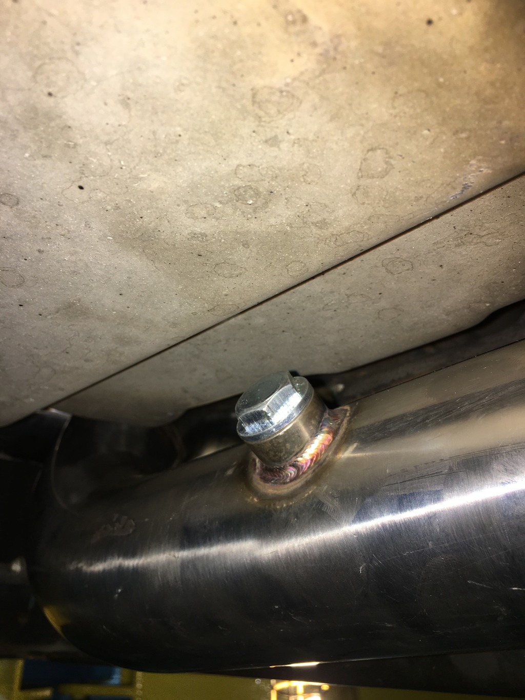

This setup is extremely loud like previously mentioned, but it sounds good, installed it on a denali this weekend.

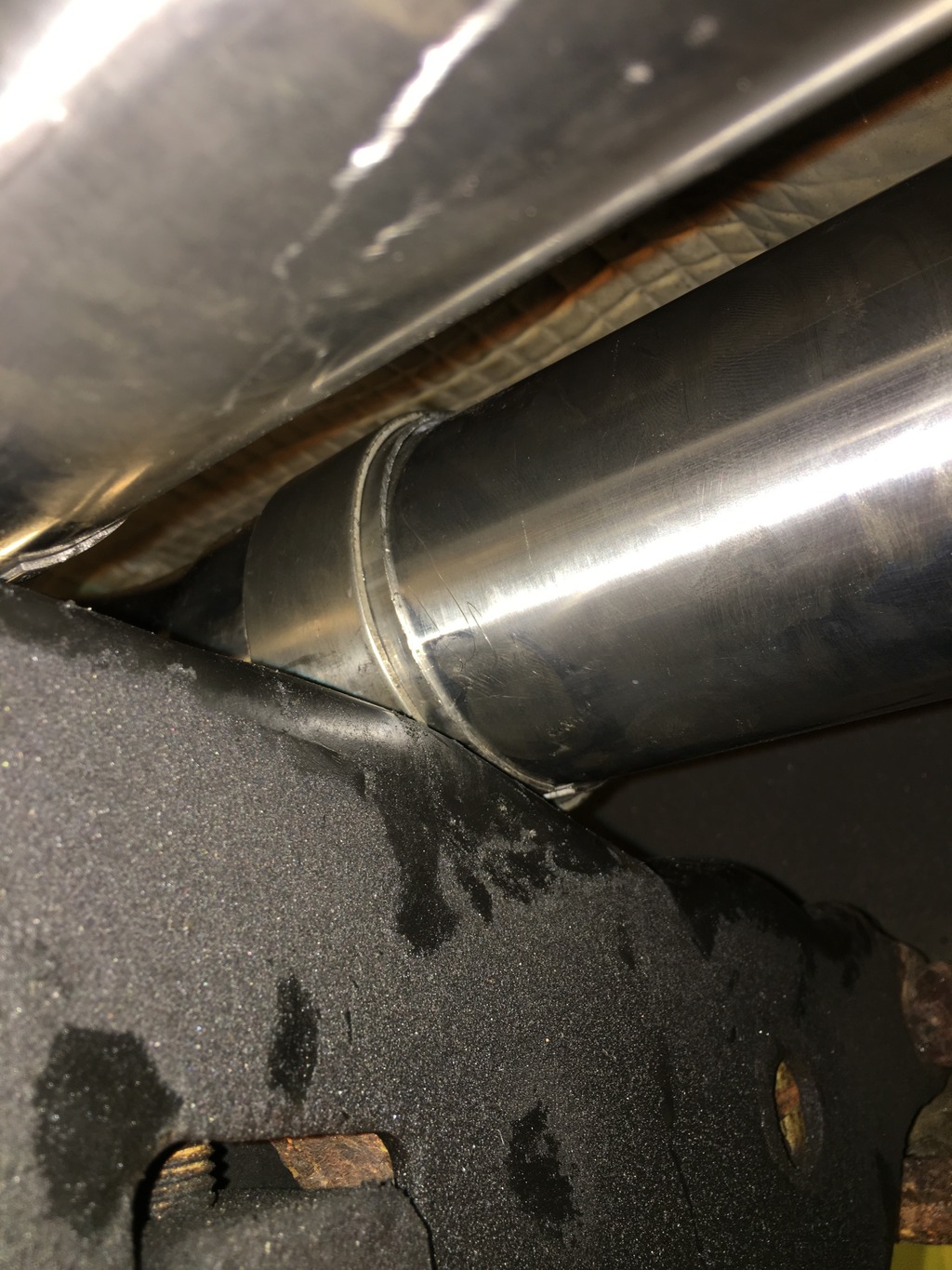

Fit was not as close to perfect as expected but this may be due to the quad cab configuration of the denali gmt800. The wideband bung in the y pipe points straight up at trans, there is literally no way for a sensor to fit - see pics below. Also the clamping location for the y-pipe to intermediate pipes was directly above a cross member making it difficult to tighten, also in picture. Lastly the first exhaust hanger lands directly level and next to the trucks frame hanger, rather than below it, thus it doesn't help support the system.
Also did 1-7/8 headers at the same time, which fit perfectly, besides the driver o2 sensor location which has been revised with the newest batch of headers.
This is the first gmt800 denali with this system that I know of so problems were expected.
I will say the welds were beautiful and the metal is of great quality. I will surely be putting a set of headers on my personal truck in the near future.
pic of wideband bung

clamps over crossmember

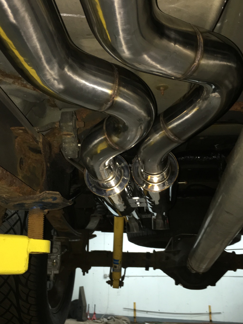

another note, the denali is missing the rear most crossmember that the ext cab trucks have, so the bends aren't required
