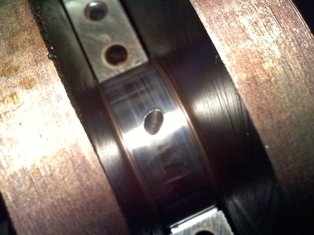

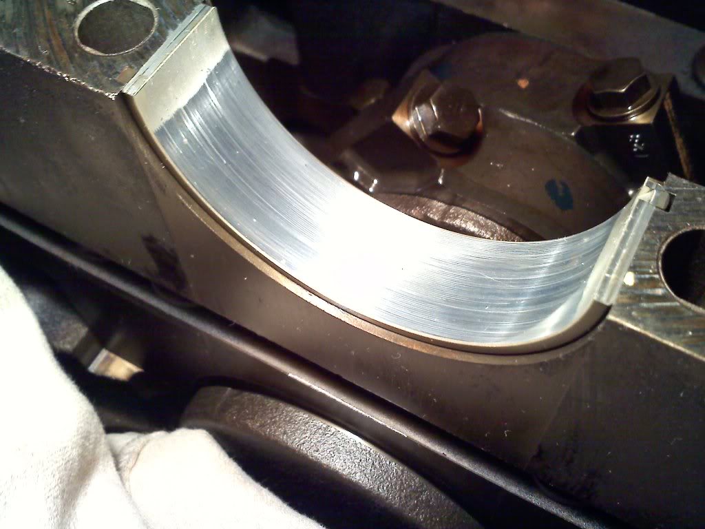

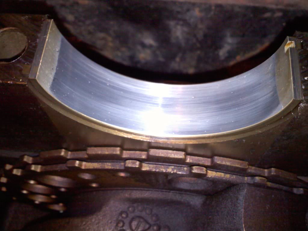

So i popped the all the main bearing caps except the rear cap and they all look exactly the same. You can see lines on them but they feel smooth to the touch and there is no discoloration in any way on any of them so as far as I can tell by visual inspection and to my knowledge they seem to look ok but I would like some input on if they do look normal.
So if they are fine I'm going to order the new side bolts, head bolts, etc after xmas and will be finally putting it all back together and waiting for a sunny weekend to throw it in the truck.
Heres a couple pics. let me know if anything looks odd that i'm not seeing. these aren't pics of every bearing but they all look exactly like these

Anyone think these look bad??
