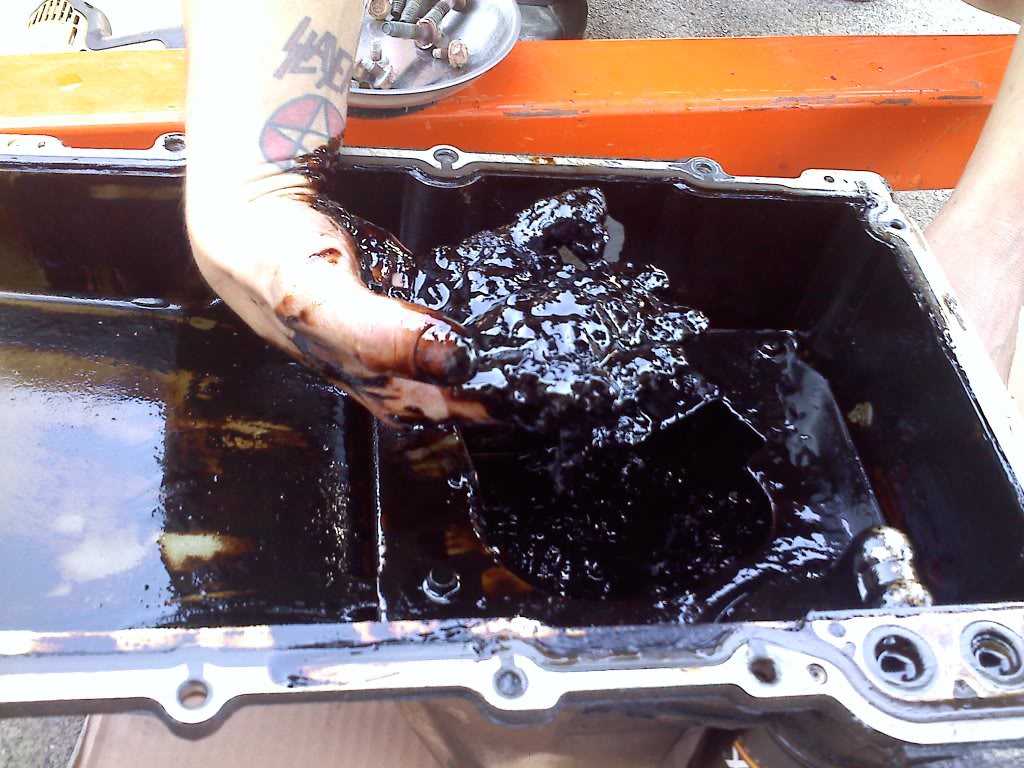

I still havent checked it out to see if it's the castec heads leaking coolant slowly into the oil that caused the sludge but after finding this inside my oil pan I decided to do a 6.0 swap like i've wanted to for a long time. This also explains the mystery why my truck has only taken a little over 5 quarts to get back to the full line on the dipstick these last 4-5 oil changes! My oil pan had OVER 1 quart of THICK sludge sitting in the bottom
Attachment 142708

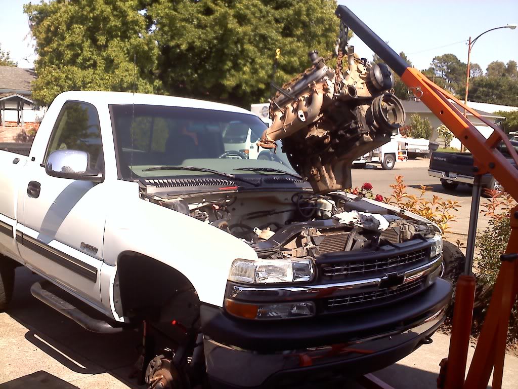

Pulled the 5.3
Attachment 142709

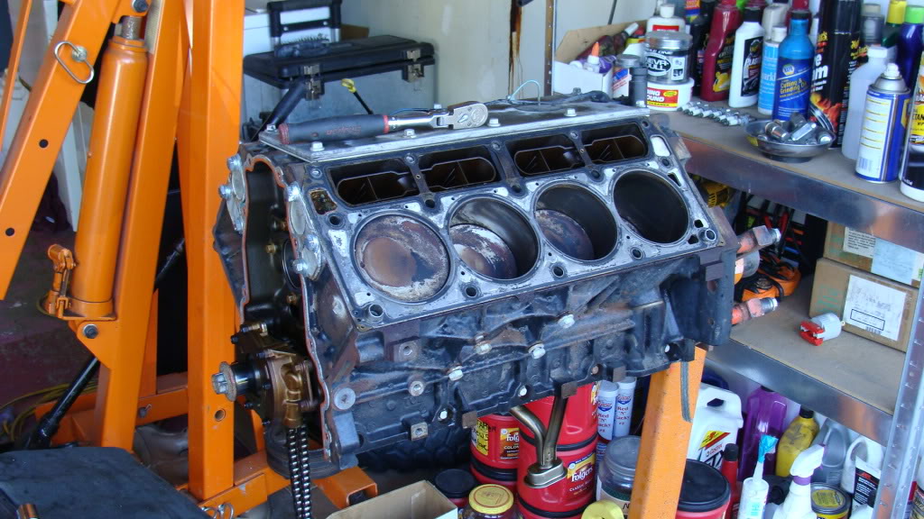

Tearing down the 6.0..
I Removed all the carbon from the pistons and checked the cylinders, all very smooth with no ridges or lines. The heads also had alot of carbon buildup on the valves so I decided to get them serviced while they are off.
Attachment 142710

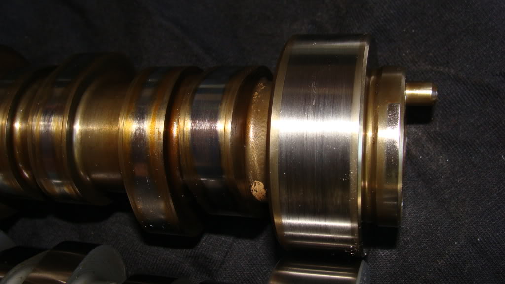

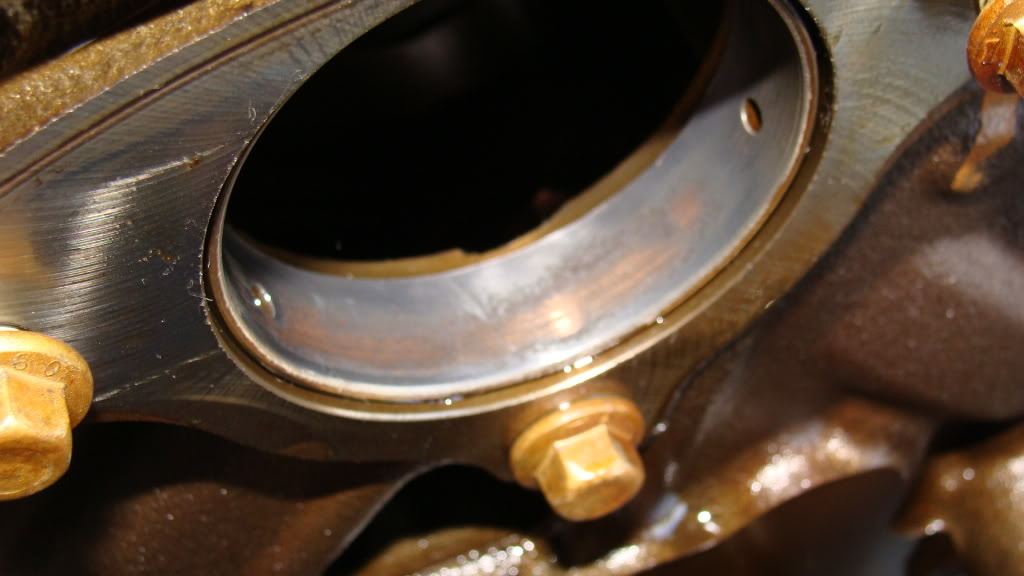

I Also pulled the cam and noticed that the front bearing right behind the timing chain looks kinda rough. It feels smooth but you can see a copper color showing. all the other cam bearings in the block looked fine and the surfaces on the cam look and feel fine so im not sure If I should mess with the cam bearings or not, Any input would be appretiated!
Attachment 142711

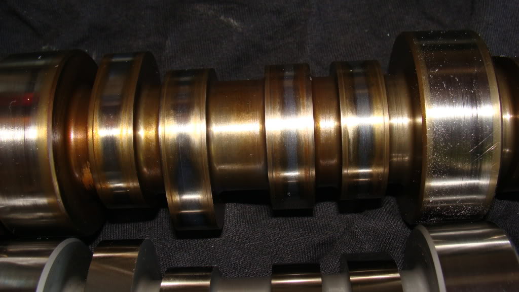

all the cam surfaces appeared the same and were very smooth, this is the end of the cam that was on the questionable bearing.

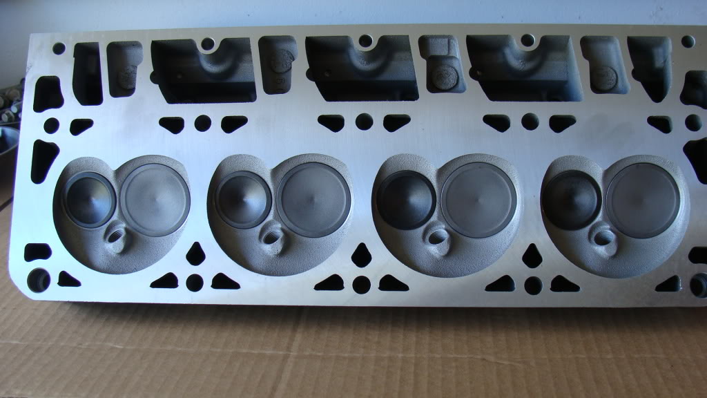

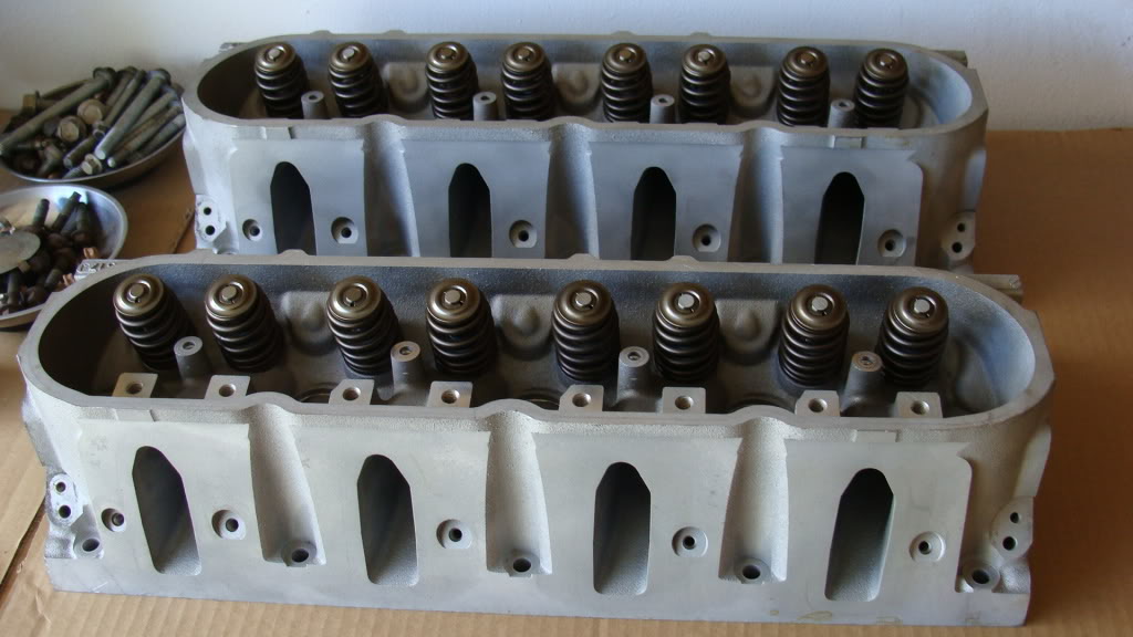

Got the heads back from the machine shop.
Hot tanked, 5 angle valve job, seals, resurfaced, PAC 1218 springs installed.
Looking clean!
Attachment 142714
Attachment 142715
blsnelling Nov 22, 2010 08:14 AM
From what I've read, that's entirely normla on the cam bearing, and not to be worried about.
brandon_6667 Nov 22, 2010 11:24 AM
Thats good to hear. I heard somewhere else too that its normal for that bearing to look worse than the rest on the bottom half because of the downward torque the timing chain puts on the front of the cam. It's good to hear others saying it too. Think I should check the crank bearings? i really dont want to have to replace more bolts and stuff but I feel like I should because I already have it disassembled this far.

budhayes3 Nov 23, 2010 09:08 PM
I've seen pics of many LS engines with copper showing on the first cam bearing, and that's exactly what both my current 5.3 and future LQ9 first cam bearing look like :nod:
