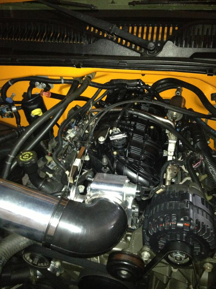

02_Orange_D1SC Jan 30, 2013 08:36 PM
1 Attachment(s)
run a 92MM mine fits perfect heres how i did my throttle cable bracket its the stock one just modified
Attachment 121541

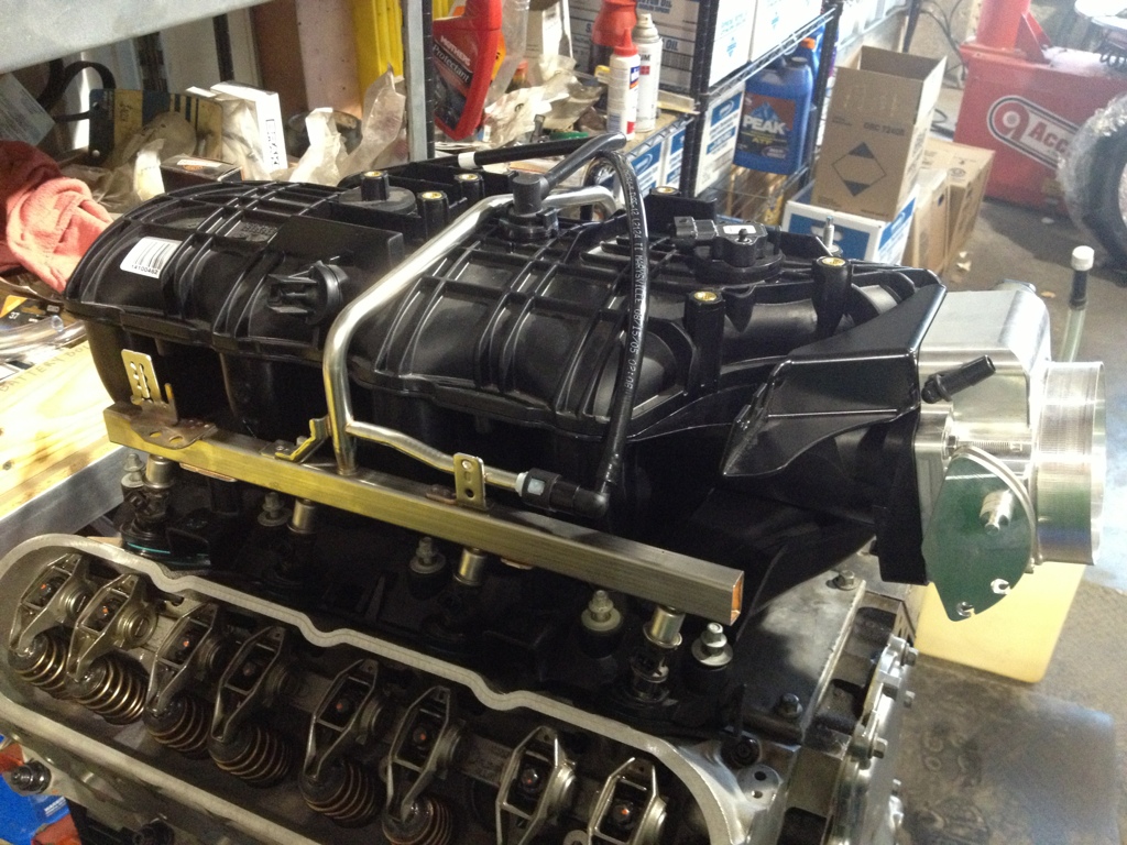

MPFD Jan 30, 2013 09:00 PM
1 Attachment(s)
Attachment 121539
This is the Nick Williams 92mm and bracket.
Ferocity02 Jan 30, 2013 09:09 PM
Thanks! looks nice. Have you had a chance to install it with the cables? Just curious if it works with the truck cables.
MPFD Jan 30, 2013 09:22 PM
The two hole do need to be slightly enlarged. I made it work so I could drive it that night but I need to drill the circle hole and grind the square one still slightly.
MPFD Jan 30, 2013 09:28 PM
I just saw your from California. I deleted my evap to make that bracket work. If you need it to pass emissions you'll wanna do something different. I cut the tube and plugged it to make that bracket fit my intake.
Ferocity02 Jan 30, 2013 09:49 PM
Yes I'm going to keep the EVAP. This link shows a picture of the bracket over the EVAP port, looks like a little grinding is all it will take.
https://www.performancetrucks.net/fo...6/#post4772422
