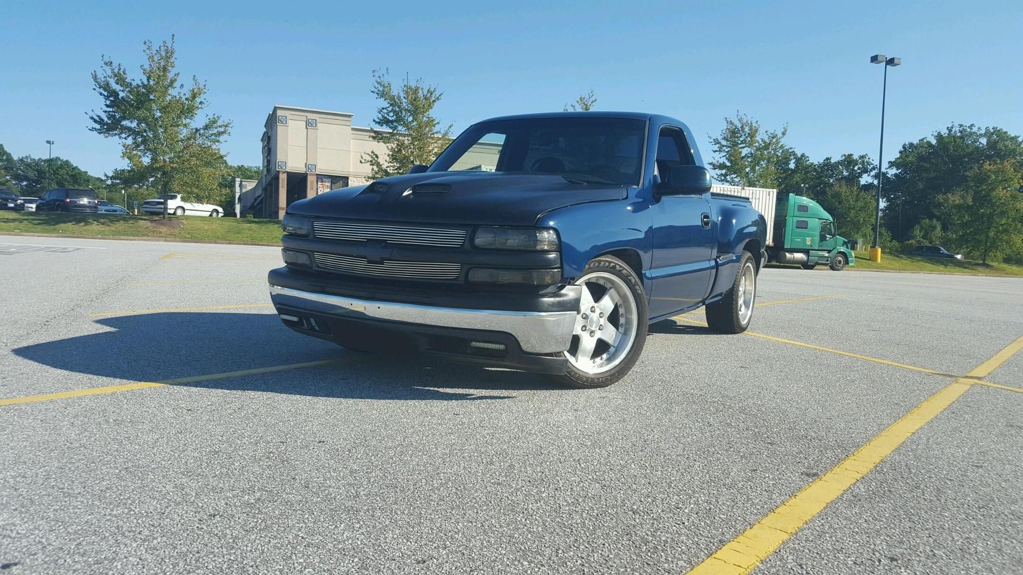

Okay guys I'm wanting to build my 5.3 I've already got all or most bolt ons, even have 4:10 gears in the rear and corvette servo in tranny. Was put running most things around the greenville SC area but now it's time to do internals and I personally do not know where to start, I've had thought on 6.0 stroker nitrous swapping it but I'm not sure I'd like to stick with my 5.3 and make around 550 whp when I'm finished. Any suggestions??
