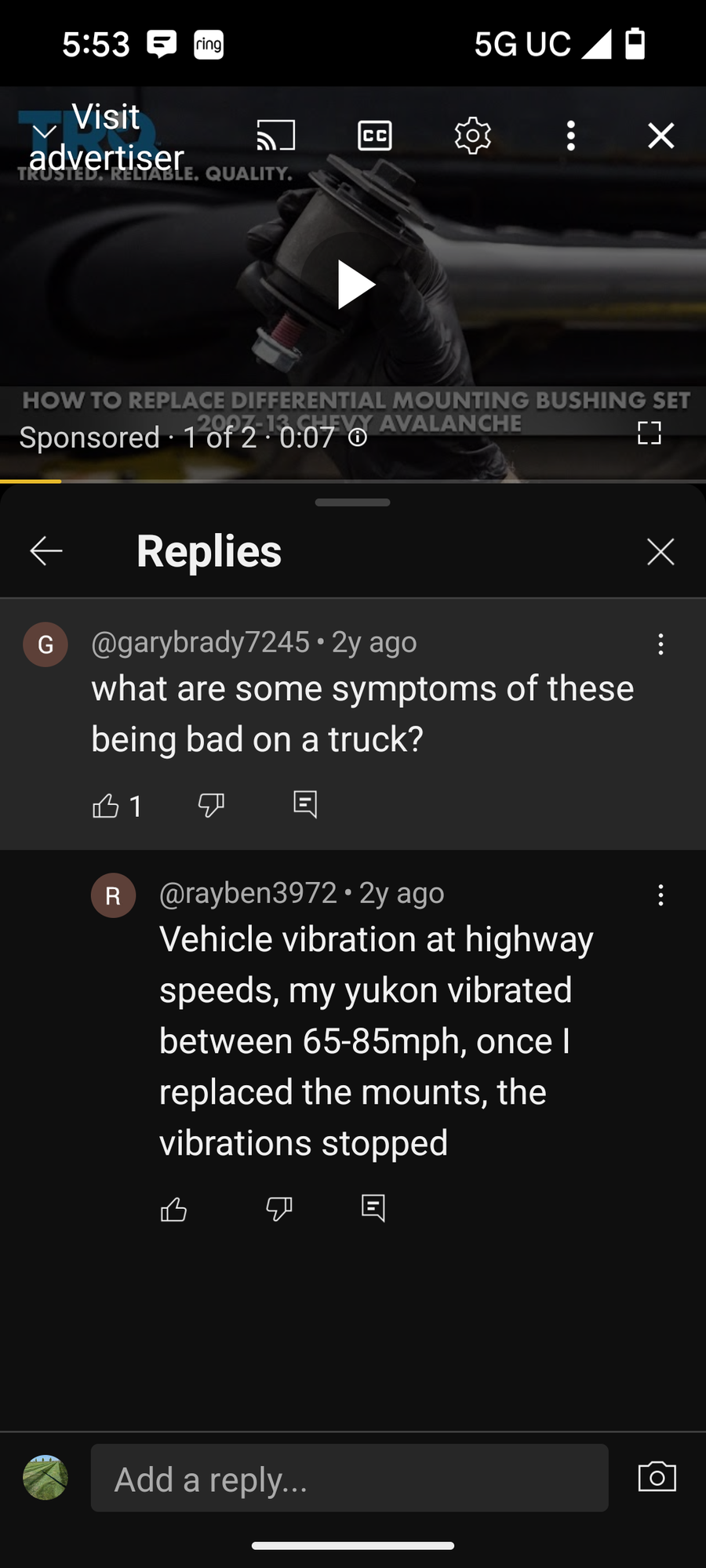

Ran out of time to do the differential carrier bushings. I strongly feel that is where the problem is at this point in time based on everything that has been replaced and it only getting slightly better each time. I also found this comment which makes me a lean towards it even more so.

Installed the bushings today. Passenger side was senior citizen ***** floppy, driver side would flex with a couple fingers.
Vibration is still there but not as intense. It seems to have shifted up in mph. PSI was higher today since set at 30psi at 40* and it was 80* on test run.
