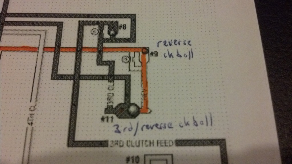

It says right on the front page: "Dual feed direct clutch: Triples 3rd gear holding power". I have been tearing through fluid diagrams for like 3 hours now and I don't see how the outer portion of the piston gets fluid when 3rd gear is applied. The OLD Transgo HD2 kit accomplishes this by removing the 3rd/reverse check ball and re-routing fluid in a custom circuit outside the valve body to maintain reverse gear. The new kit doesn't even mention the 3rd/reverse check ball, and since thats the circuit that supplies fluid to the outside portion of the direct piston I don't see how it is dual fed at all.

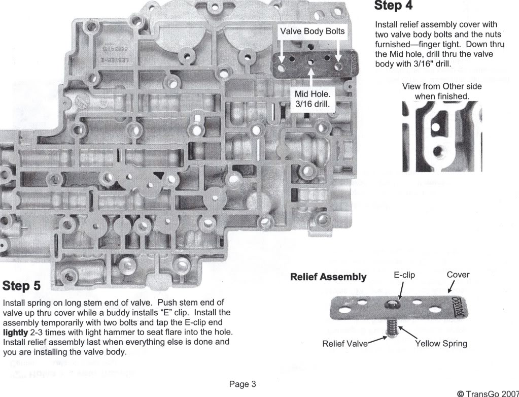

Attachment 130942
These are the instructions from the old style HD2 kit, specifically the part that says to remove the 3rd/reverse check ball. Both kits instruct you to remove the small check ball, but only the old one removes the big ball. In the lower part of the picture, you can see the additional plate Transgo provides to re-route the reverse circuit so you don't lose reverse by pulling the large check ball.
Attachment 130943
This is how fluid is routed on the fluid diagram... The reverse circuit in orange is not applied, so the larger outer portion of the piston does not receive any fluid at all in 3rd. In reverse the check ball moves and the fluid applies to the whole piston.
Are they full of shit or am I missing something here?? I don't want to put this thing in without dual feeding 3rd gear, especially not after hearing all the stories about burning the direct clutches under high load. Can any trans guys shed some light on this?

You should now have a stacked plate that is how they are redirecting the oil for the dual feed. The idea now is to use the entire piston surface instead of just part of it. Also IIRC you were also drilling four .125 holes in the valve body casting with the old kit. I have always taken it one step further with leaving the second ring off the center support and also the inner lip seal in the drum. In reality that is all you really need to do.
smokeshow Aug 26, 2012 12:41 PM
You took it a step further leaving off those drum and center support seals in the old kit or the new kit? I saw the oil path in the triple plate, but it looked like a pressure leak so i figured i was missing something. Does the 3rd/rev circuit connected to the reverse circuit not apply the low/reverse band? In the old kit they plug that hole in the separator plate to prevent that pressure leak...

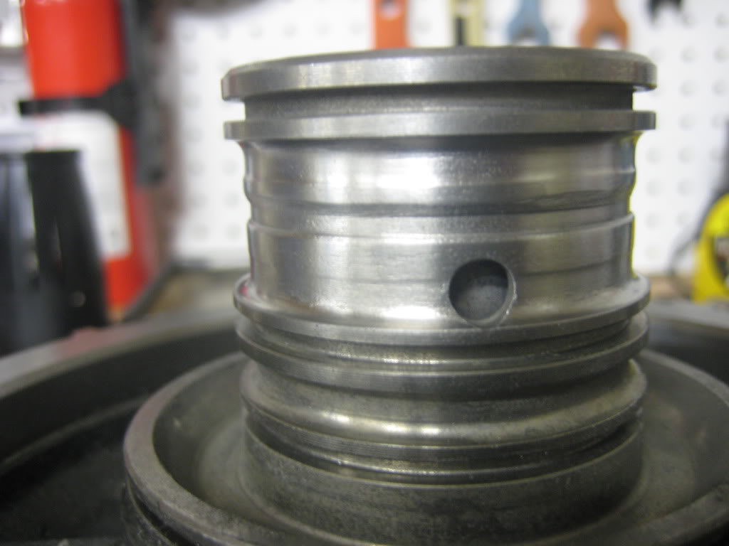

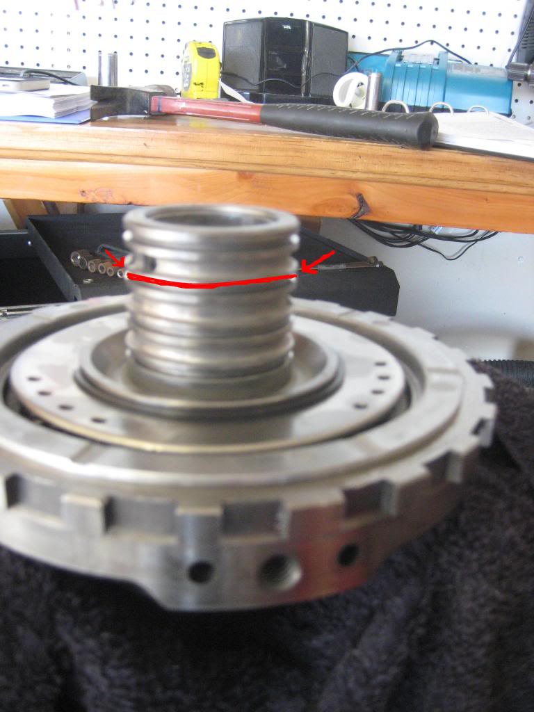

Leave off this gasket on the center support
Attachment 130916
I took it a step further and filed down the ridges where the gasket sat. Since this piece is stationary it does not have to be balanced....
Attachment 130917

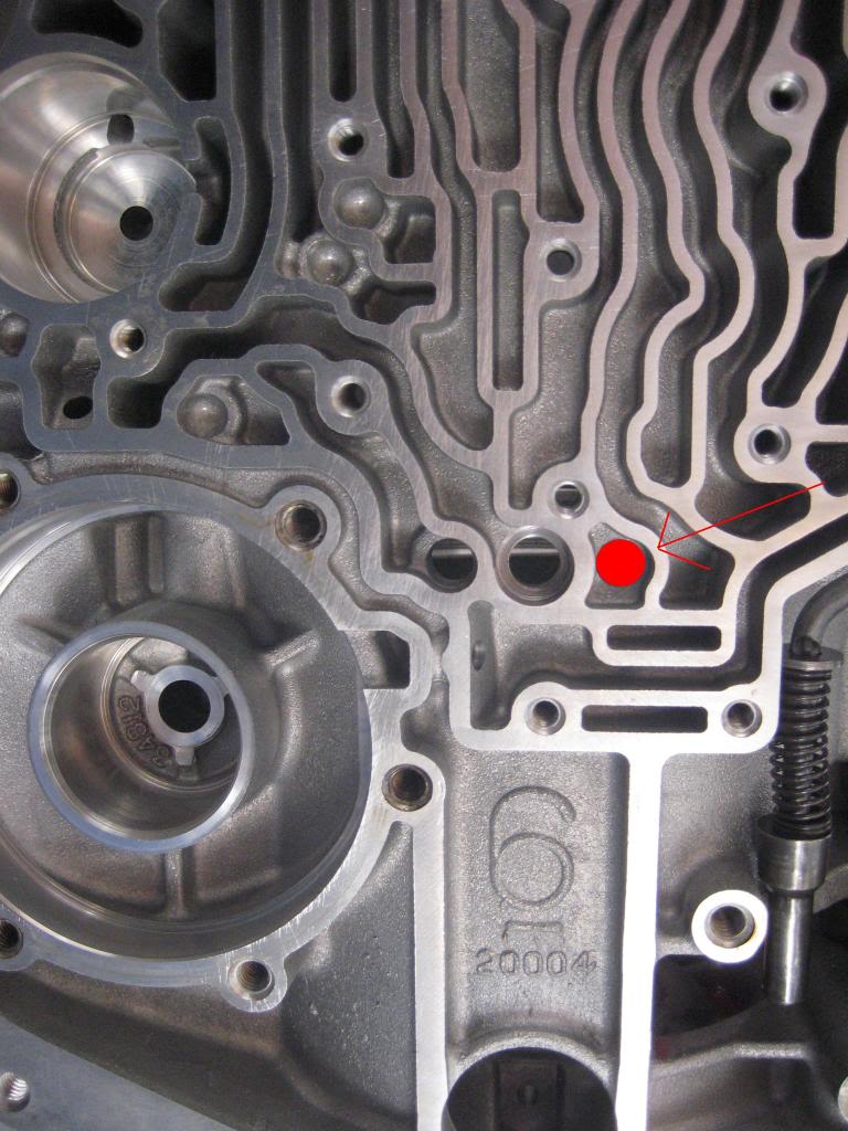

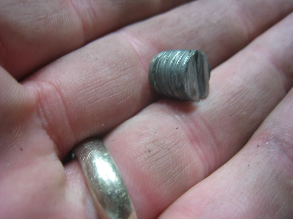

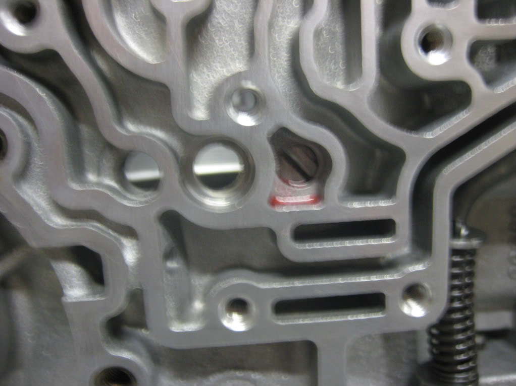

Then you fill in this hole, use red locite on it...
Attachment 130918
Attachment 130919
Attachment 130920

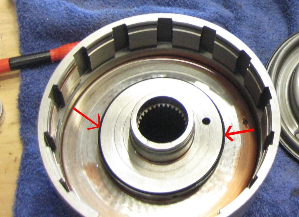

lastly remove this gaskets and your done...
Attachment 130921
So do those 3 things and your will dual feed the direct drum... Leave the Transgo spacer plate in the box... also don't do steps 4 and 5 in the instructions.
Attachment 130922
Instead buy a self-regulating Boost valve from Sonnax.
4L80E transmission boost valve kit Sonnax 34200-10K
Attachment 130923
smokeshow Aug 26, 2012 04:44 PM
Well fuck, I just did steps 4 and 5...
BlackGMC Aug 26, 2012 04:46 PM
Opps sorry! that self regulating boost valve does the same thing as steps 4 and 5...

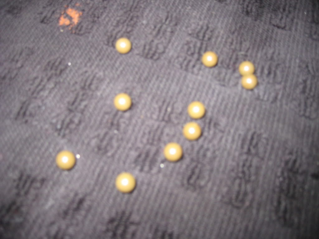

i reused my stock plate. Just make sure it is not dented from the balls... I went with Torlon Check balls
700R4 Check Ball Torlon for 700/700-r4/th700 transmission
Attachment 130912
