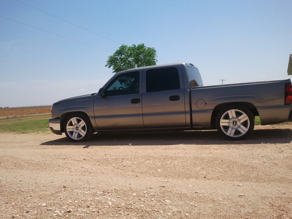

This is a pic of my truck lowered about 3/5" drop
