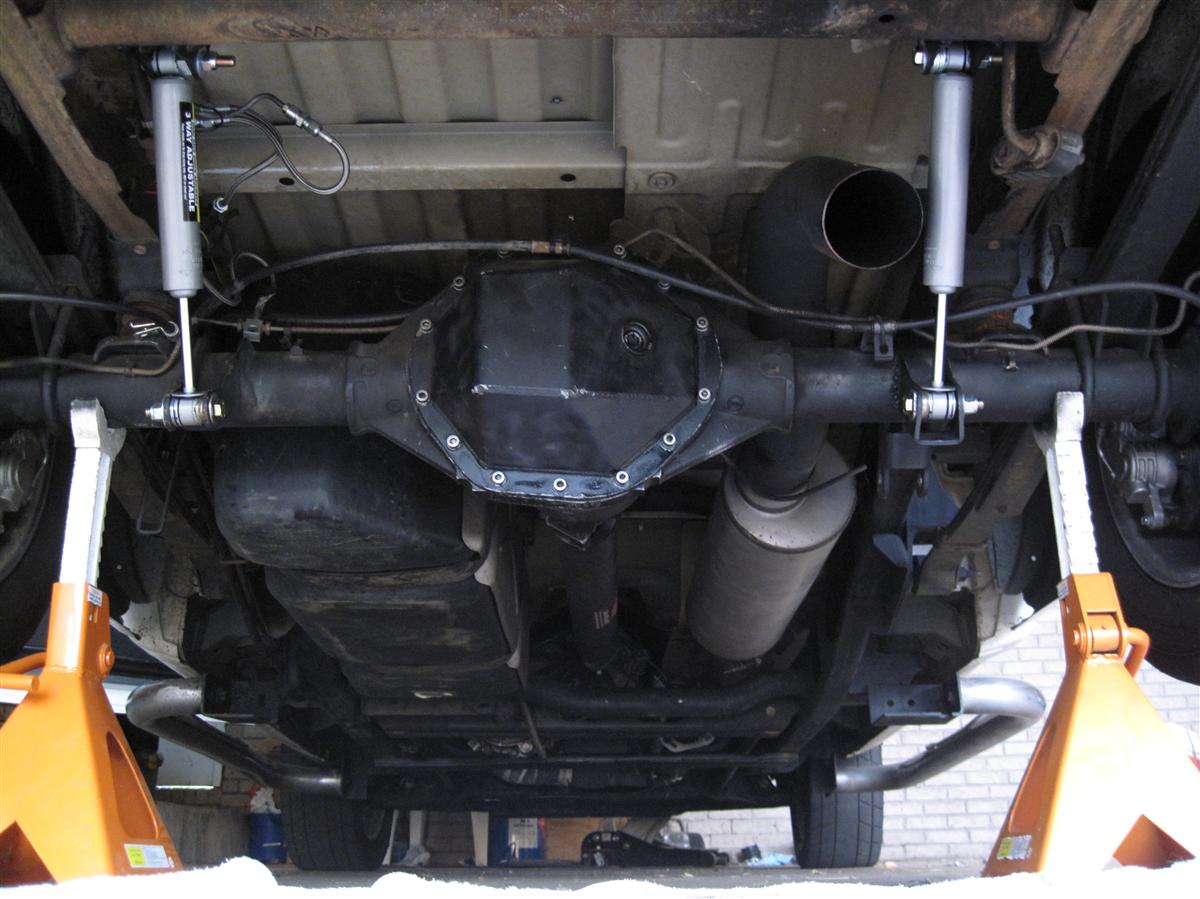

Not quite the same setup, but I just finished mine this week.
Attachment 135555
ltr450ryder Jun 9, 2012 11:02 AM
i was always told u wanted the shocks straight up and down?

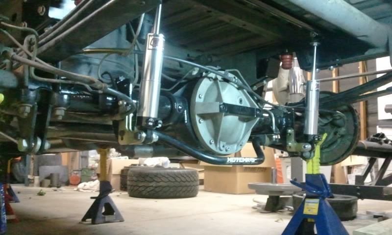

qa1 double adjustables , comp eng asjustable shock mounts and new upper mount made with dom
Attachment 135551
ltr450ryder Jun 9, 2012 11:18 AM
http://i23.photobucket.com/albums/b3...4-22204248.jpg
u have a part number for the shock mounts?
dam thats sexy under there
2004SSS Jun 9, 2012 11:25 AM
they only make one set.
WHPLSH Jun 9, 2012 12:46 PM
What are the length of those shocks? Thats the exact pic i was looking i just couldnt find it, haha. Thanks!
Also what drop do you have?
