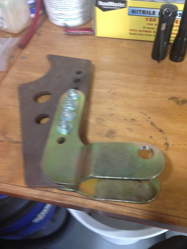

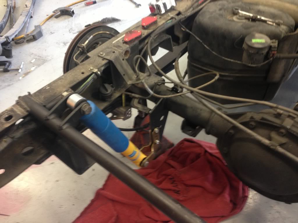

I broke those shock relocater brackets on mine. I use stock length bilstein HD shocks on mine but i welded on all new brackets. It rides like a dream.
The Belltech brackets do look flimsy. Any pics of them broken? I wonder if welding them on would work better?
No pics. But i had to weld it back together. Honestly they don't help that much with restoring the angle or length in my opinion.Originally Posted by Ferocity02
