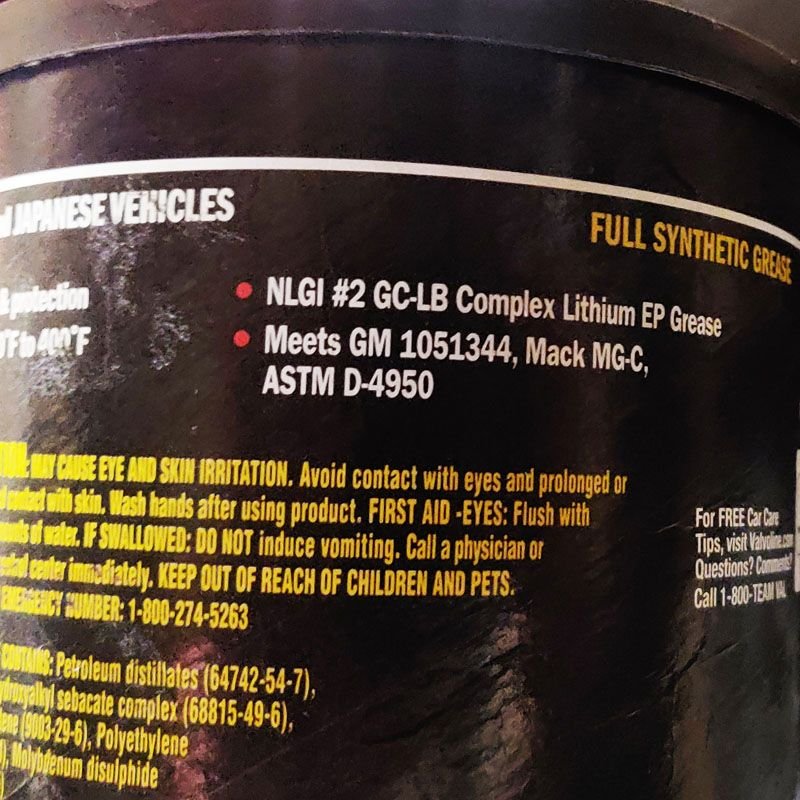

I used the extreme pressure (EP) rated grease shown below on the old Yoke 5 years ago and it helped for that long. I decided to go after it with the Nickle.
I put maybe a level teaspoon on the tip of my finger and apply it to just inside the opening and push it full travel a few times.
