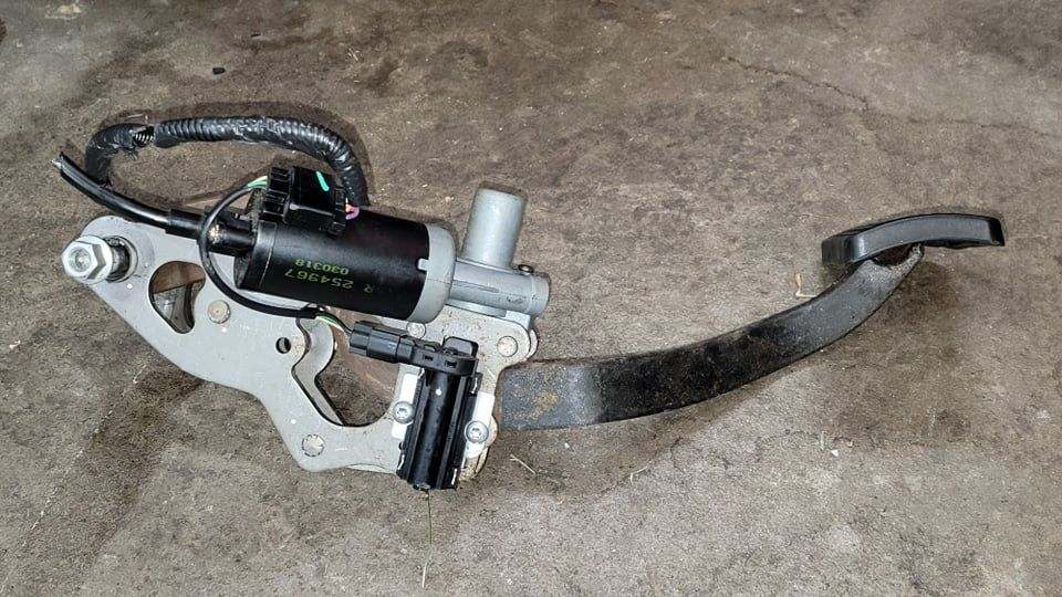

This afternoon I picked up a hydroboost with master cylinder and brake pedal from a 2003 Yukom Denali. It looks to have an auto brake setup on it. I'm thinking this brake pedal won't work and that the master cylinder will at least need a different reservoir.
This is on the master cylinder
This is my truck.
This is my truck.
This is my truck.

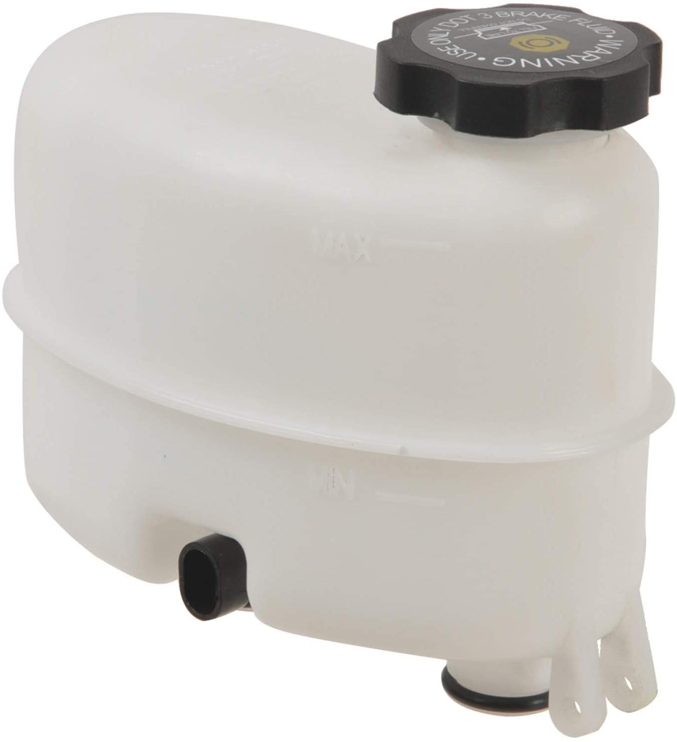

2001 Reservoir 2001 Reservoir
