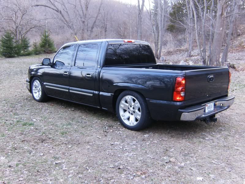

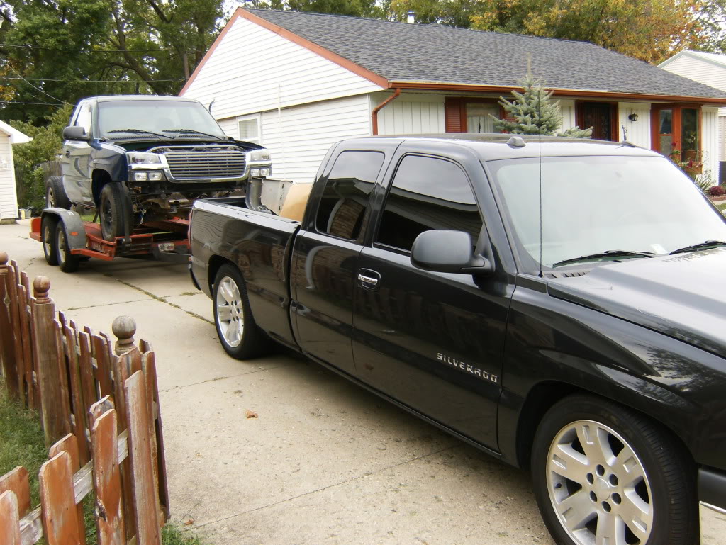

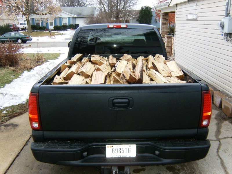

TRILOGYZ28 May 7, 2011 08:46 AM
3 Attachment(s)
my daily driver.
4/6 with helpers.
Attachment 143619
same thing i had on my xcab and i towed/hauled with it like crazy.
Attachment 143620
Attachment 143621

285 will rub. 275/45 will clear fine. I ran a 265/50 with my 2/4 and had no issues at all.
You are on the right track getting helper bags. Even with just the 2/4 anything in the bed will make it bottom out. Either way you go 2/4 or 4/6 towing capacity is pretty much the same only difference is the need for a c notch. I DD my truck and have towed many trailers/trucks 2/4 and 4/6 dropped.
