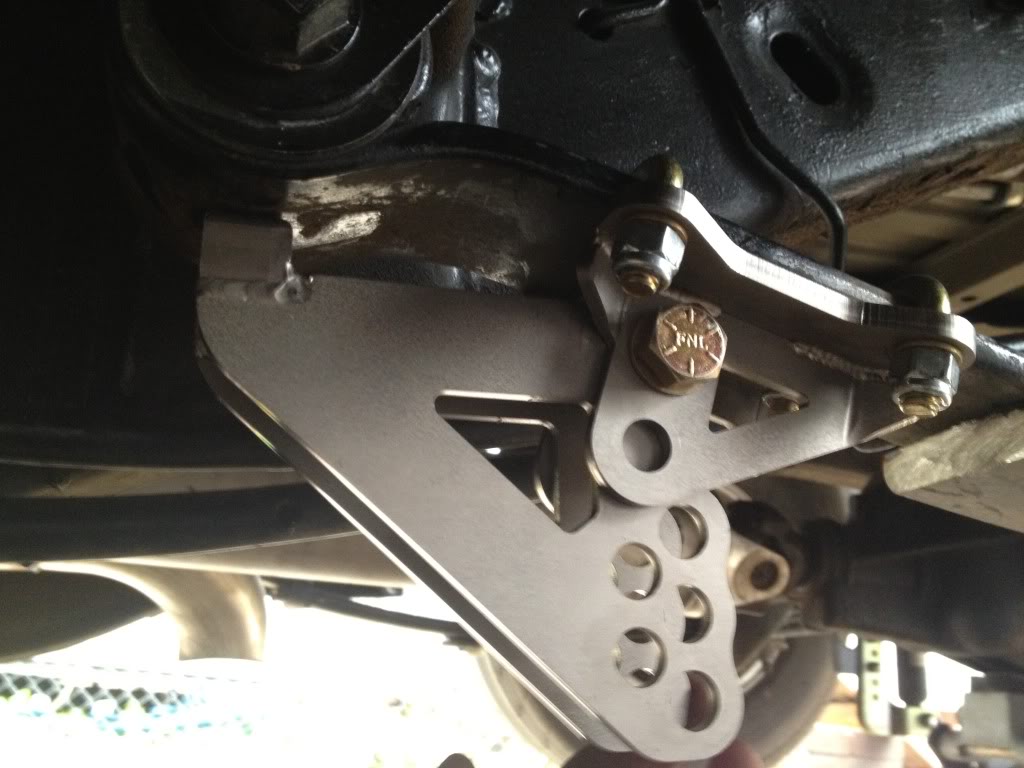

well sold the cal tracs and switched to the Smith Racecraft assassin bars...
this is on my 08' Silverado with flip kit....
not so much of a simple bolt on,had to cut the middle leaf and mill the u bolt plates but they worked and i thought id share for you gmt900 guys that might think about buying a set for yourself.

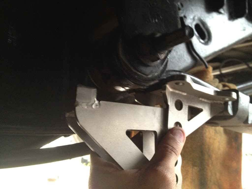

this right heres shows as you can see there is no room for the leaf u bolt plate kit to bolt up on since middle leaf is in the way

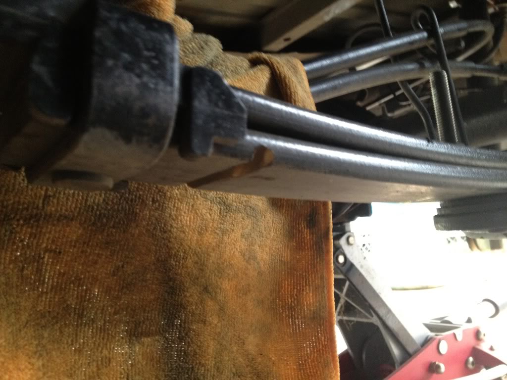

this is where it originally has to be
this is where i had to cut back on the leaf for more room.

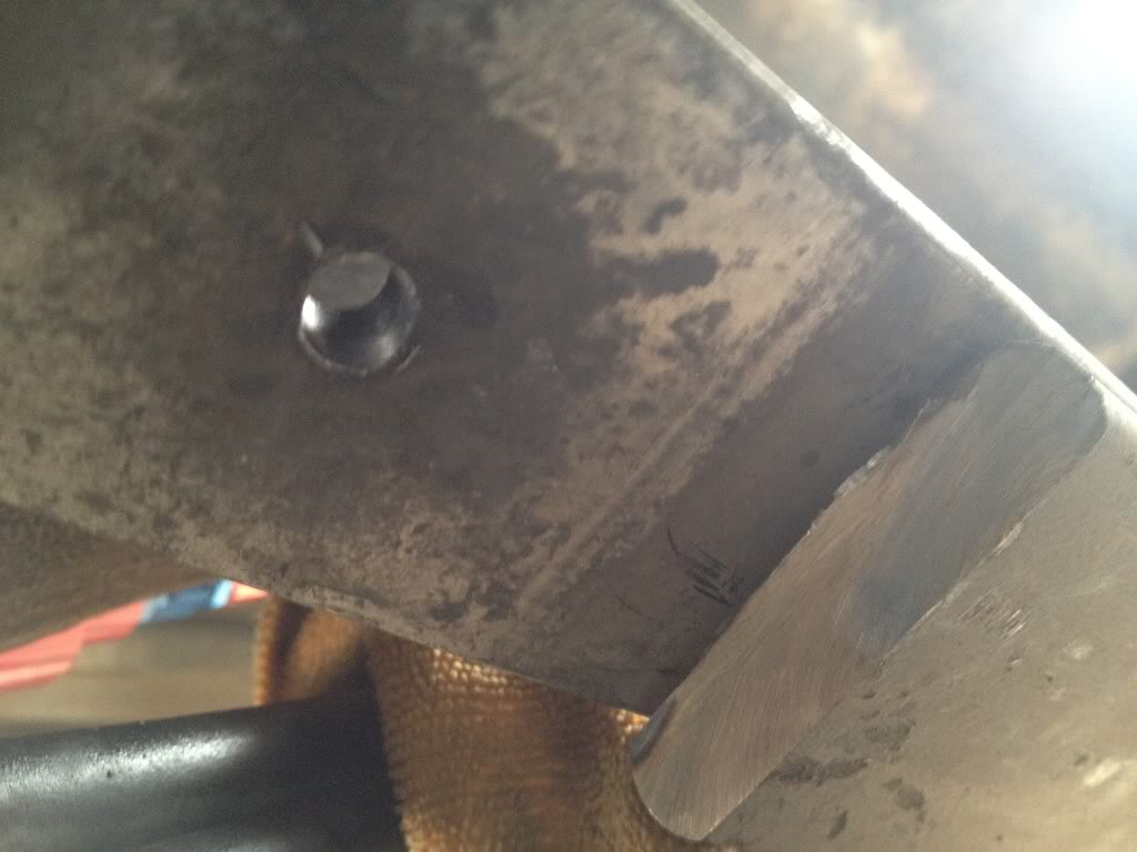

there it is cut back and hole drilled for bracket
snugged up,now its perfect!

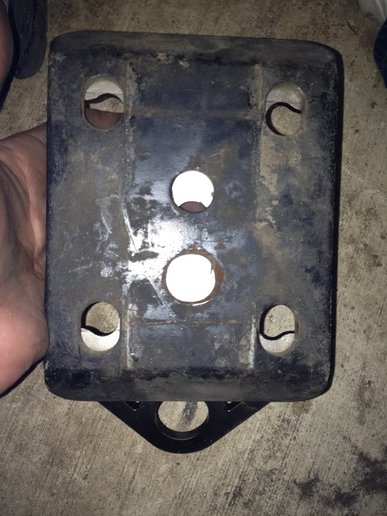

tried to bolt up u bolt plate and did not work out right,here u can see where it needs to be milled open more.the center hole for leaf spring nut is way off.

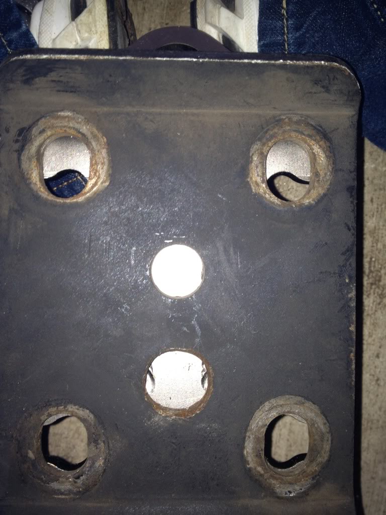

well not what i expected ..spent 60 bucks at machine shop to mill the plates....but at the end they worked lol

Yes they helped my truck take off hard i can feel it lunge like squat forward also took care of wheel hop
