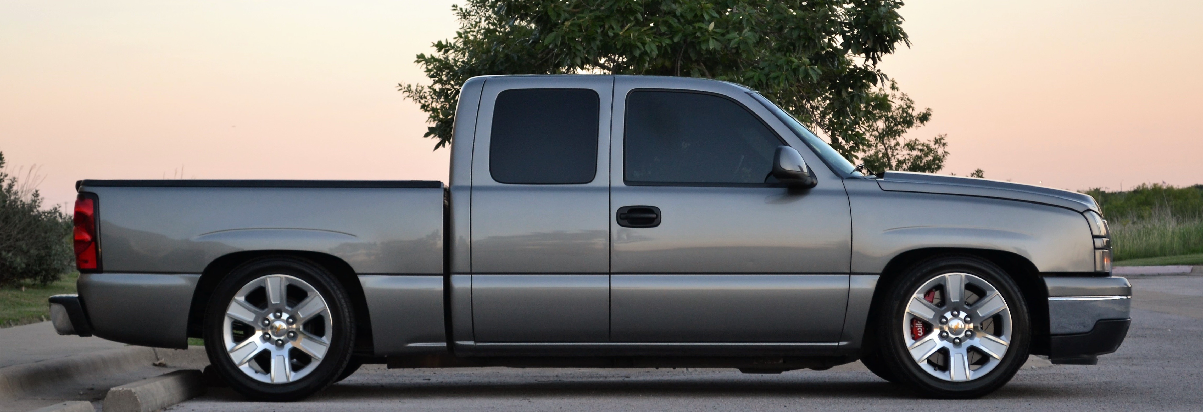

4/6 with 275/45/20

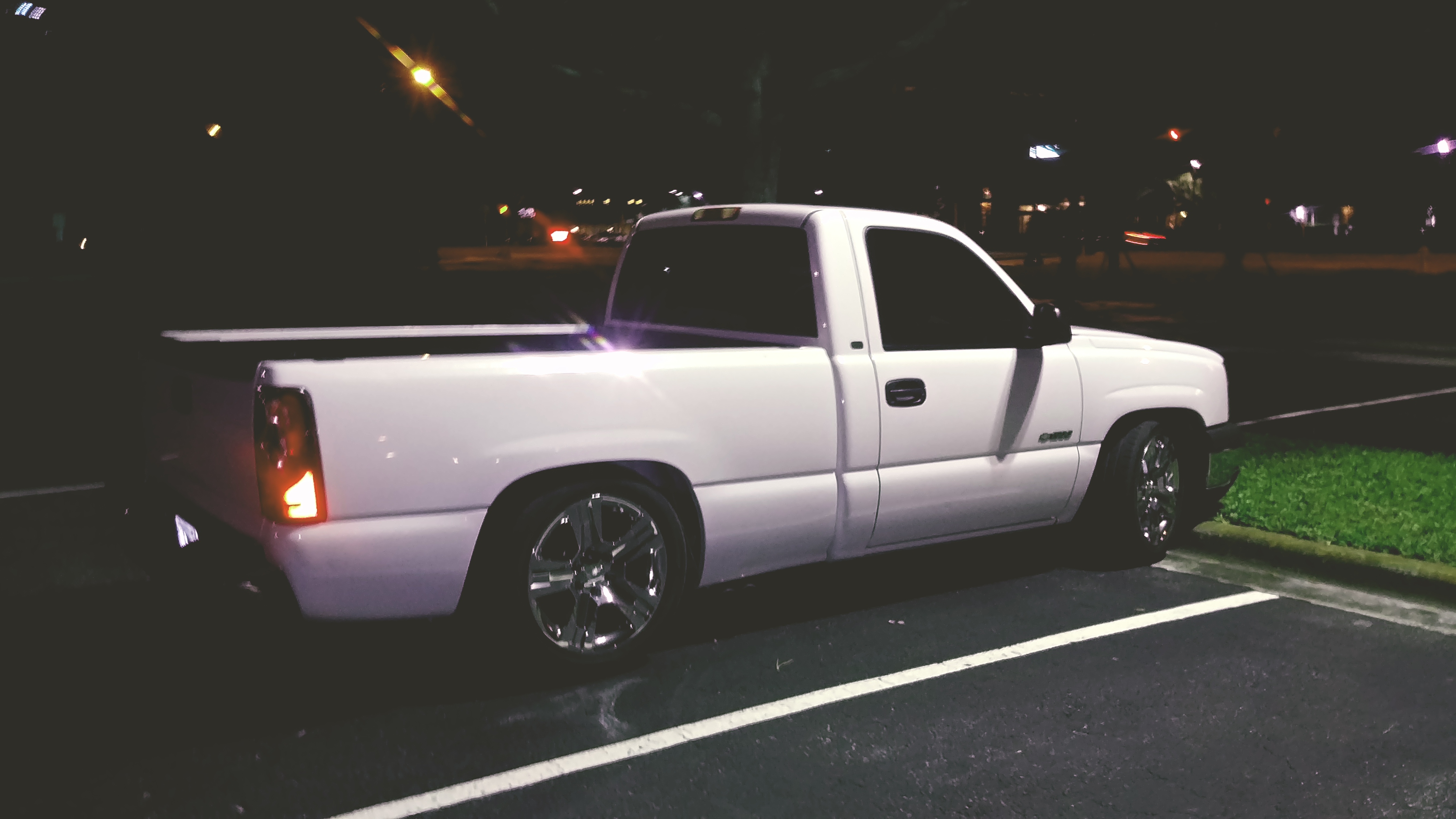

I don't know the drop, but my 03 on 20s with 45s.

4/6 with 275/45/20
Did you have to install the carrier bearing relocation kit?

No carrier bearing on that truck, it was a one piece DS from the factory

4/6 with 275/45/20
is this the same drop as your red truck?
That gray truck was 15.5" hub to fender in front. Red truck should be 15.0" hub to fender. Gray truck was 2wd but with torsion bars, red truck is traditional coil spring 2wd. So completely different setups so to speak, but roughly the same ride height - if that makes any sense lol
