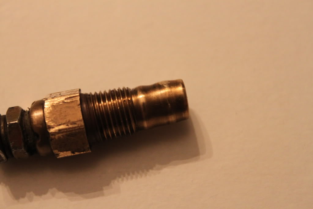

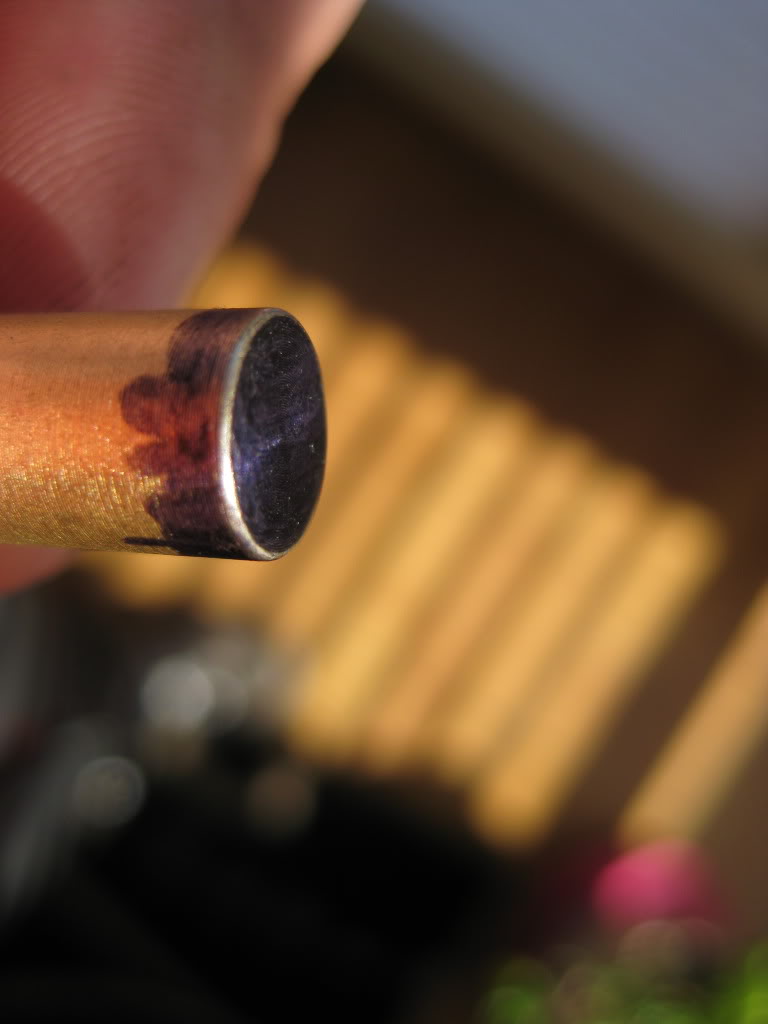

I'm not sure on the 80, but I used the pressure test port on the 60 and had a problem with the sending unit...
After seeing this on Ls1tech, I was concerned:
Attachment 113220
some over there have used a shorter sending unit
#2259
Attachment 113221
Just to check, I measured the depth of the port with an allen wrench. it was close...
so I colored the end of my sending unit with magic marker and slowly snugged it up.
it wore the magic marker off the sending unit, so I picked up the shorter one.
Attachment 113222
