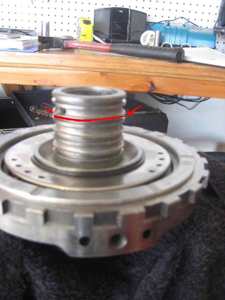

BlackGMC Feb 6, 2015 01:47 PM
3 Attachment(s)
Originally Posted by 03sierraslt (Post 5272428)
I don't recal any special gaskets, plug a hole, leave out a couple seals. I forget exactly, it's been awhile.
Yep that is how you dual feed it.
Attachment 94874
Attachment 94875
Attachment 94876
BlackGMC Feb 6, 2015 01:50 PM
1 Attachment(s)
Small modication i made was smothing out where that gasket goes to help with flow
Attachment 94873
DRAENOR Feb 6, 2015 01:54 PM
^ Thats a great idea there. I'll have to try that mod.
03sierraslt Feb 6, 2015 02:14 PM
2 Attachment(s)
Ya, mine is ground smooth also.
Attachment 94871
Plug
Attachment 94872
1969x11 Feb 6, 2015 06:58 PM
Is there a way to dual feed the directs without plugging that feed hole in the case? I was told by a local builder that the plug wasn't necessary...it told him it would cause a leak and he laughed at me. Trans lasted about 2 weeks and burnt the directs and intermediates.
jakeshoe Feb 6, 2015 10:17 PM
http://i27.photobucket.com/albums/c1...d/4L80-091.jpg
How is that going to help with flow?
Why do you think that's a restriction? Where else in the circuit might there be a restriction? What does cutting that down do to circuit volume?
I know some builders like to do that mod. I avoid it but I'm posting to stir up the technical thinking and stop the monkey see/monkey do reason for mods.
