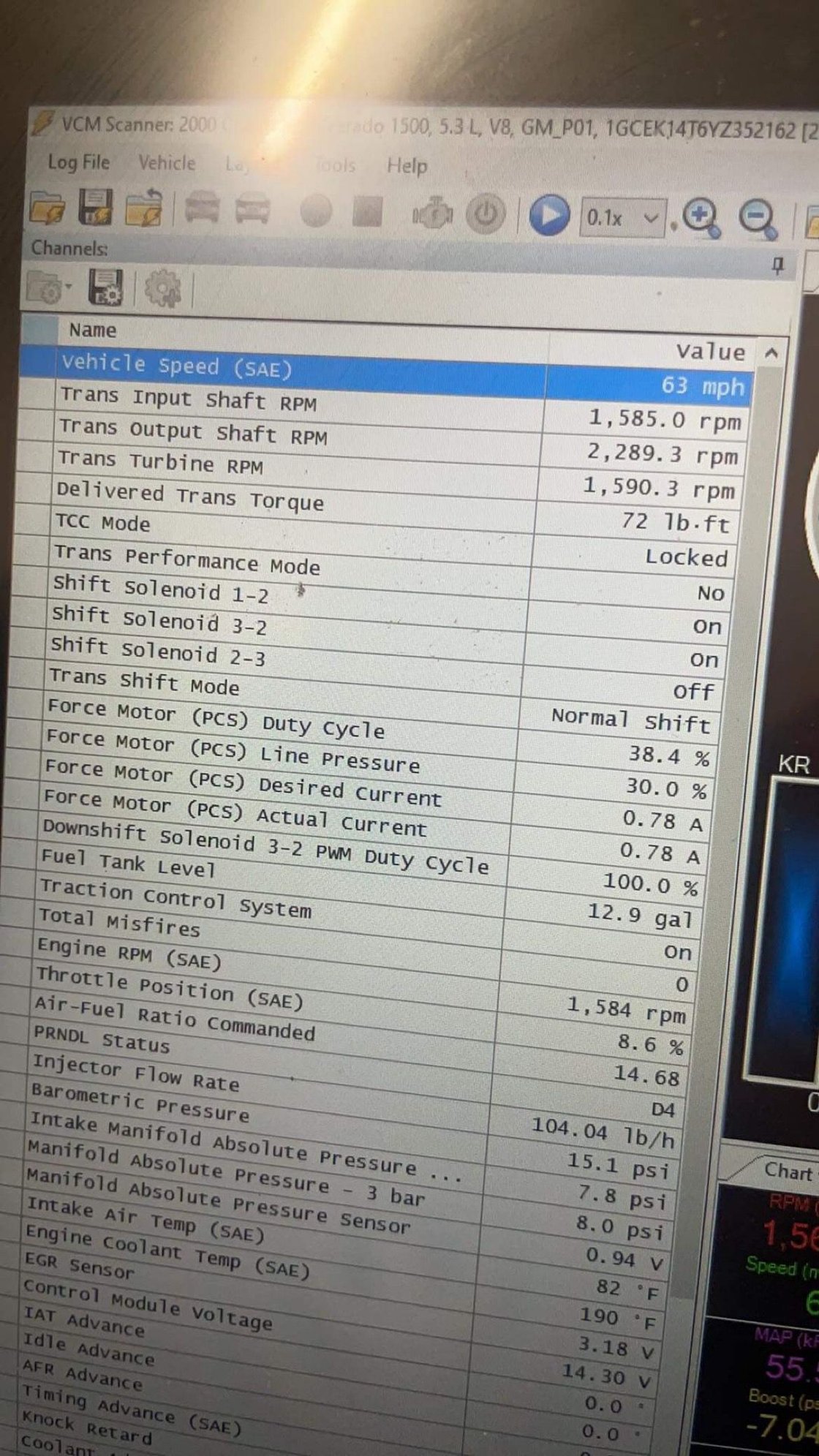

Confirmed shifting 1-3 is good I cleaned the plugs out with electrical cleaner and now trans turbine speed/ input shaft rpm is working now weird because my truck is a 2000 Silverado 4x4 I thought it wasn’t till later years iss was used still no 4th can command it still
Old Sep 20, 2021 | 08:16 AM
vergesilverado's Avatar
Joined: Mar 2021
Posts: 87
This is in commanded 4th gear

4th gear will have the A solenoid (aka 1-2) ON and the B solenoid (aka 2-3) OFF
Just as your image shows
You're logging a bunch of channels that do not need to be recorded
Get rid of all the 3-2 channels. That solenoid has absolutely nothing to do with anything other than the 3-2 shift FEEL. It won't alter when it happens or if it is commanded, it just changes weather it feels firm or soft.
Logging all the force motor stuff isn't doing you any good either unless you know what you're looking at. If you want to log it, just log the actual amperage and ignore the rest.
I'd ADD the "commanded gear" channel...just makes it easy at a glance to look and see which gear is being commanded without having to look at both shift solenoids to know which gear.
ISS was introduced as early as 06 in some vehicles. Many of them by 07.
plain and simple...if you can command it with the scanner and it will shift and be OK...your issue isn't in the trans...it is in the control system for the trans.
